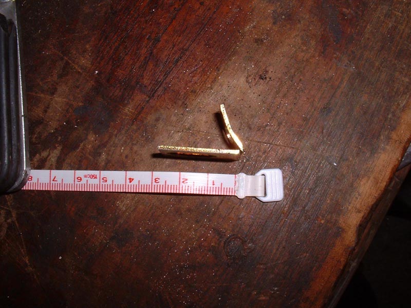

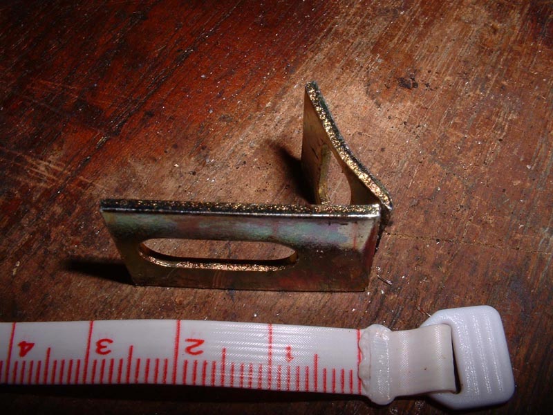

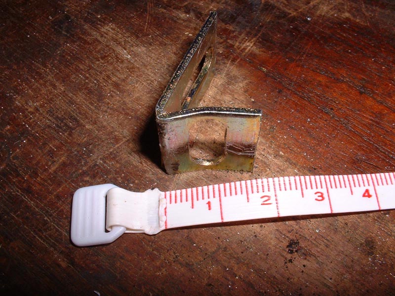

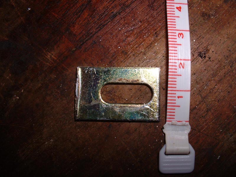

I could take a piccy of a bracket, with ruler as scale, later on
basically its a small metal, L-shaped piece (well, more a tick shape), with hole on small part of "L" and elongate part of "L",
I broke one, when trying to figure out how it fitted, so need to make one myself!
