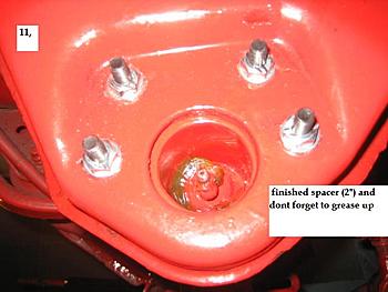

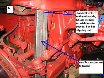

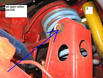

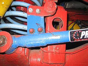

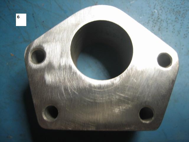

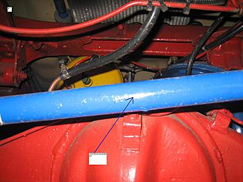

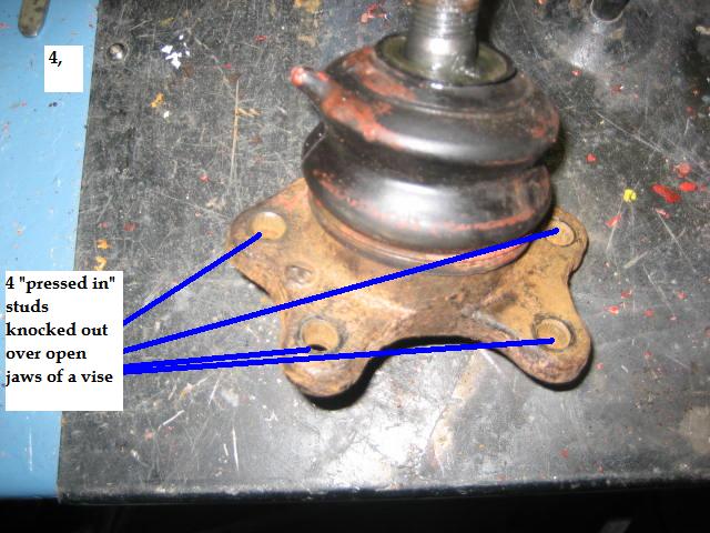

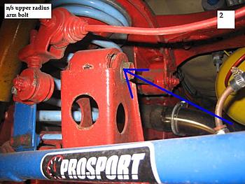

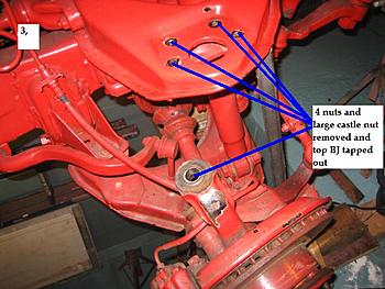

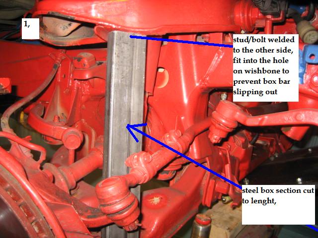

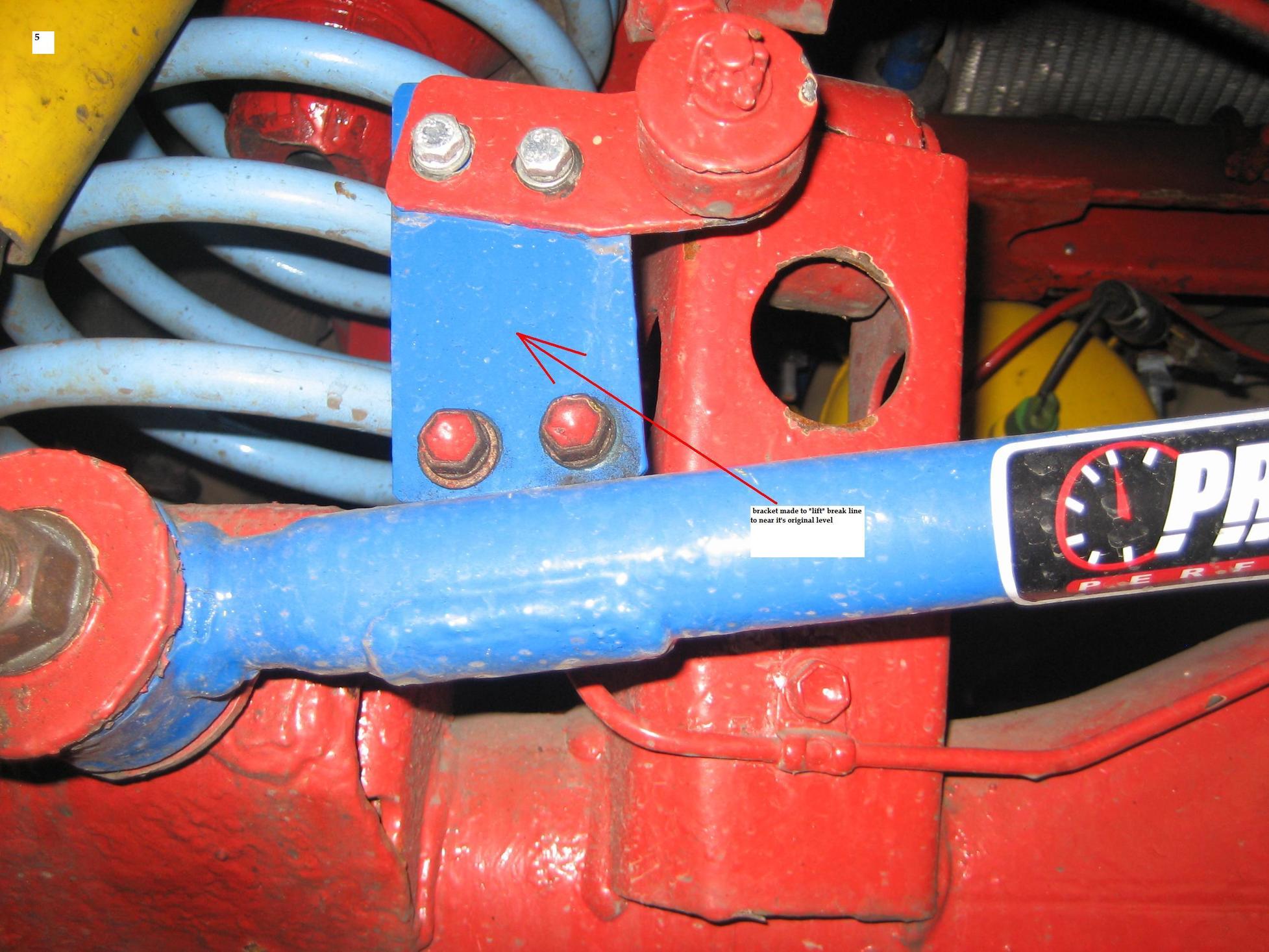

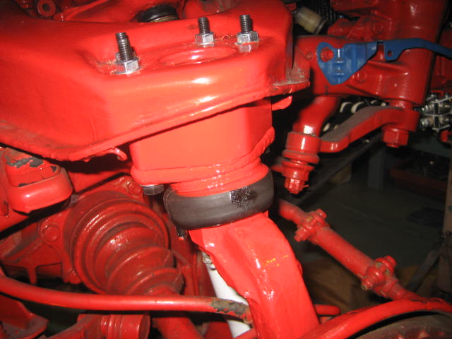

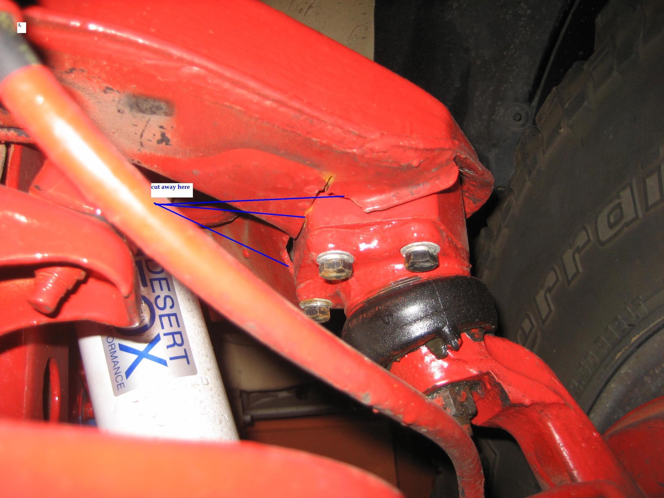

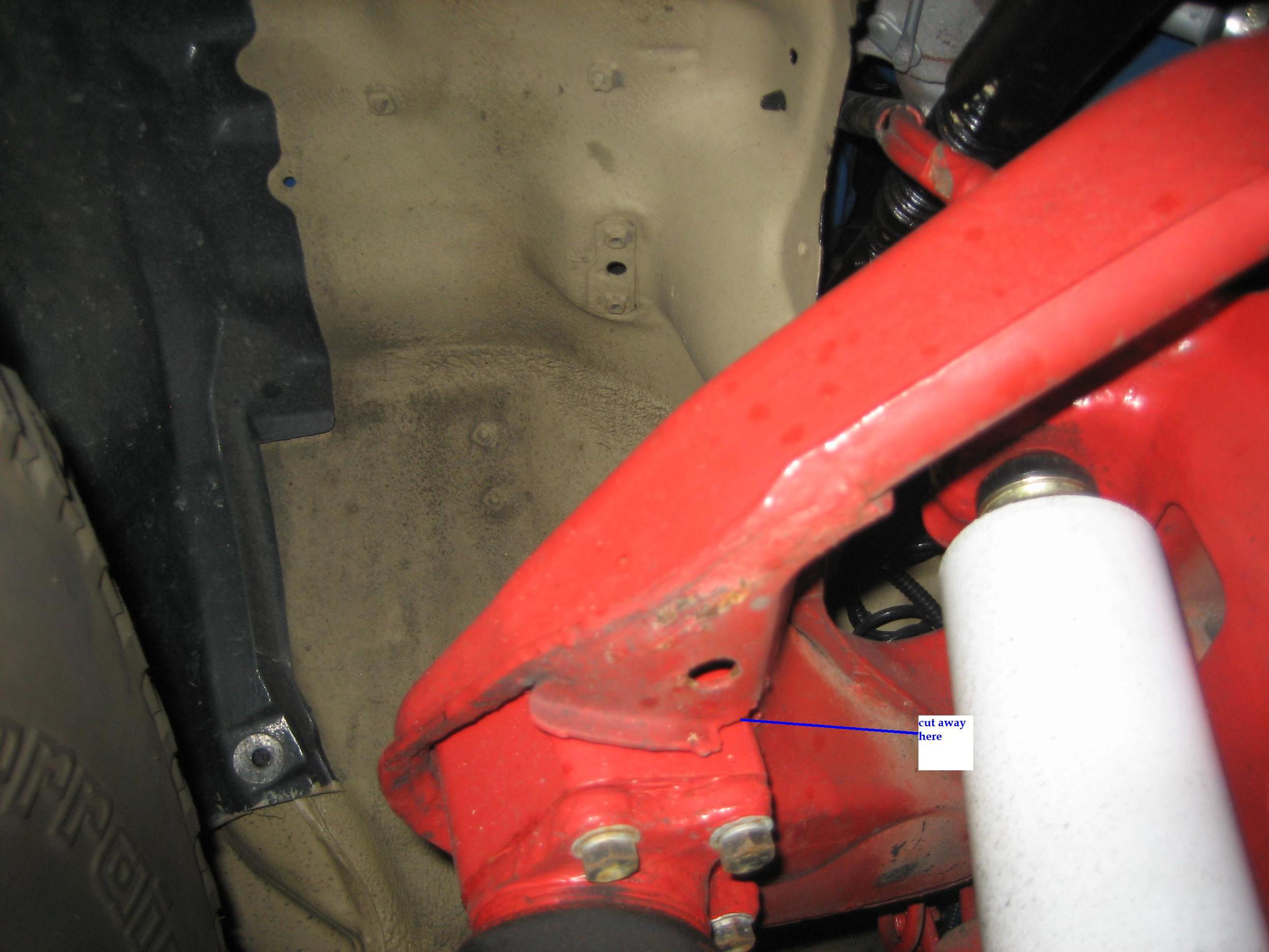

for 2in blocks you will need to disc cut some metal under the wishbones to get them in flush but not too bad a job, if it's any help I have some pics of when I did mine and also the drawing for the front spacers measurements etc let me know and i'll look em out,
