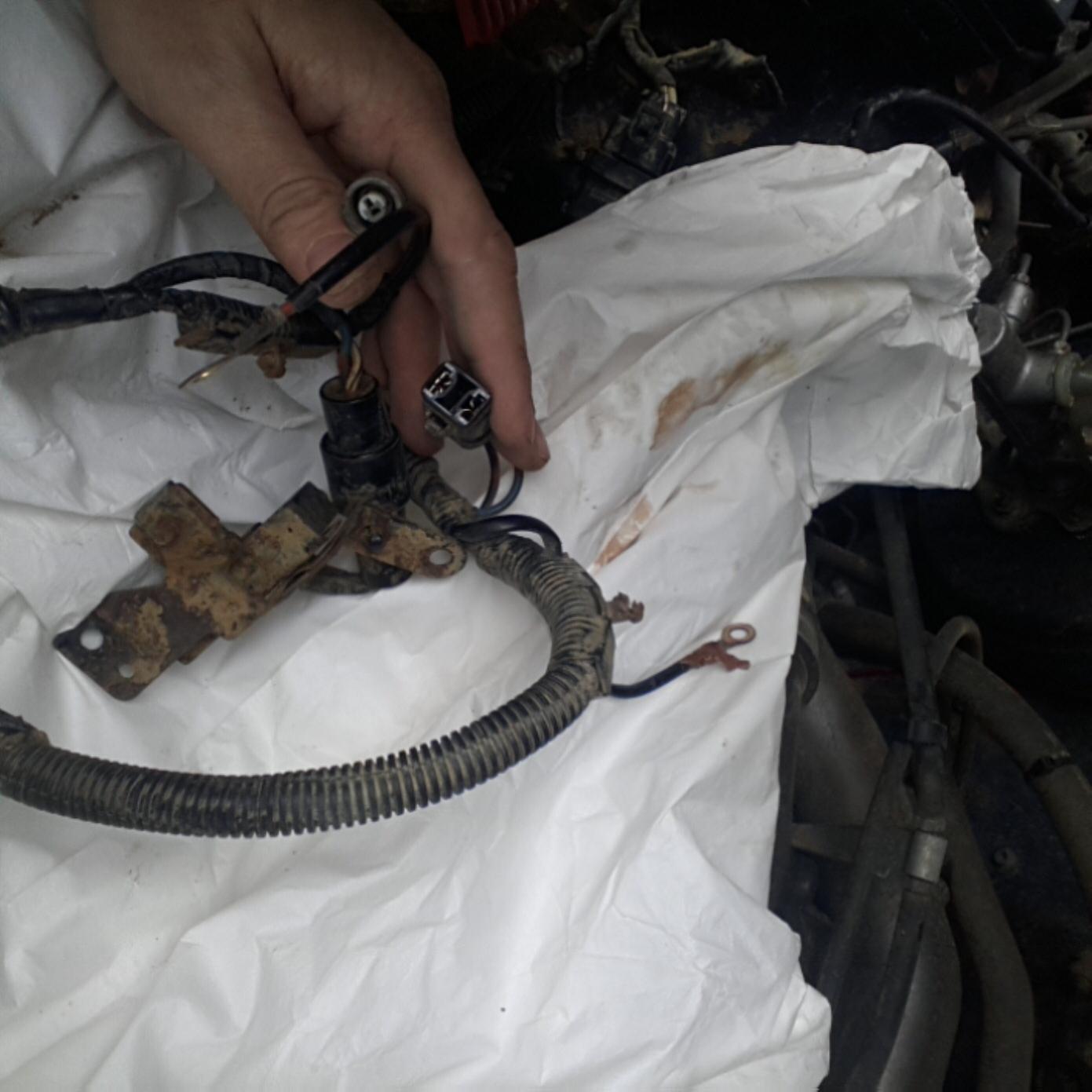

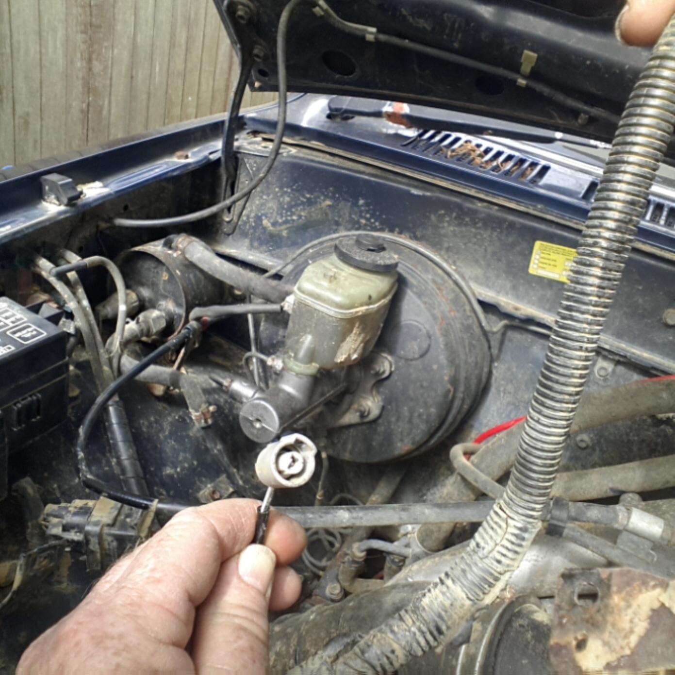

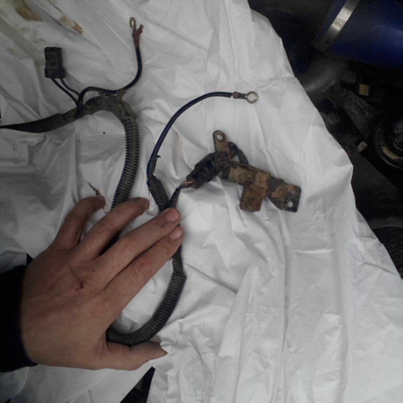

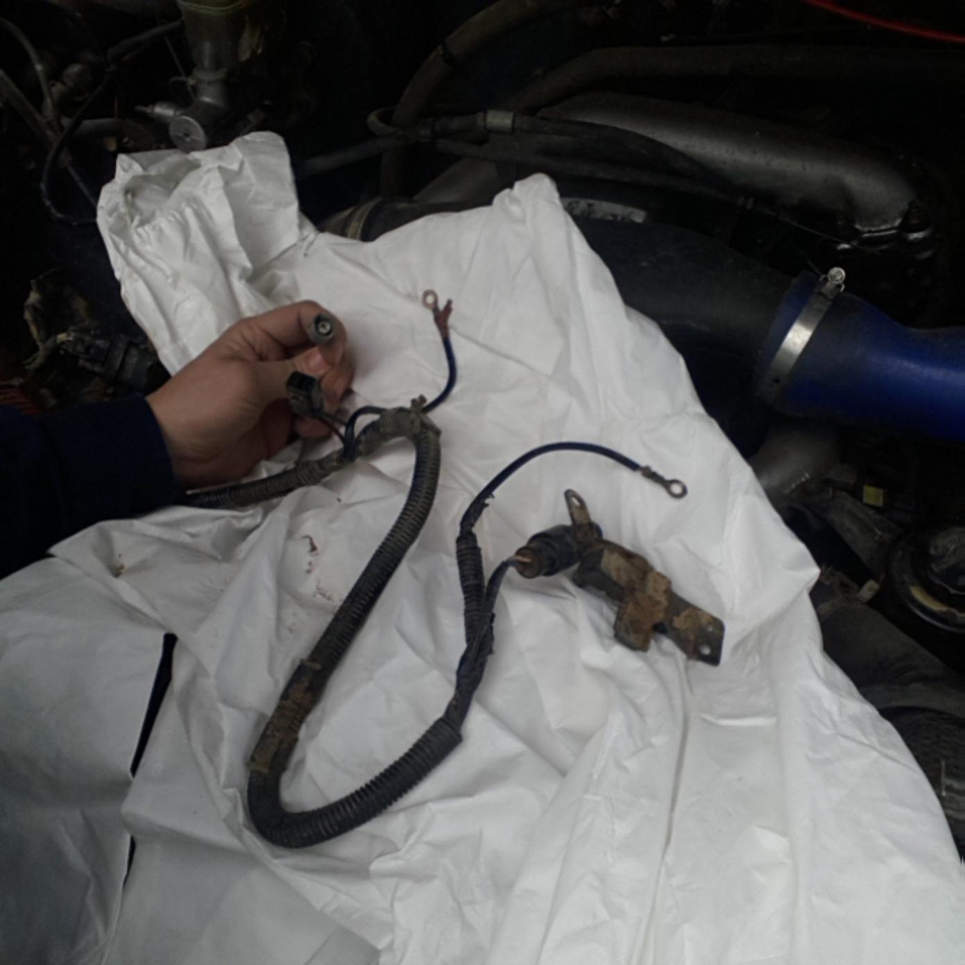

    As said, the only thing that i've done is removed the compressor, condenser and small aircon fan. Unfortunately, and perhaps stupidly, i didn't keep any of the above items to reconnect if anything went wrong. I am just left with three plugs, one of which went to the compressor, one to the fan and one to a <thing- temperature sensor?> that's plugged into it as shown in the pictures.
    I can hear the normal click from the engine bay when i turn the ignition on (starter relay?) but nothing else. when i turn the key to start the engine nothing happens though. Can anyone help?

                  Bio has it, isn't one of those ring crimped cables supposed to go back on?
                  Keep the fan wiring connectors off and also the small grey single wire plug.
                        Yeah, those were connected but still no joy...
