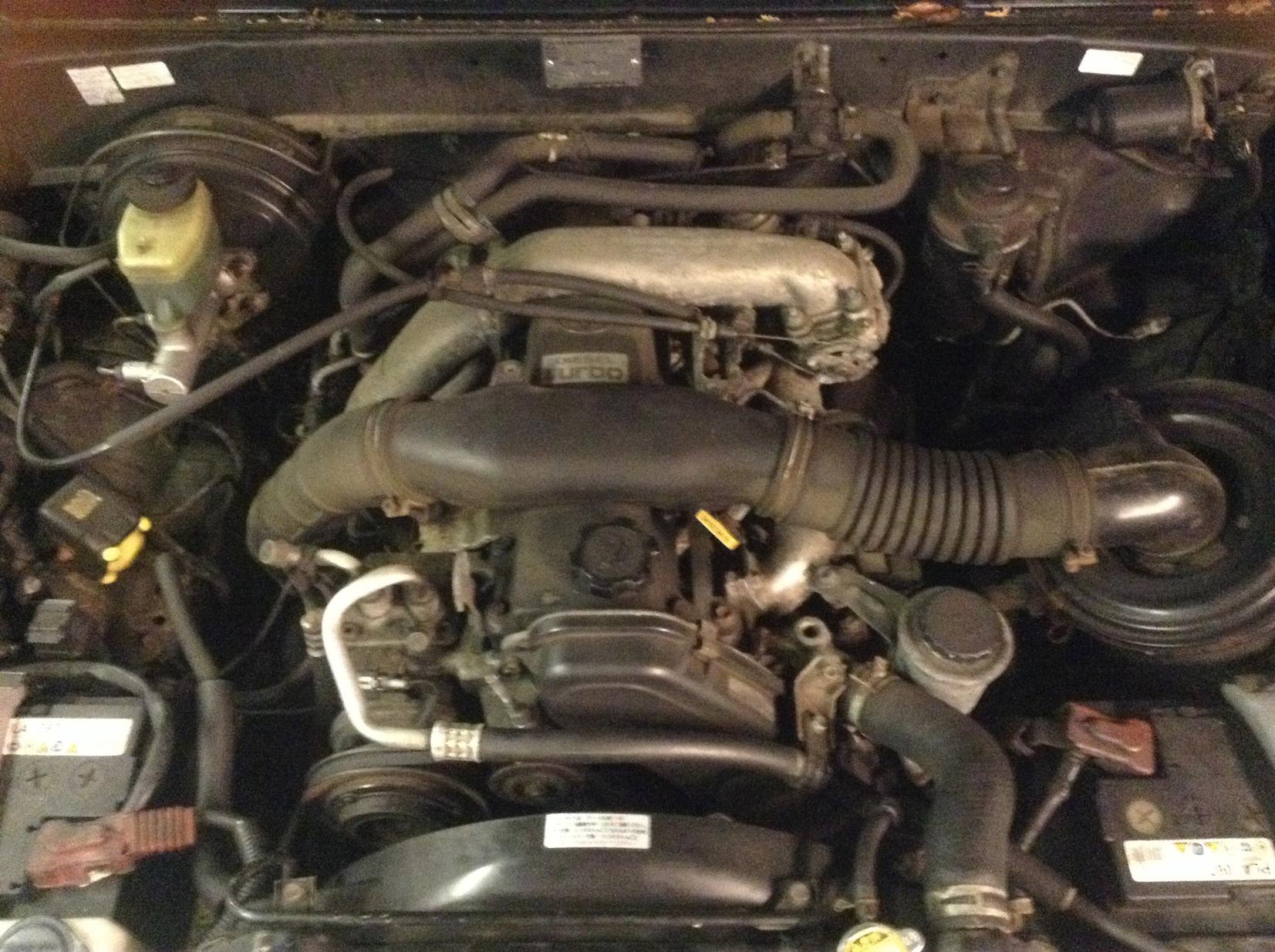

        put a pic up of the engine bay, soon tell you what you have.
          I will get a photo of engine bay tomorrow inc vin plate , thanks for your replies its a grat help.
            Does it have a turbo ?

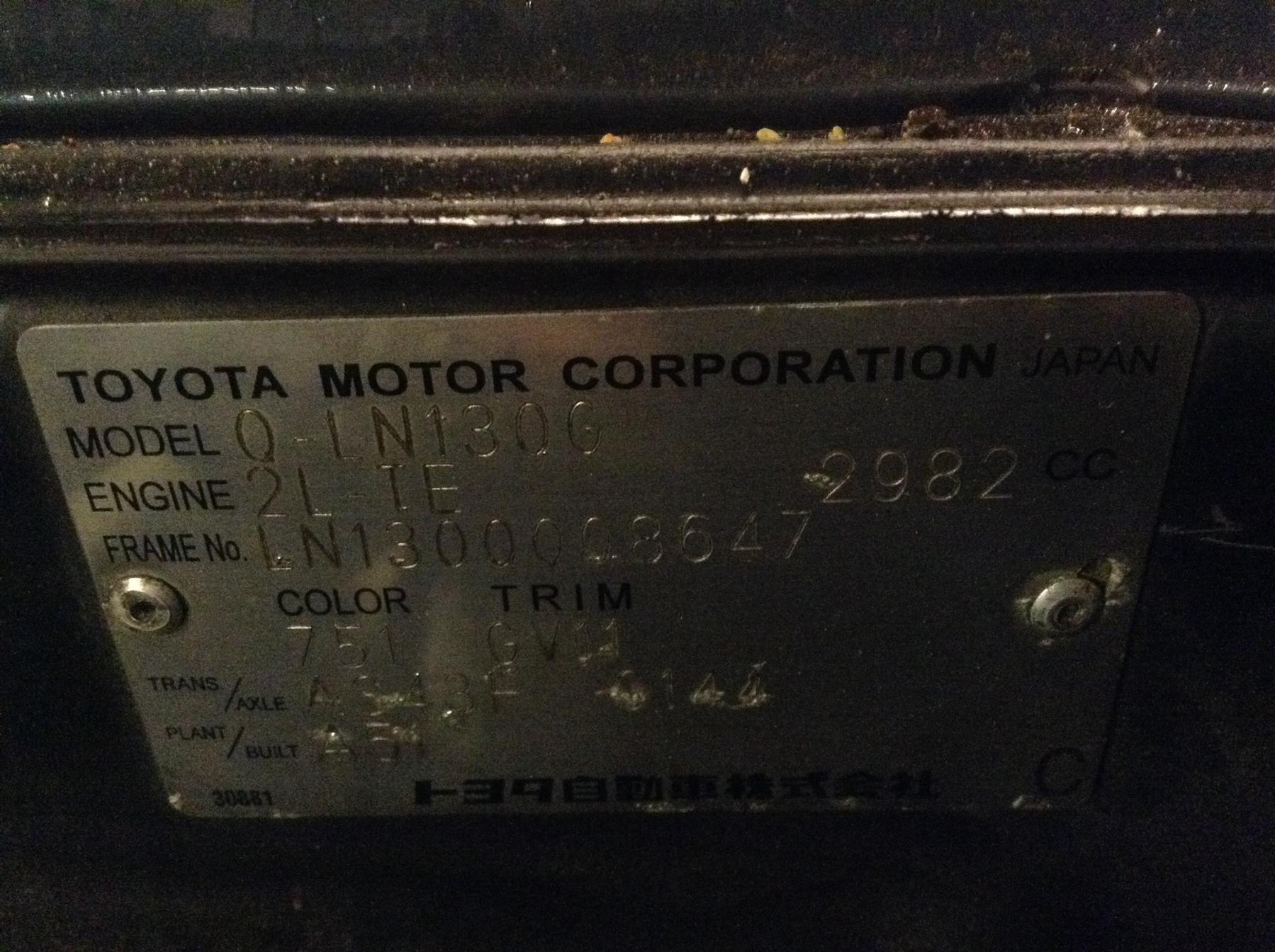

              Yes it's got a turbo diesel but I'm not sure if vin plate is genuine it says q ln130 g 2.980 litre im thinking maybe vin plate and engine may have been replaced.
                I thought it may have been a 2.8 normally aspirated diesel.
                Photos will clear it up.
                  I've tried to post pictures but this site just won't take them as I upload them they seem to get lost on the way
                    My engine bay
                      And the vin plate
                        Hi,
                        It looks like KZ TE to me but I can't find me glasses and had a bottle of Rose with my Sunday lunch...
                          In my modest opinion your Vin plate is for a 2.4 Surf but you have a 3.0 engine in it. But maybe you should wait for someone who is sober, or has good eyesight or both!
                            Ah...found my goggles!
                            So, the VIN doesn't make sense to me...it says 2L TE (which is the 2.4 engine) and then it says 2982 cc ( which is the size of the 3 litre engine)...
                            Weird
                              It looks more than likely that it was a 2.4 as the reg plate said and its blowed up and someone has fitted a 3 litre so I'm looking at buying body and brakes etc for a 2.4 and engine parts for a 3 litre 4Runner I was thinking of naming it hinz like my dog he don't know who his dad if either.
