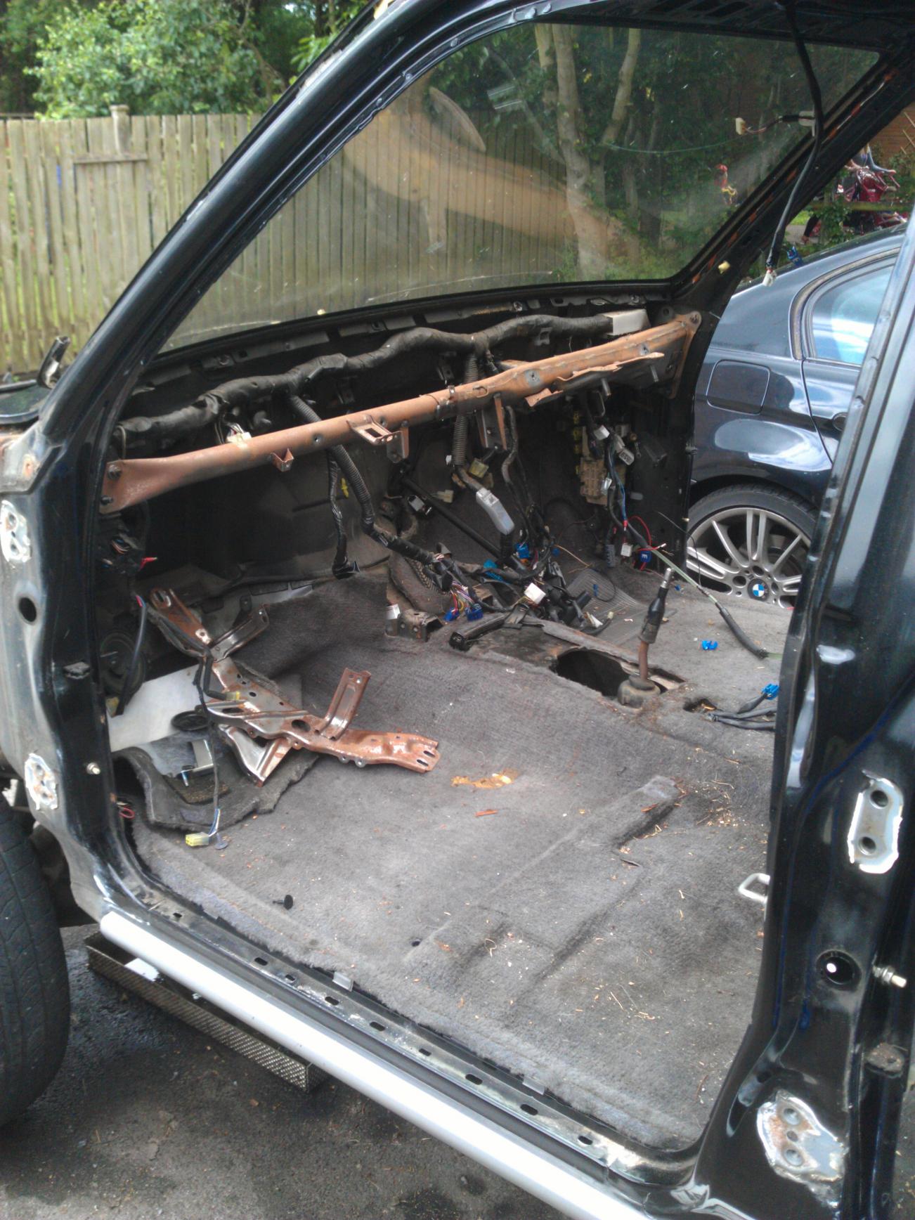

      You can put it wherever you like,(apart from the passenger side top dash) there are just two wire cables to worry about, one goes through the dash to the on/off manual valve on the heater hose and the other goes to the linkage on the bottom lower of the heater, Then there are two multi wiring plugs on the back so the wiring will need to be extended,
      i moved mine back inwards when i re did the dash, you wont be able to put it in the soft plastic part of the passenger side dash as there's a big steel brace and the air vent pipe right behind it,
            Just to illustrate Popeyes point about braces...
              Ahh see what you mean lol. Was hoping I couldve placed it about or below the bar, but going to look at mounting it under the ashtray
              Thanks
                Was that a wrecker Andy? first time i've seen that brace "all at once"
                  Think of it as a "doner", pretty much gone to the green lanes in the sky.
