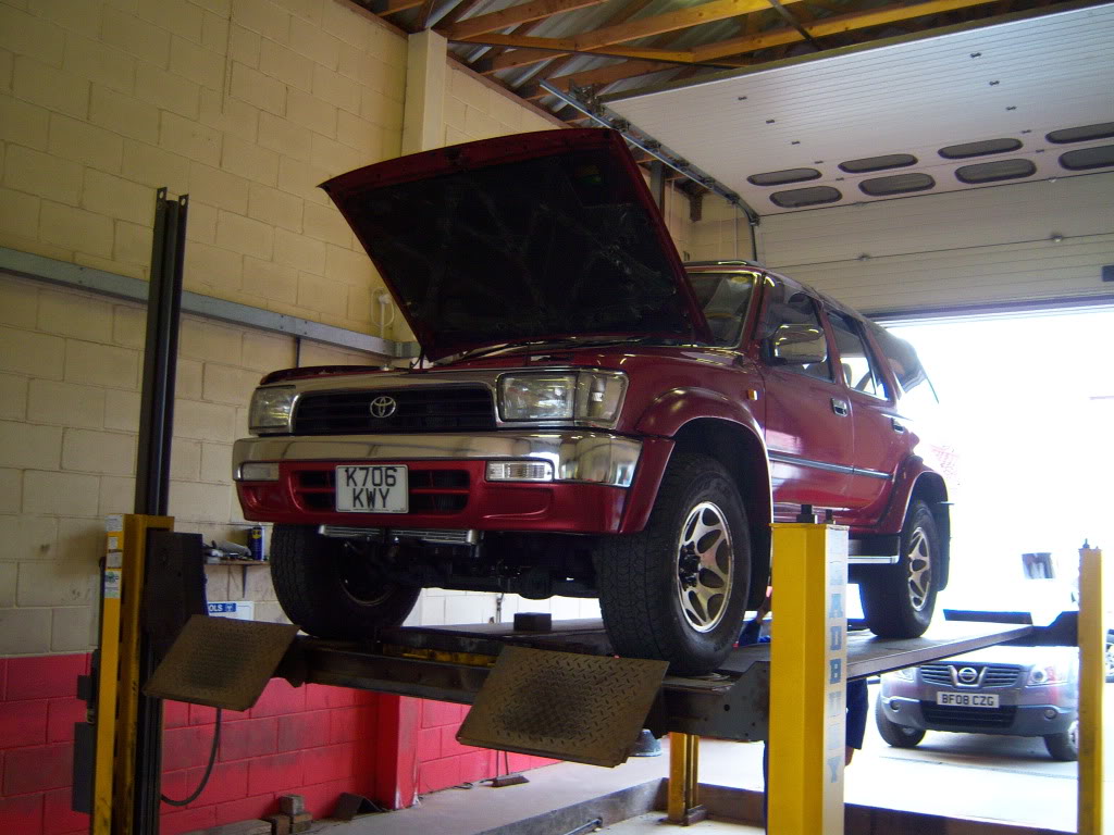

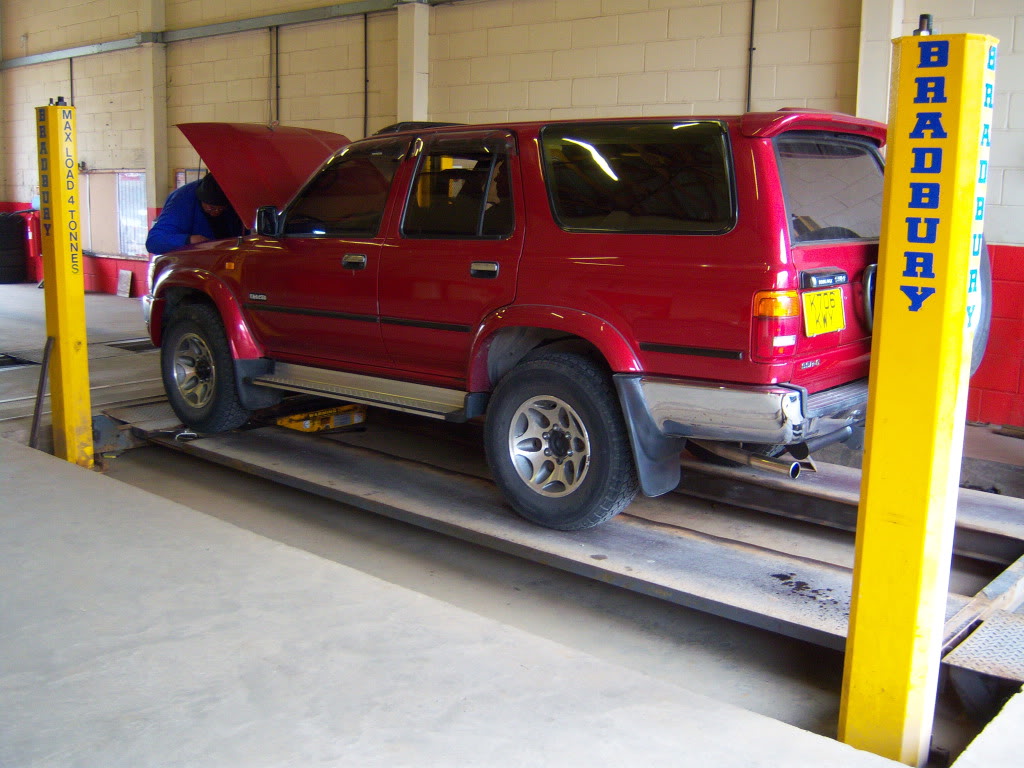

          Image found on Google..
          I suppose i'm looking for this but in the UK, just not found it yet. Thinking it might be better to just get the next best one.
          Thanks, would probably fit it with them then. I think its all down to my dad having one, in red with the chrome. But that was a 2.4 auto diesel. Would love to see if that car is still about.
