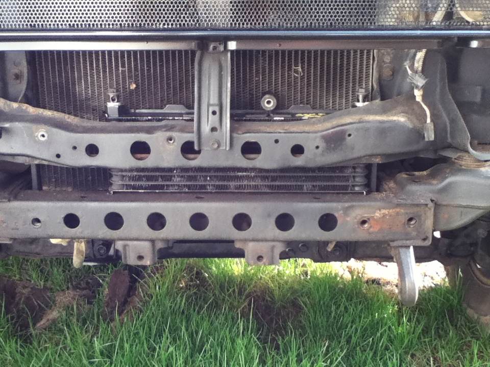

                I have got one of these.
                Eat.Sleep.Surf.Repeat.
                  And it is going here

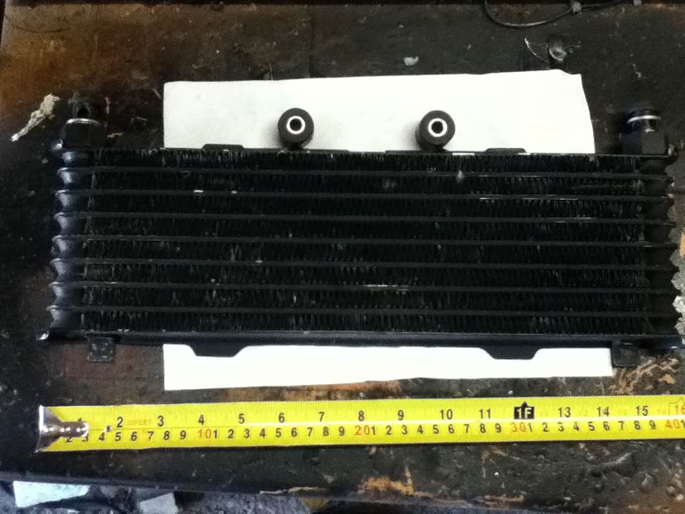

                      I have an old Suzuki gsx 600 lump in my shed and I'm sure it has a cooler like that still attached(wonder if it will be big enough?) either way will try and get it done this weekend before the boat towing weather gets here😊

                        YUP
                        well spotted 600 gsxf to be precise , but afaik it uses the same cooler.
                        As you can see it does fit quite well in the gap in front of the rad, and you have plenty of routes for the oil lines to flow round to the original pipes.
                        Nice large inlet holes on the banjo bolts too.
                        I am pretty certain that it will be ample size wise.
