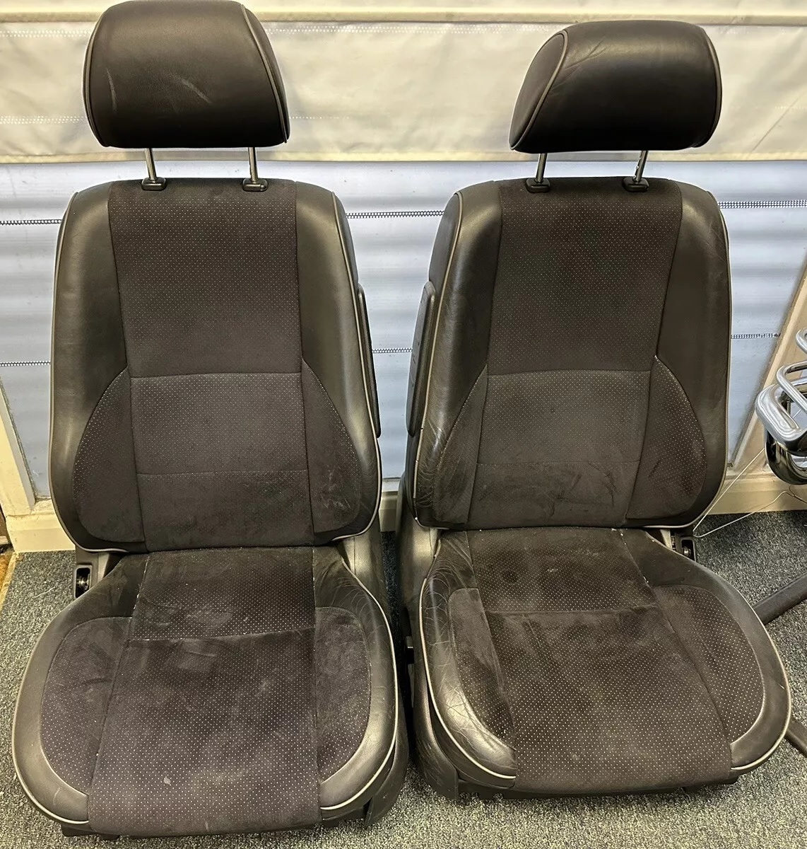

                +1 for IS200 seats.
                I got a full f-r set with door cards for £120, but if you think about the Surf, the rears are 50/50 split upper and lower, and both hinge forward. The IS200 seats are single, non-hinged pieces. The back piece is just like a flimsy shell, no substance to it - it couldn't replace the Surf rears.
                I was quoted daft money locally to retrim the rears using the material from the IS rear seats, so in the end, I gave them away and just used the fronts. Others here were quoted better prices in their locales for this and got a good job done.
                I didn't do it myself but the write-ups here are good. The guys who did my paint got it done while the truck was with them for a while. I was out of action for a few weeks this Summer when a bird knocked me off the bike, so this was the perfect time to do all the odd jobs on the truck.
                I got the heated switches off ebay (try and get the Lexus ones if poss, mine were generic rockers and about a 90% good fit). I don't know if the IS200 heated controls have a dial, mine are either on full whack or not on. Full whack is not uncomfortable for me and most welcome in frosty weather.
                I put them in the centre console where there was one blank and I surrendered the hard/soft button which I never used anyway.

                  Looking to install a pair of IS200 Seats in my '94 4Runner, and have found a pair for £100, which isn't bad given how the price of everything seems to have tripled..
