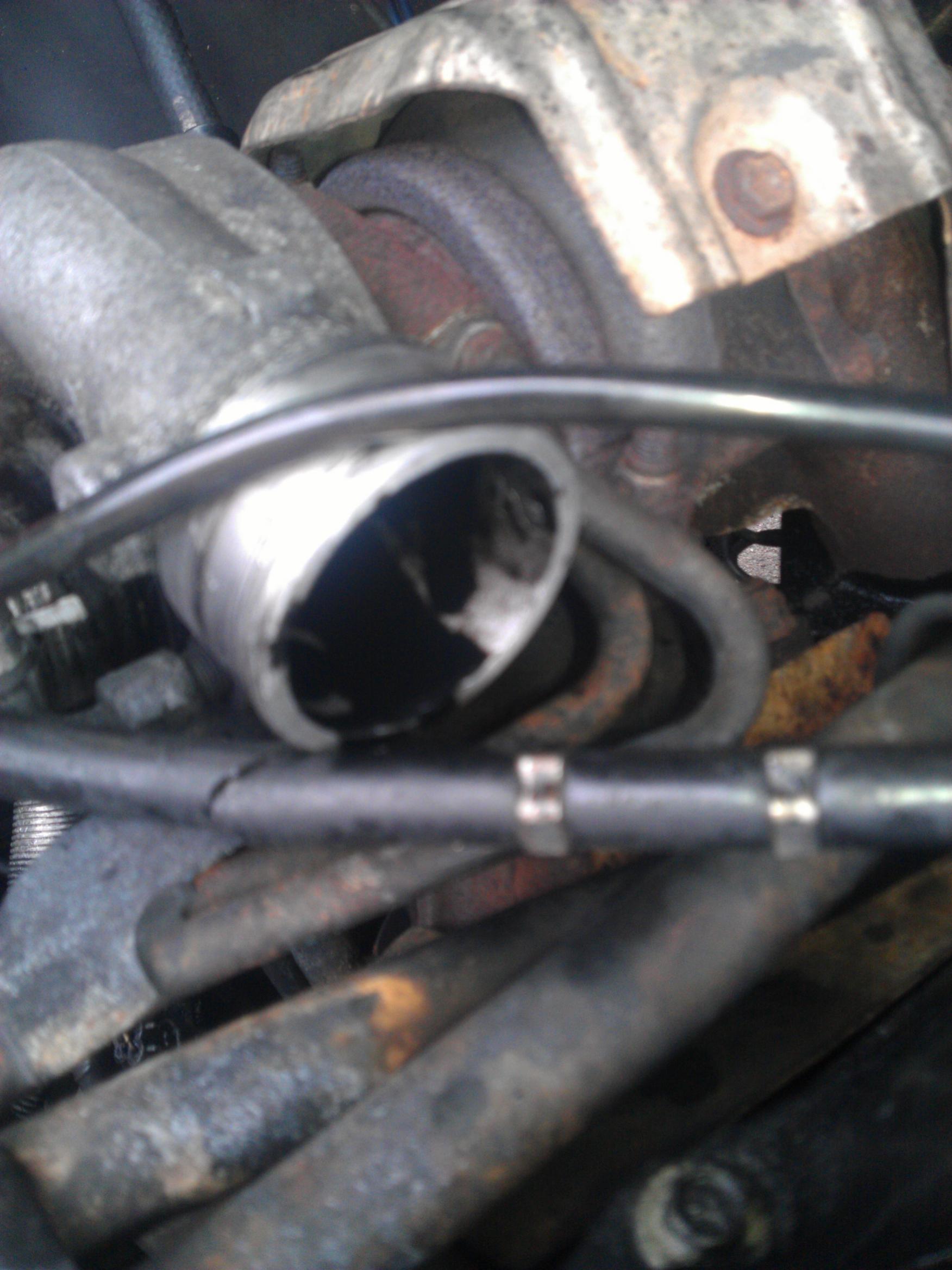

                              I took the turbo elbow off and there does seem to be oil in there. If i wipe my finger in it, it comes oil black..
                              The 'steam' (as ive been incorrectly calling!) is now visable through the air filter pipe. As it is removed from the turbo, I can see it coming out of both ends. (The other end being the airfilter...)
                              I'm guessing this is burning oil? What does it mean?
                              Thanks for all of your help so far!
