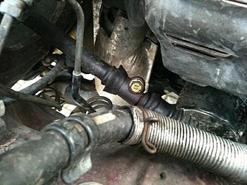

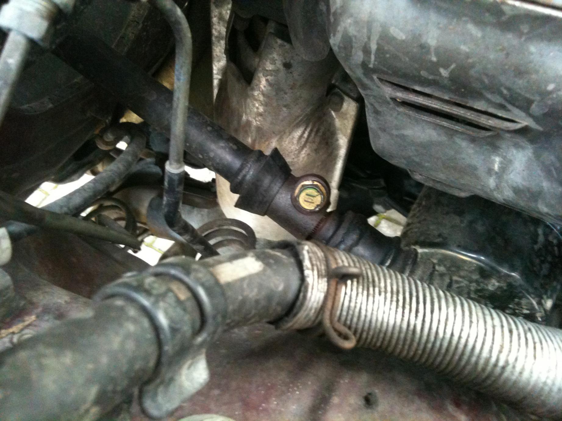

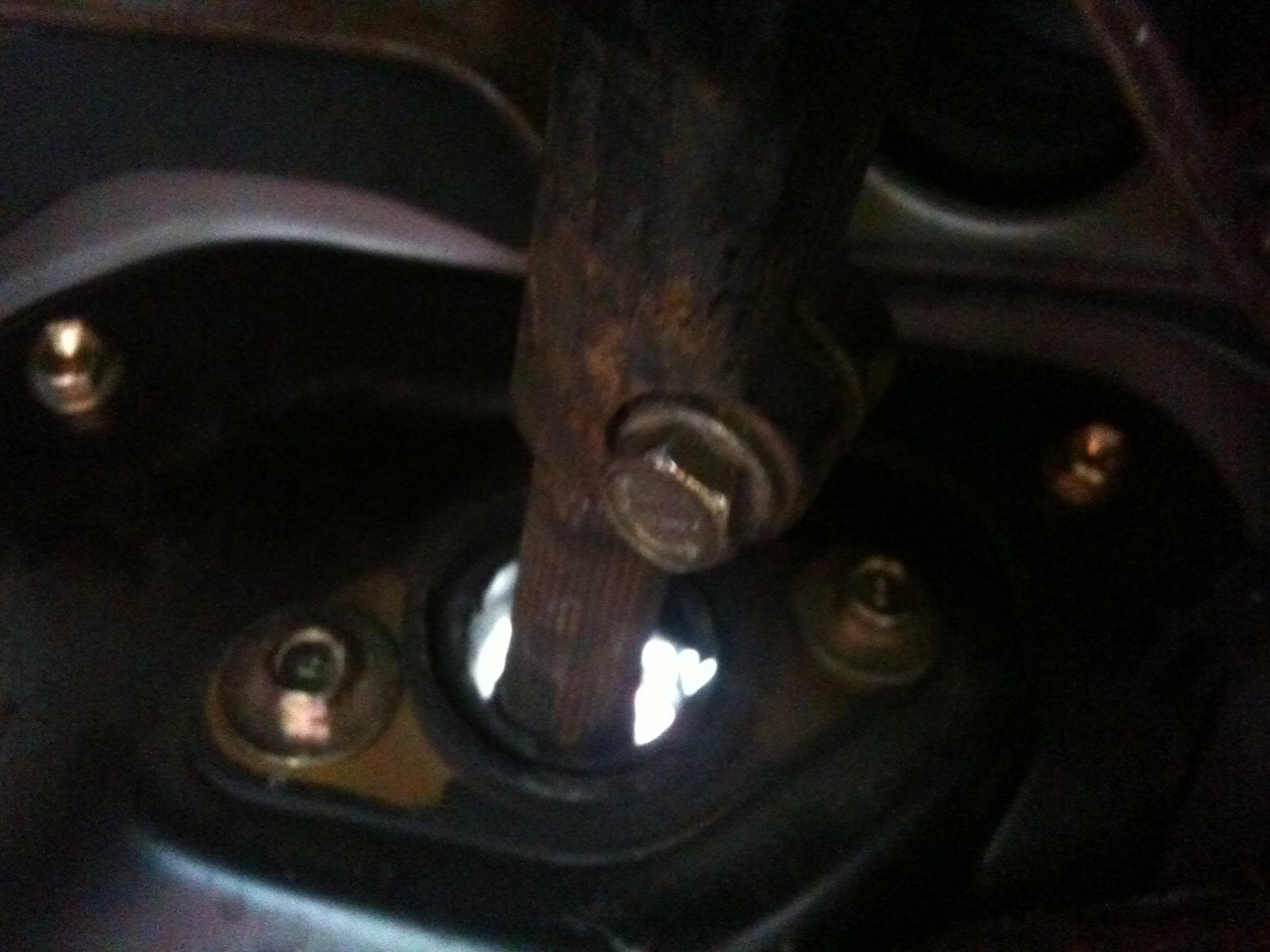

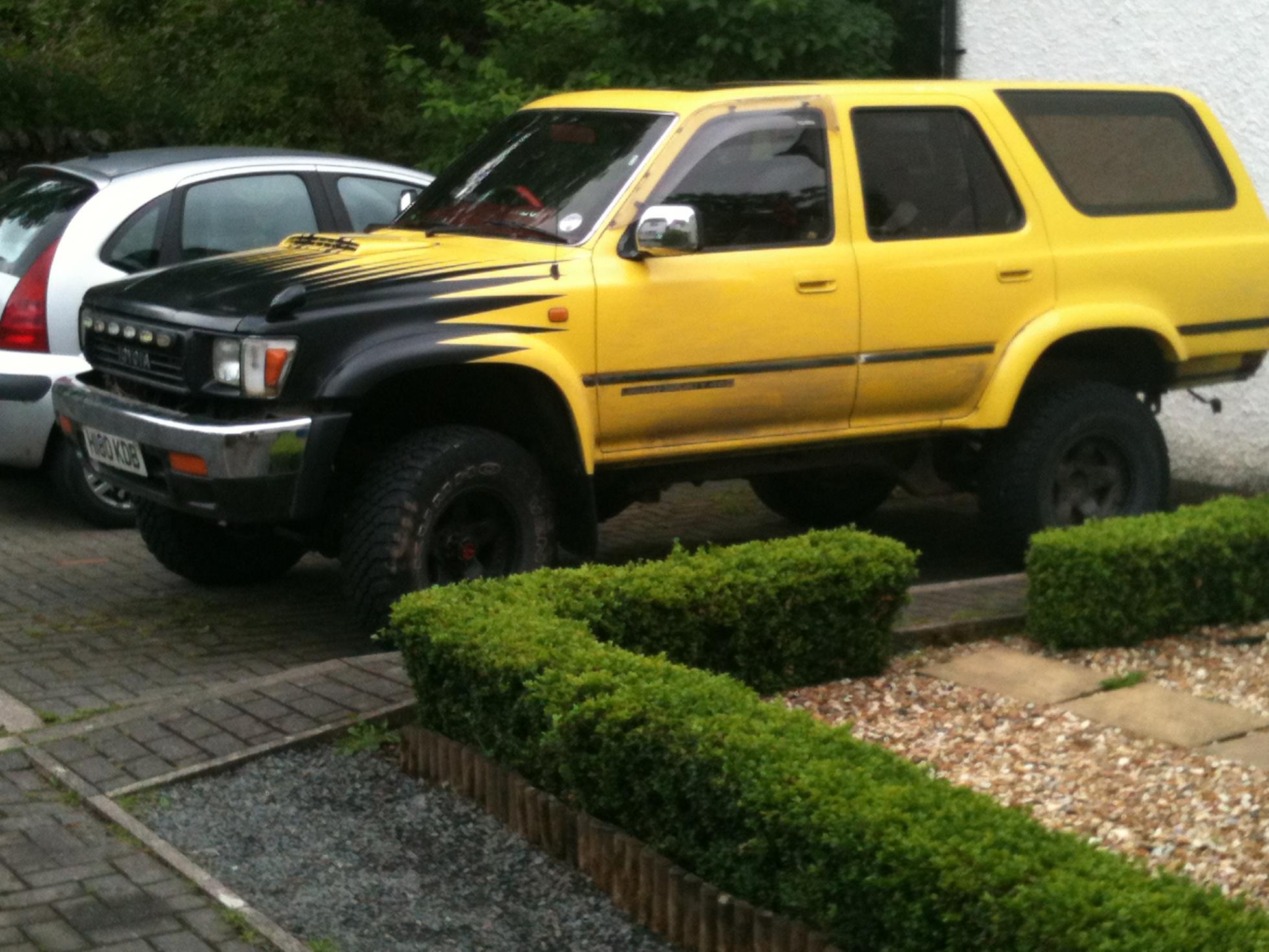

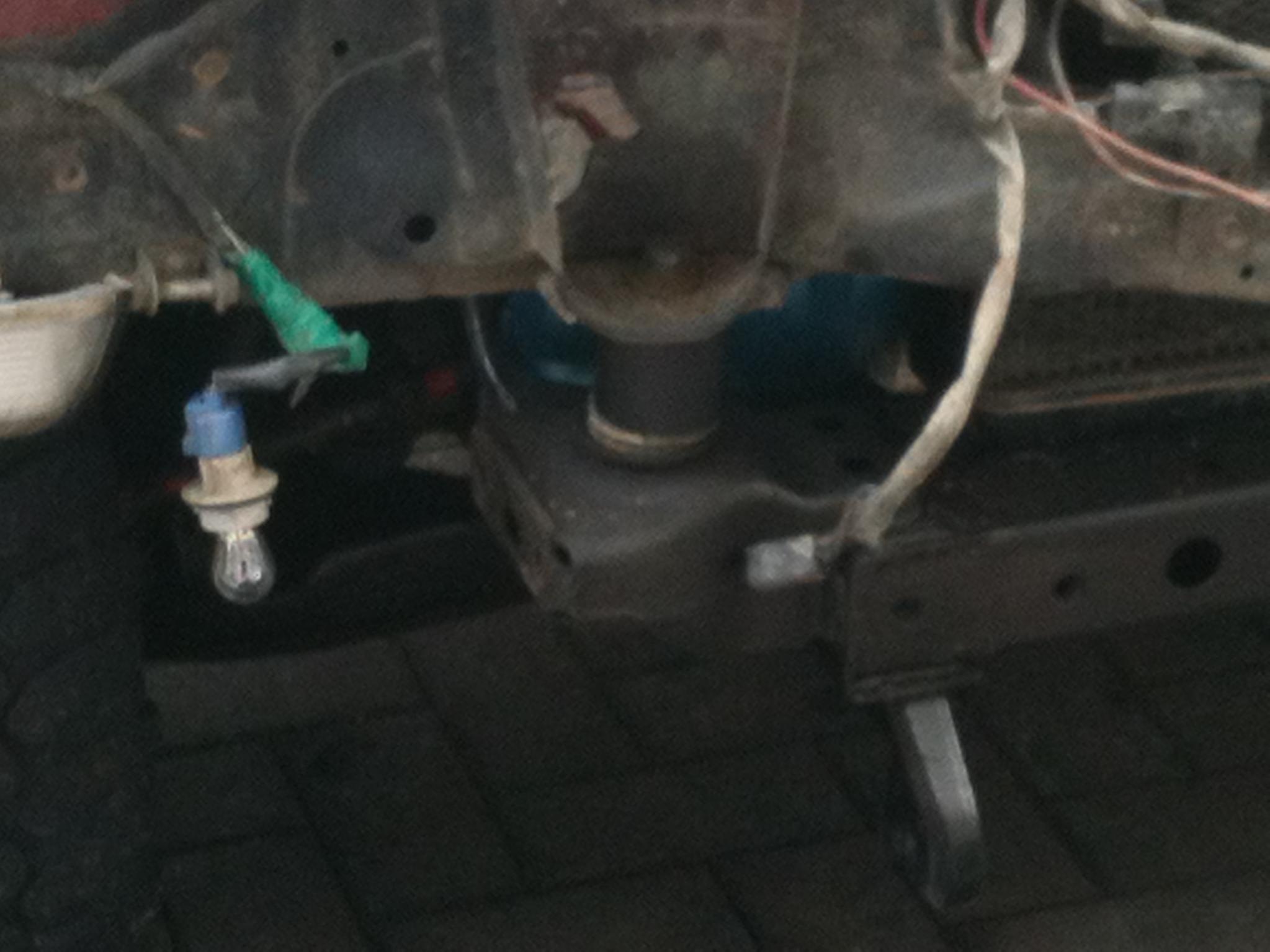

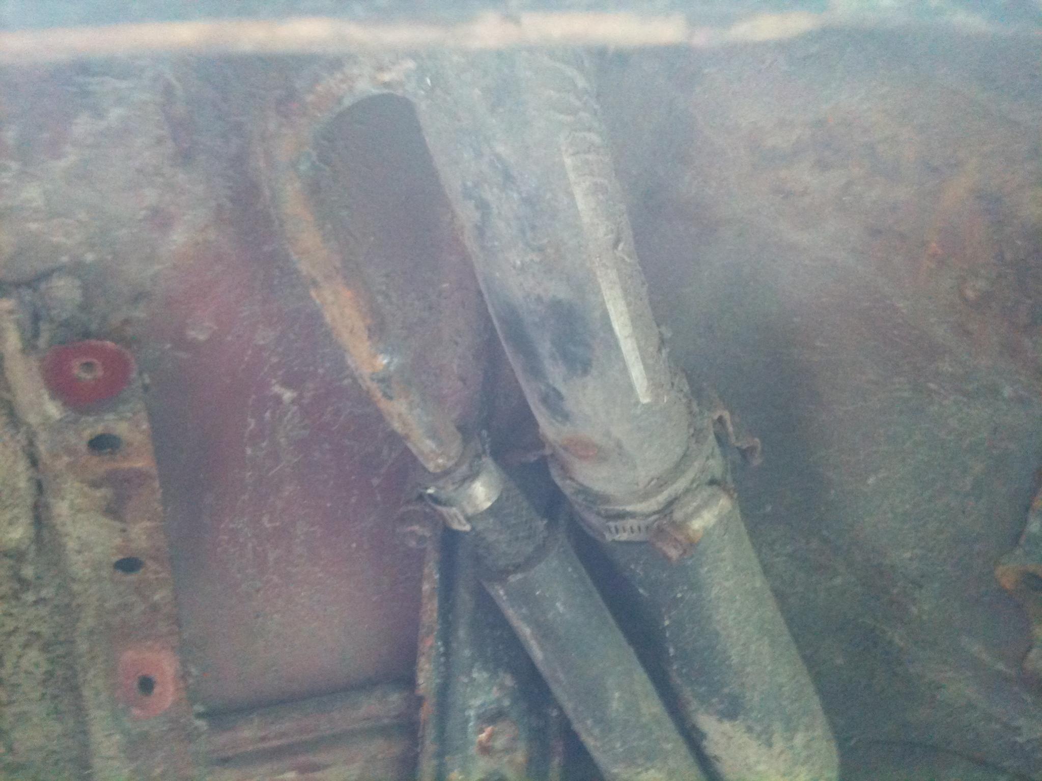

                              Evening all, body lift finished today just waiting for the bumper brackets.With the help from the good folks on here, it went very well (no probs at all).Steering joints moved nicely,front brake lines extended on there own. Didnt need to enlarge hole for the steering shaft, it just feels a little bit stiffer now nothing to worry about i dont think.

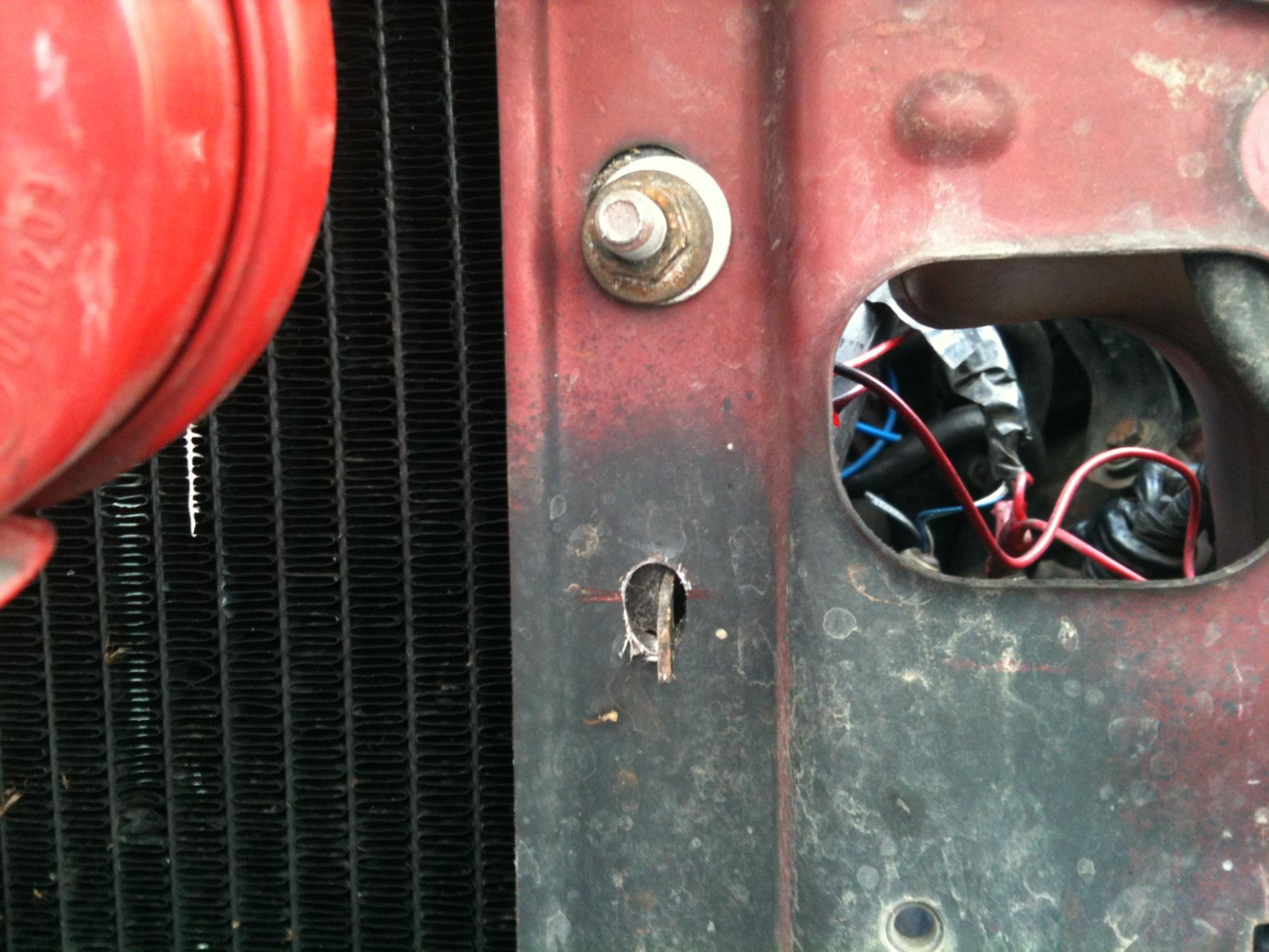

                              Regarding the rad,i didnt use drop brackets i used the next set of large holes down,thay are just in the right place. I also drilled two more large holes 2" down from them to allow the safty hooks to fit.
                              Really happy with it thanks again for advice. Mick.
                              pic 1.. front lift block.
                              pic 2.. filler pipe,didnt need to move.
                              pic 3.. steering shaft bolt i engine bay.
                              pic 4.. steering shaft bolt under dashboard.

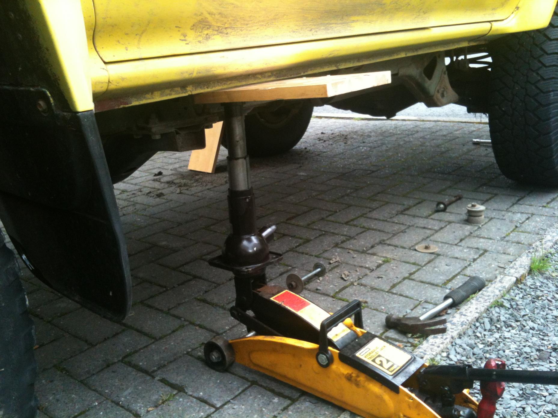

                              pic 5.. dodge lifting of body.
                              pic 6.. new fixing for rad.
                              pic 7.. finished job.

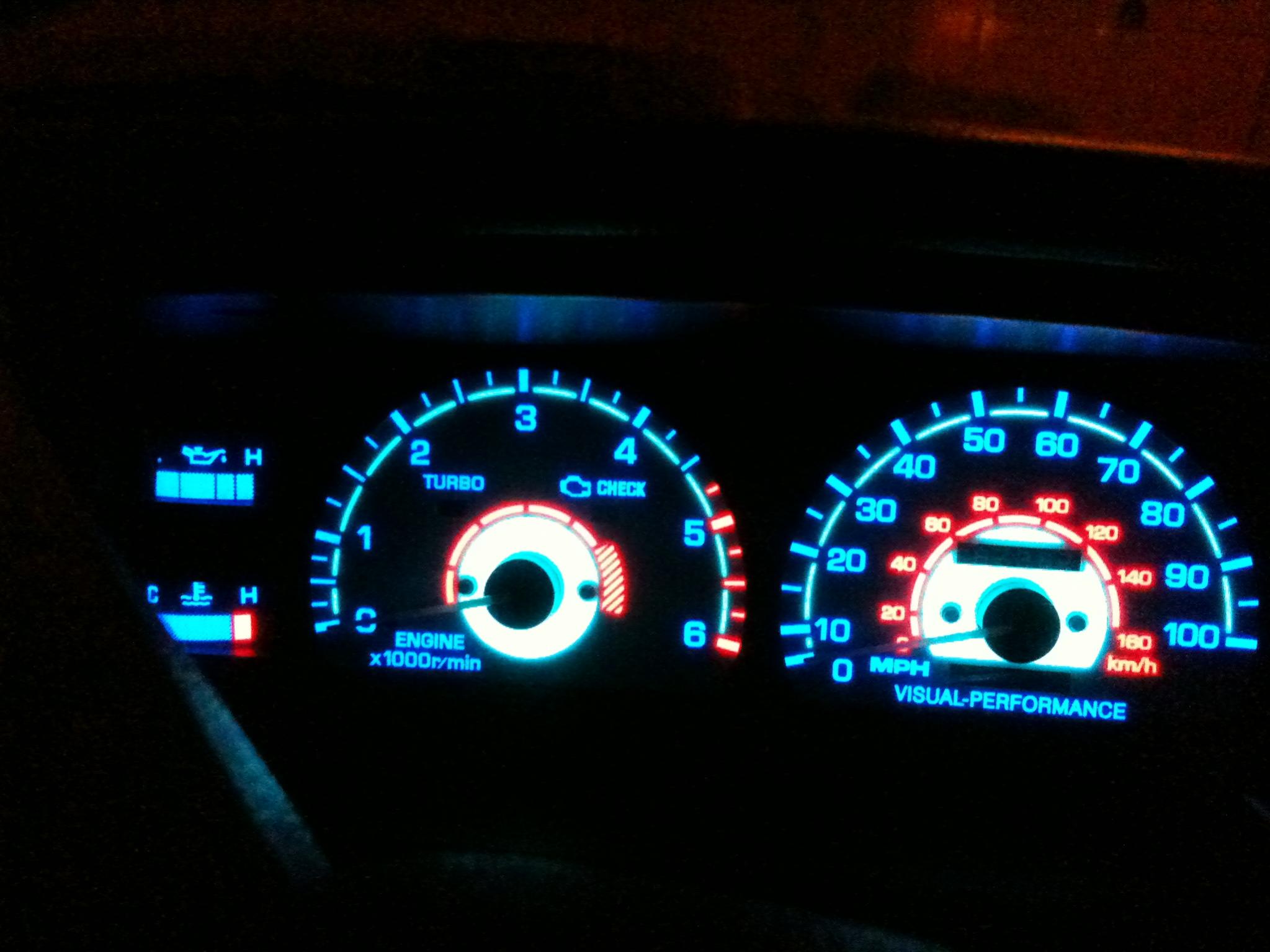

                              pic 8.. plasma dials fitted this week as well.
