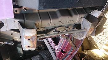

first got a corner of a surf to get the reinforcement inside the skin

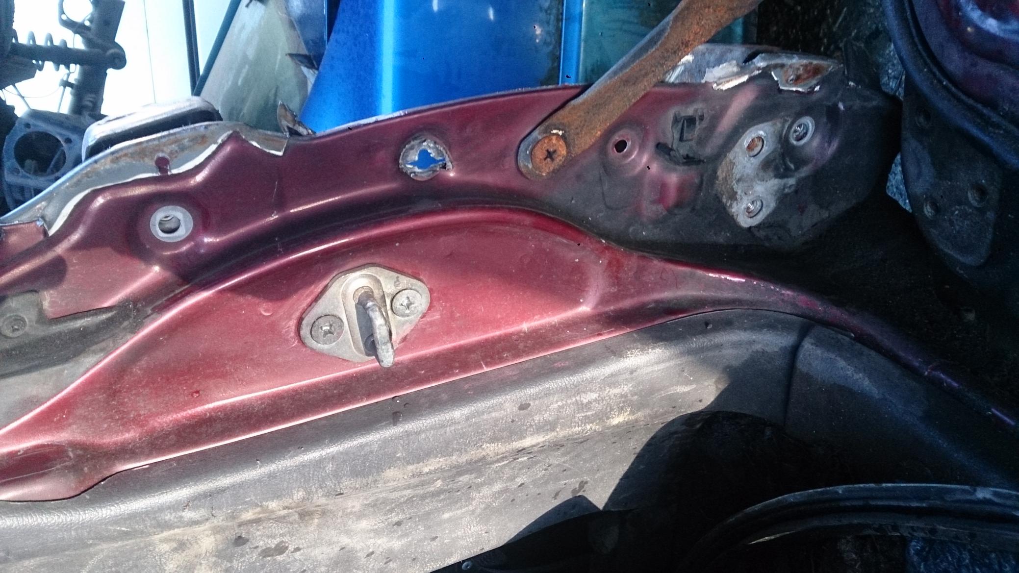

then got a tailgate same color from a surf that had swing away tailgate due the internal reinforcement of it

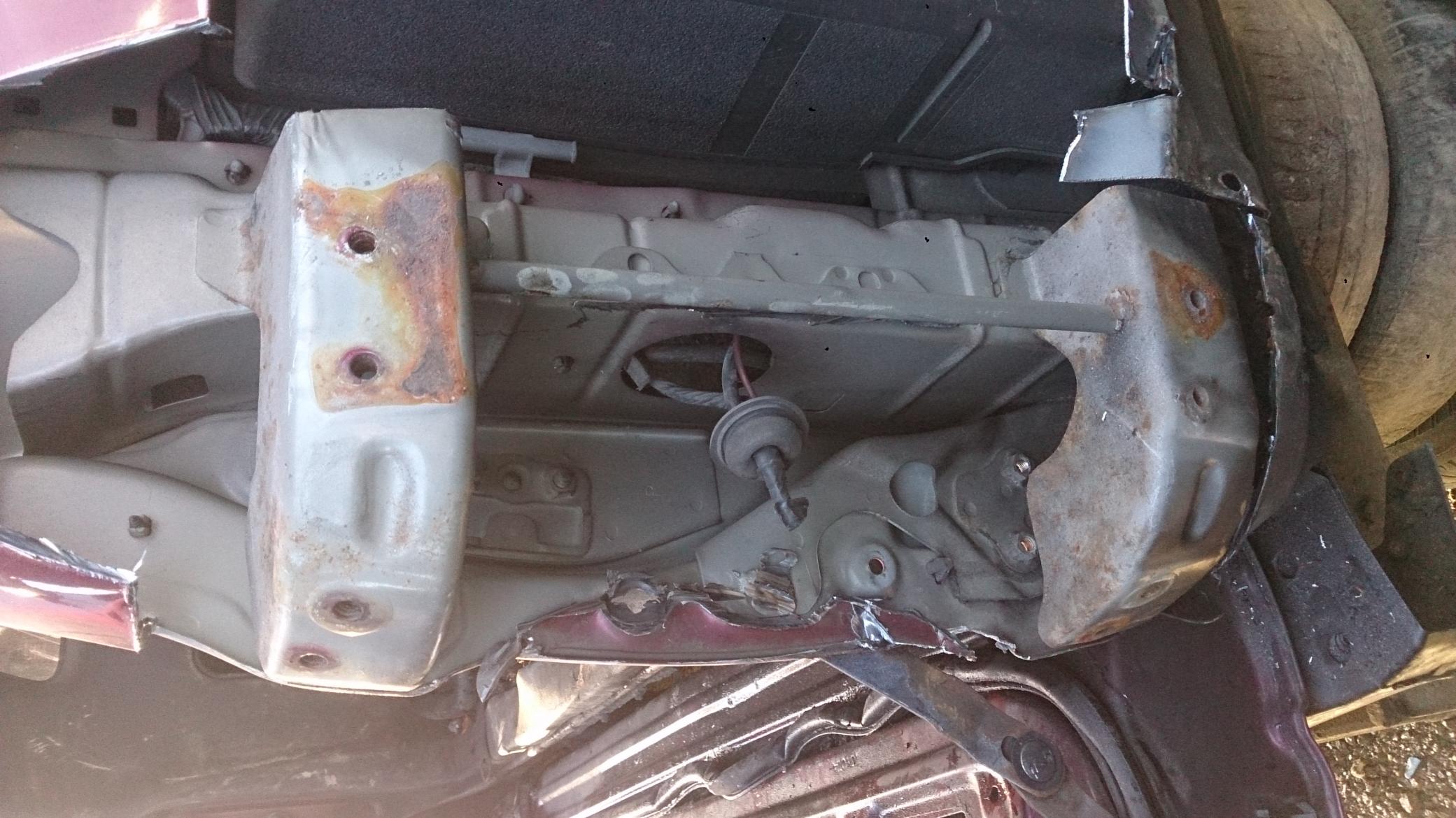

removed the old tailgate, and started to cut the reinforcement in half, due it won't fit in one piece
