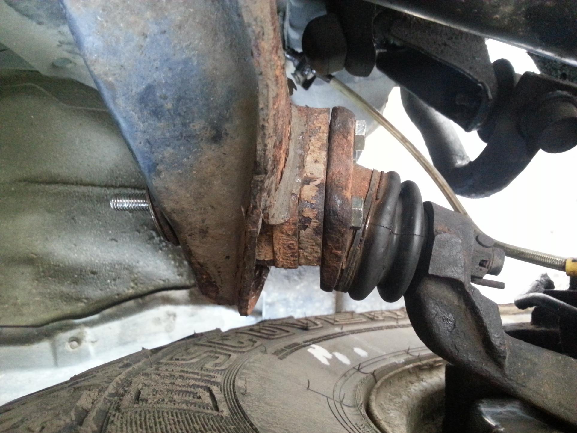

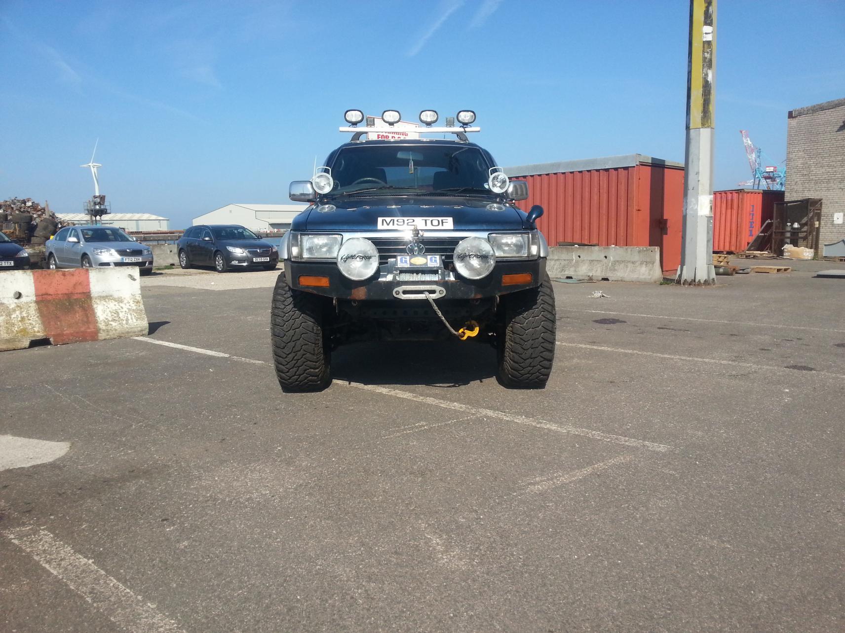

    what have i done wrong?
    all i have changed is the shock the extended brake line and added 2" spacers on the ball joint!
    am i missing something?

    Yup, you missed getting the alignment reset.
    you need to get a full alignment check done on the front end minimum to get the camber (I think that's the one) sorted out.
      Or get castor correction bushes.

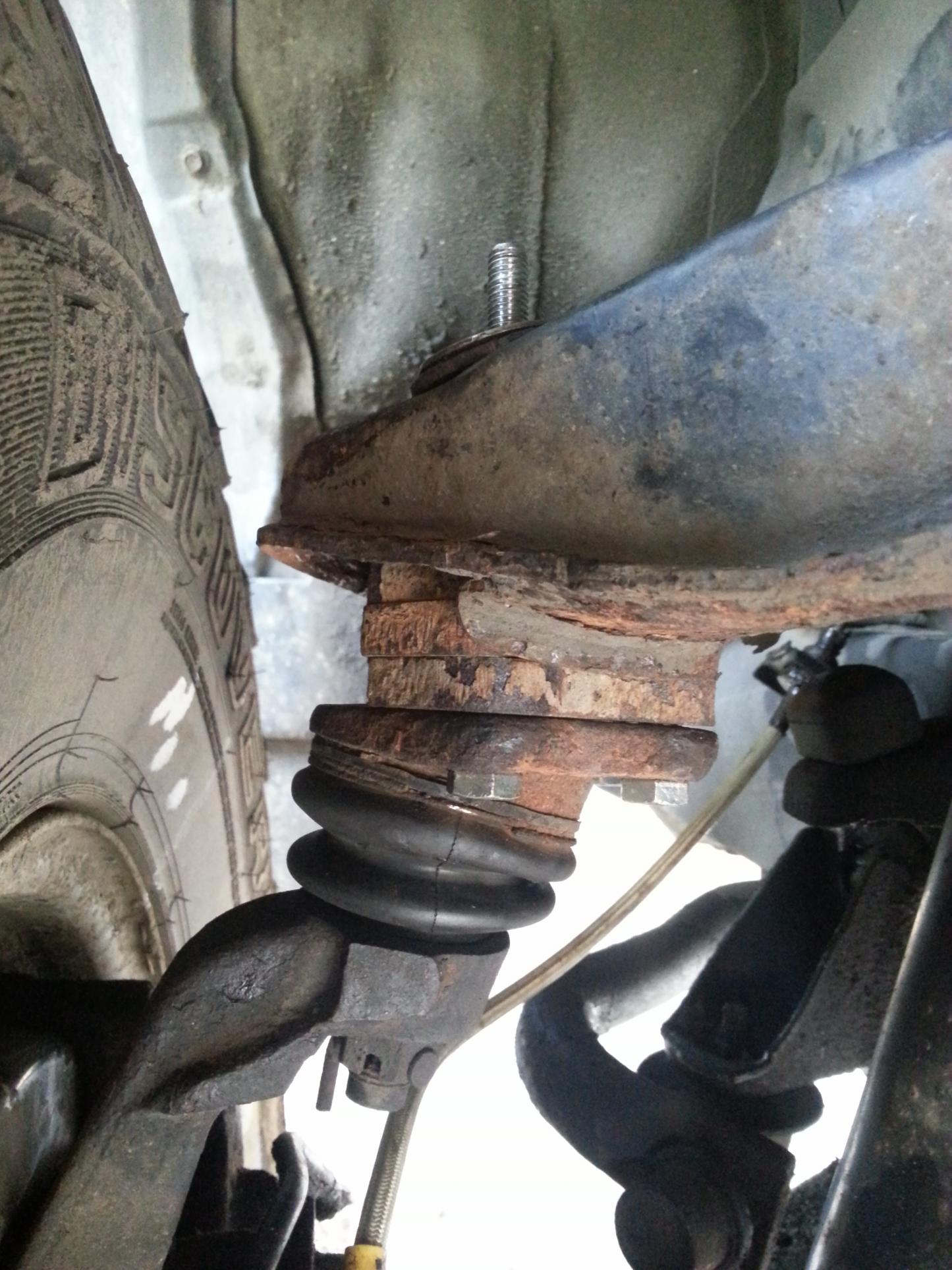

        That balljoint looks wierd. Whats the threaded section sticking out of the top?

          added a photo the right way round!
          the threads are just longer bolts! ive put the nuts at the top thats all.
            Ah, OK.

                You need the camber set up. Think of it, when you jack the front of a standard surf up, the wishbones lower and the bottom of the wheels swing inwards. Thats all, you have increased the angle in which the arms sit.

                    Are your spacers all sitting flush with each other and the wishbone. I had spacers like that and had to modify the wish bone to get thm in. In the end I got the spacer kit that come off the hub and not the wishbone, because my wheels were just too wobbly with the spacer kit. That a hell of a camber. They really should never get that bad out.

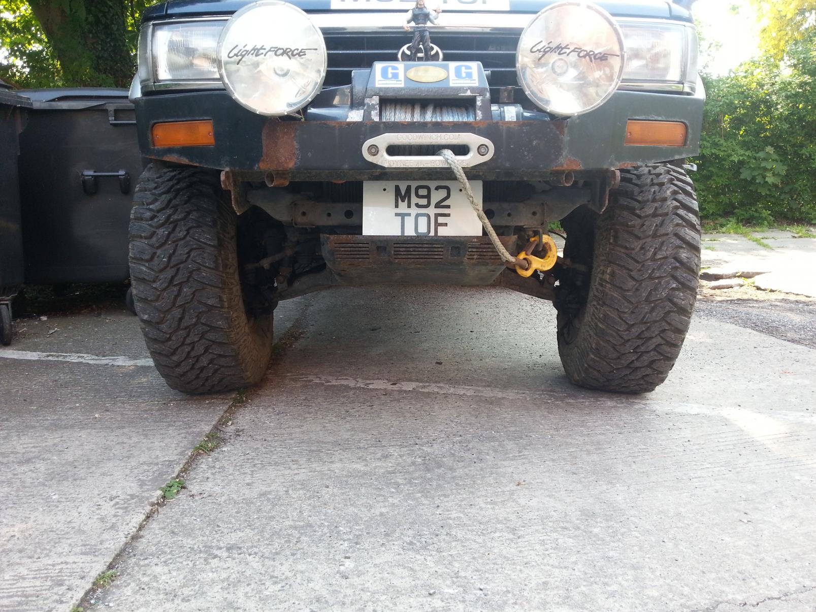

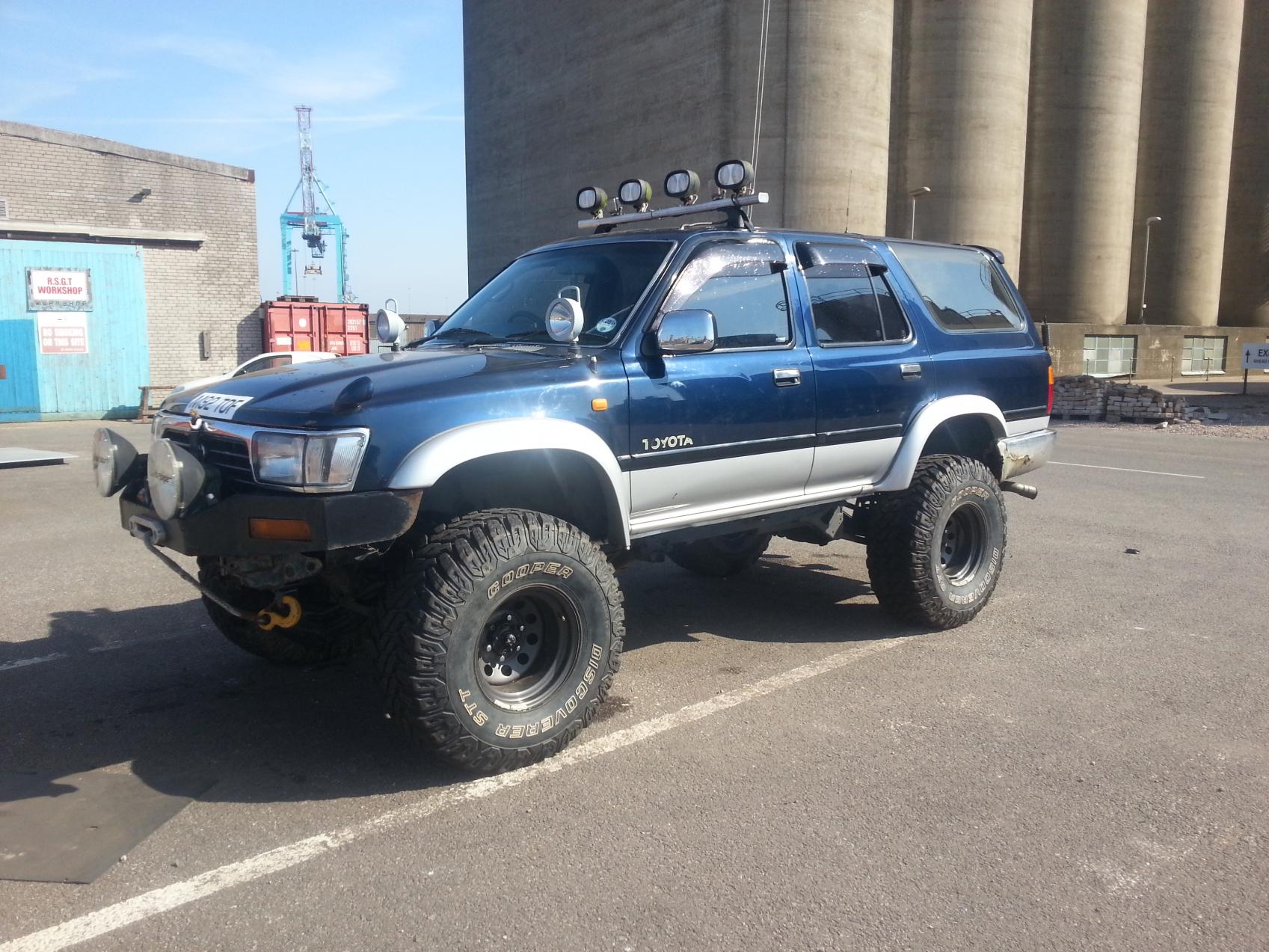

                      Managed to sort the wheels out a bit!
                      Used the adjustment on the wishbone I think it is, brought the bottom of the wheel out a bit but doesn't seem enough.
                      Might have to take some of the ball joint spacers out and wind the torsion bar up!
