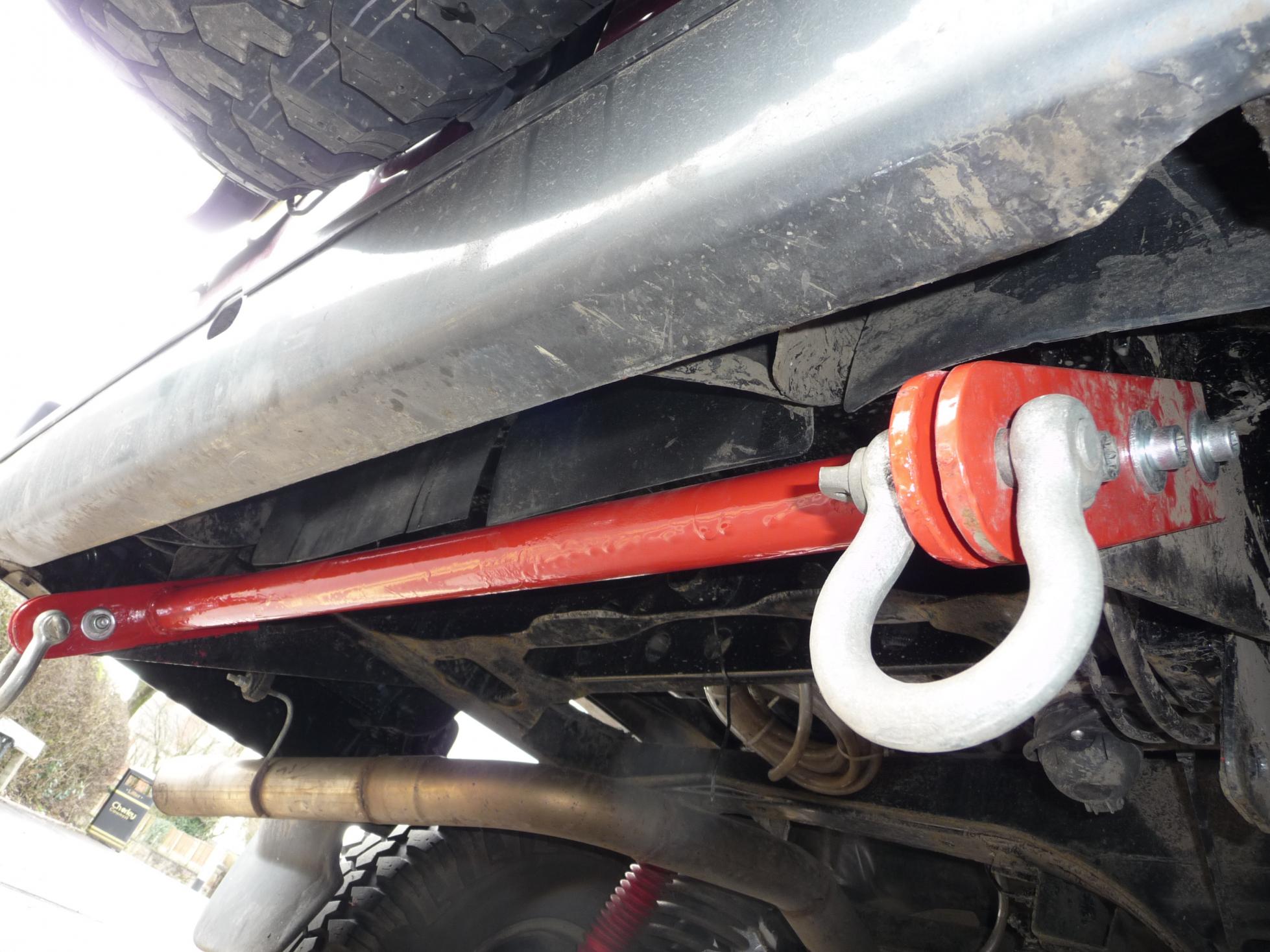

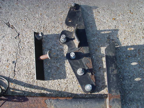

          Hey Matt. I removed my towbar because I just didn't need it. Instead, I used the towbar legs as somewhere to attatch some recovery points. Just in case I need to tow in the future, I retained the electrics by coiling them up and ty wrapping them to the chassis crossmember. I've kept the towbar centre section to re fit if I need it. putting it all back together is only a half hour of a job anyway.

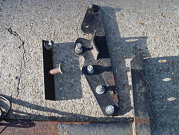

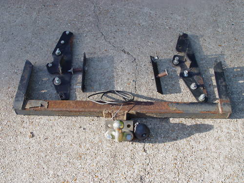

              Once you have separated the electrical connector plugs ( I've seen people attatch them permanently to the rear bumper ), it's only six bolts. Here are a couple of pics of a towbar, removed, to give you a better idea. Also a pic of the recovery points that I replaced my tow bar with.
                  Thanks for the pictures MWS, I'll have a look at mine next weekend and see how feasible this is for me.
                  When you say separate the electrics, presumable I can just unscrew the trailer plug thing and tuck it away somewhere?

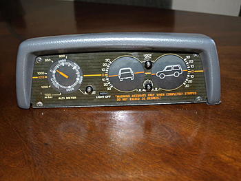

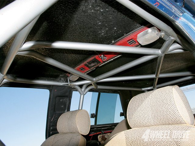

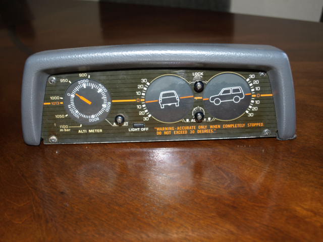

                      If your trails are that extreme then perhaps you might need one or both of these...
