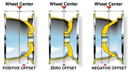

      Standard wheels have an 8 offset (not sure what that means) but if you get the aforementioned 10" rims do they need to be offset as well?
        Sorry if I'm not making much sense but the wheel size thing is all very confusing.
        The larger the -offset number, the deeper the wheels look.
        Surfs are -8, Landcruiser are -20.
        The largest off-set you can have on a Surf is -53 IIRC, but you'll need at least 4" of lift other wise you won't be going 'round corners without the tyres rubbing.
        Off-set is the measurement from the centre line of the wheel to the actual mounting face. The higher the negative number, (-) the further the outer edge of the wheel is away from the centre line of the truck. (Deep dish)
        The higher the plus off-set number, (+) the closer the inner edge of the wheel is closer to the centre line of the truck. (Centre of wheel closer to the outside edge of the wheel)

          Thanks, that make sense, I think...
