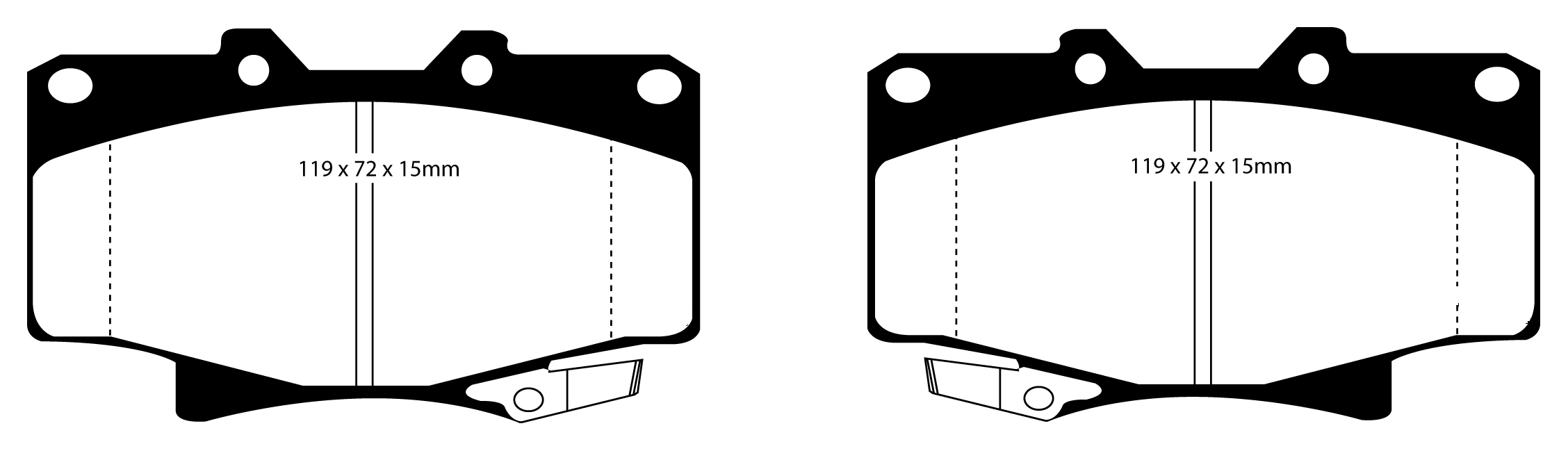

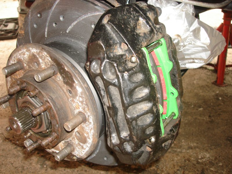

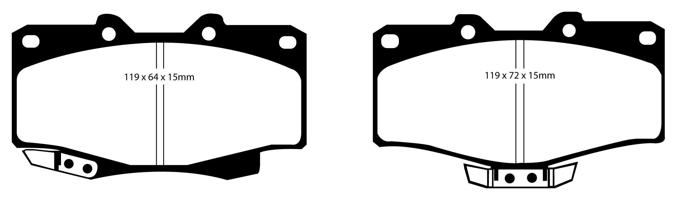

I've been looking at greenstuff brake pads, and found the part number you posted here. You used DP6807 which I think was for the smaller pre 1991 discs. My question is did they fit properly or have they left a ridge around the edge of your brake discs ?
I thought I needed DP6992 for the bigger discs ?
