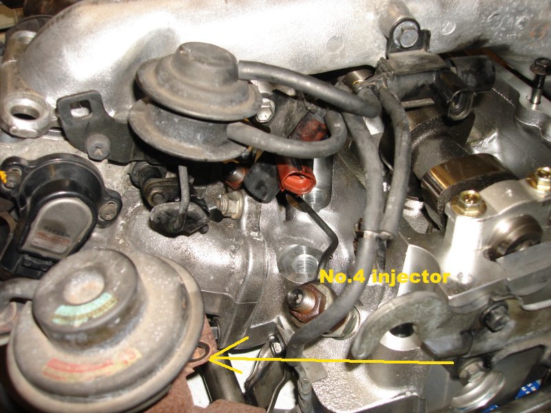

    The egr pipe goes from the inlet manifold to the exhaust manifold. It sits between the back of the cylinder head and the bulkhead. You'll need to remove the ally turbo - inlet pipe and probably the throttle body to get a good look at it on the inlet side. It's under the lower of the 'ufo' shaped things.
    I've attatched a pic of it taken from the rear of the engine for you. The exhaust one is easy to find.
