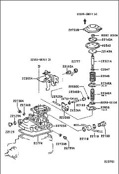

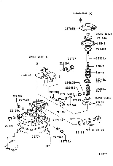

      Hey, Ady. Do any of these images help? Is your pump early type, or later EFI ?
      " Time wounds all heels ".
        It is a dirtier, leaky version of the one that Vince has pictured.
        It is just a bugger to find where it is leaking from, definitely not leaking from the top seal/s though, so it looks like it is going to be a pump out job?

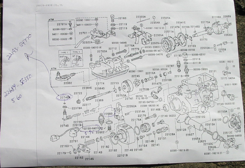

                My roughtrax kit had the distributor o ring in there. The one that was missing was the top sensor one.
