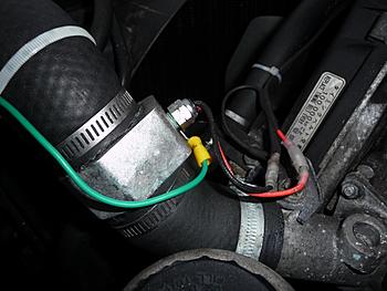

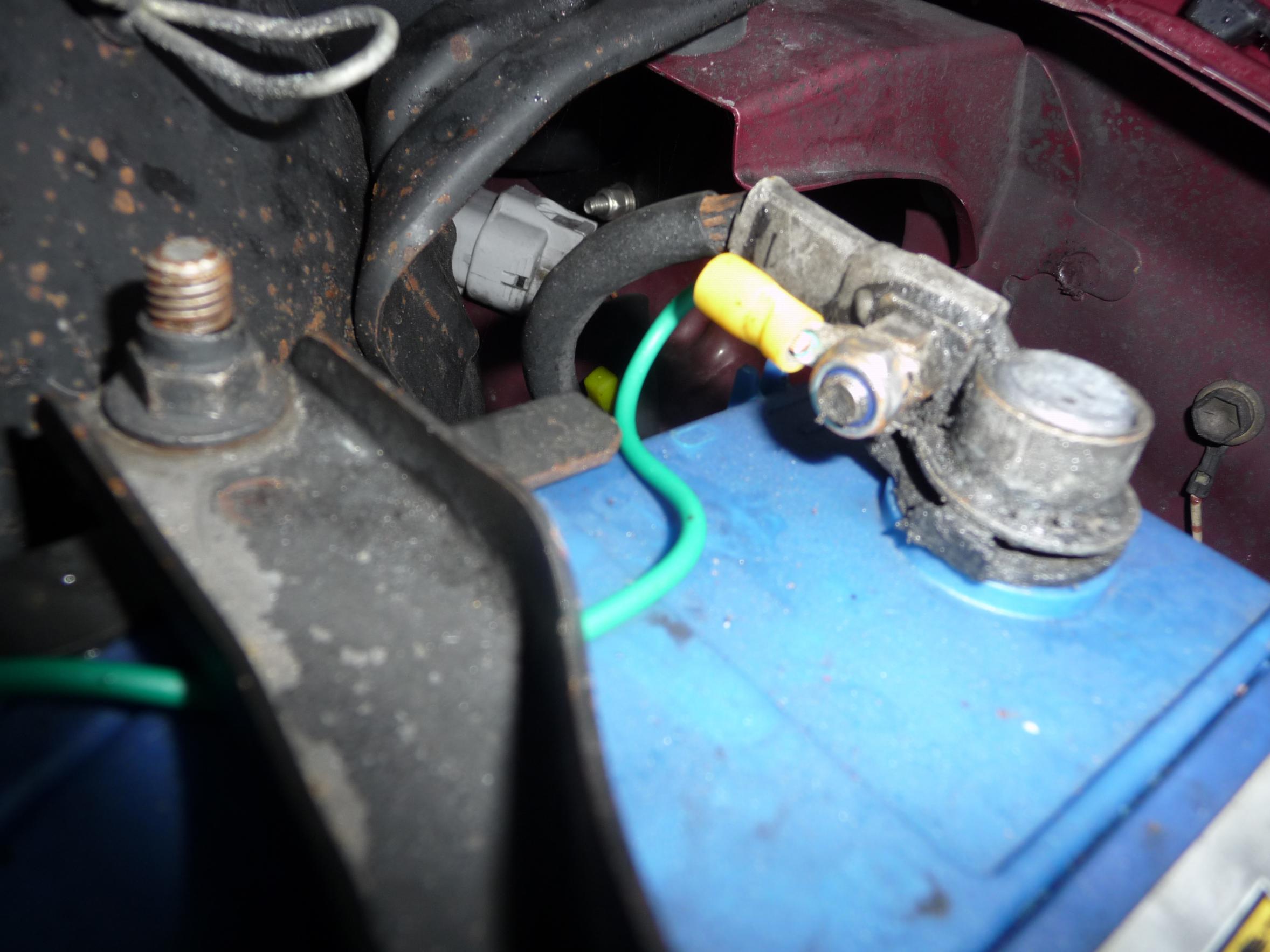

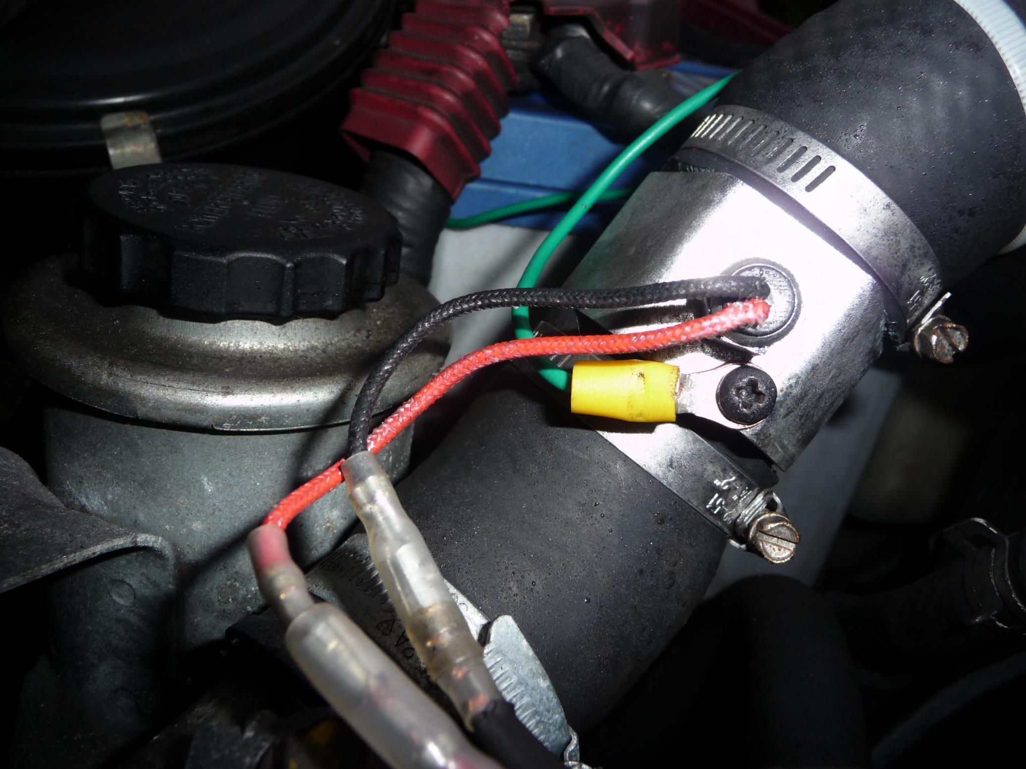

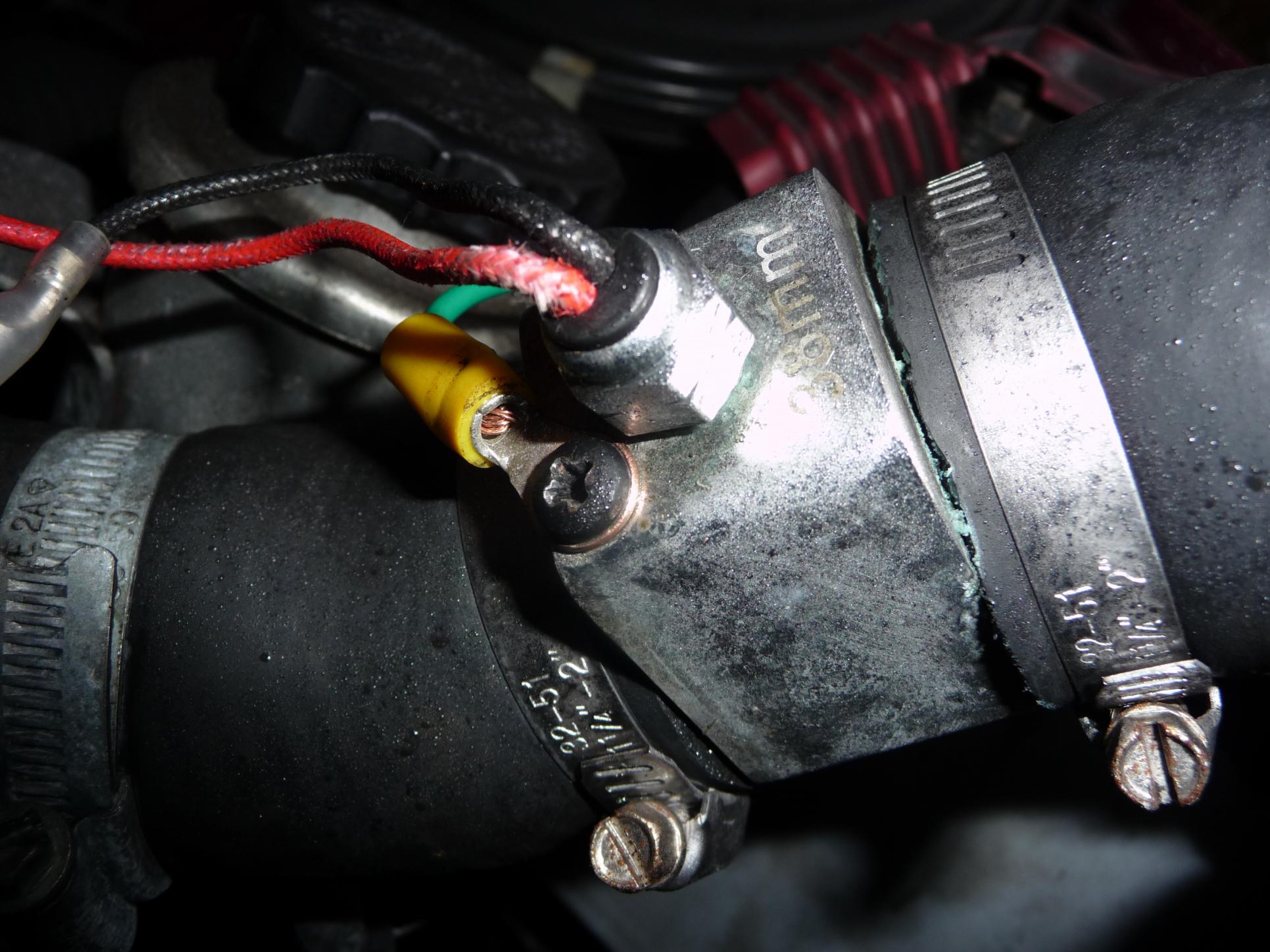

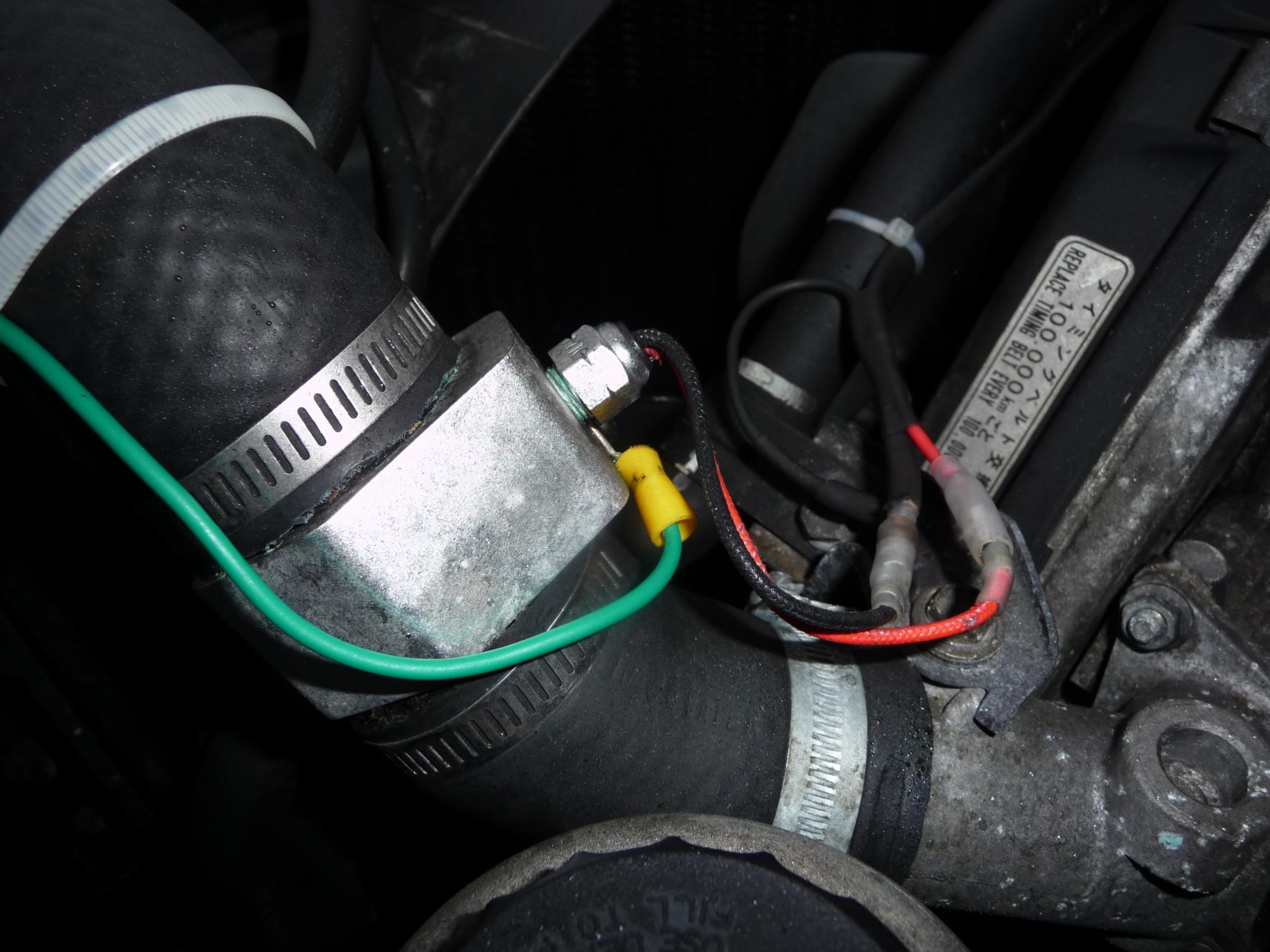

Hey, Dave. Did you order the same gauge that I got? Whe I ordered it, I also got an adaptor block. I assume it's similar to the one that Vince has offered you. Here are some pics. It's double earthed, on good avice from Mr Whacker, with a wire to the neg on the battery. Once you've fitted it, please let me know what temps you are running. I'm still only topping 73 degrees.Last edited by MWS; 2 January 2013, 21:15." Time wounds all heels ".
Thanks for that Mick, I think I have the same gauge, as mine was a lot cheaper I did not get the block, I have made one up and will post some pics. Ta.Originally posted by MWS View PostHey, Dave. Did you order the same gauge that I got? Whe I ordered it, I also got an adaptor block. I assume it's similar to the one that Vince has offered you. Here are some pics. It's double earthed, on good avice from Mr Whacker, with a wire to the neg on the battery. Once you've fitted it, please let me know what temps you are running. I'm still only topping 73 degrees.
