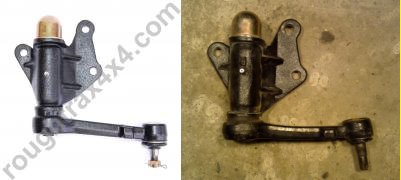

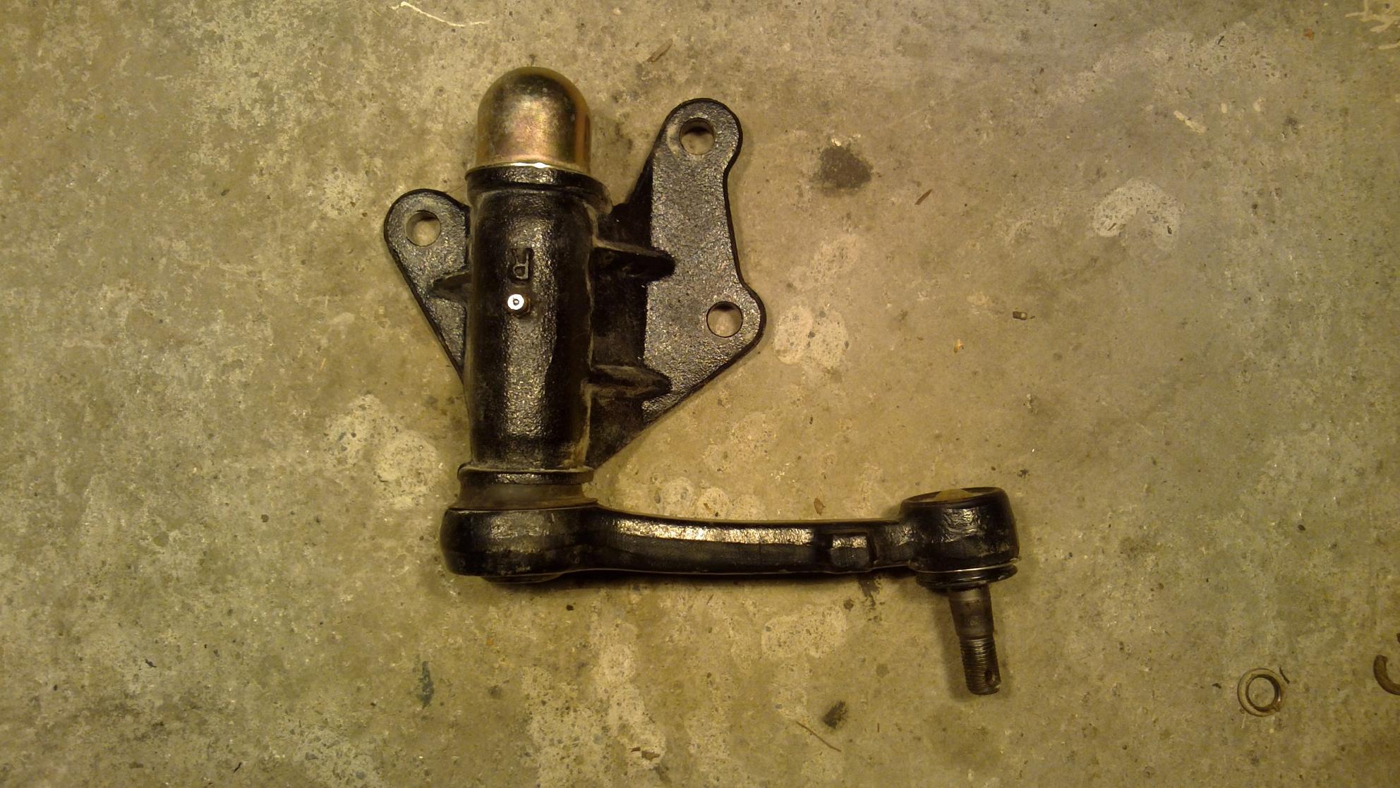

This fine example of an idler arm in the attached photo (note the upwards bend in it that causes it to rub on the chassis) is of my lovely wee smurf, and the idler arm itself is only 2 weeks old after the last one packed it in. I put this down to it being a defect and just replaced it again but as my luck would have it its gone again, only lasting 3 weeks this time
Now before you say im driving it like I stole it, im not, I have a rear air locker in it now so it happily idles over everything slowly and smoothly so what on earth is going on here for me to stuff so many so quick?
It has a 2 inch suspension lift (more like 1.5 at the moment as its sagged a bit in the last year) 2 inch body lift that shouldnt pay a part in this problem and 33 inch tyres but there are more of you with same size with no problems.
I am going to take this we sucker into work tomorrow and weld a brace onto it and see how I get on seeing as its only 2 weeks old and just bent so no other problems with it.
But I need to find the cause first as if this is strengthened its only going to bugger the next weakest link in the steering untill I find the cause.
Long story short, has anyone else had this problem and knows whats going on as im stumped

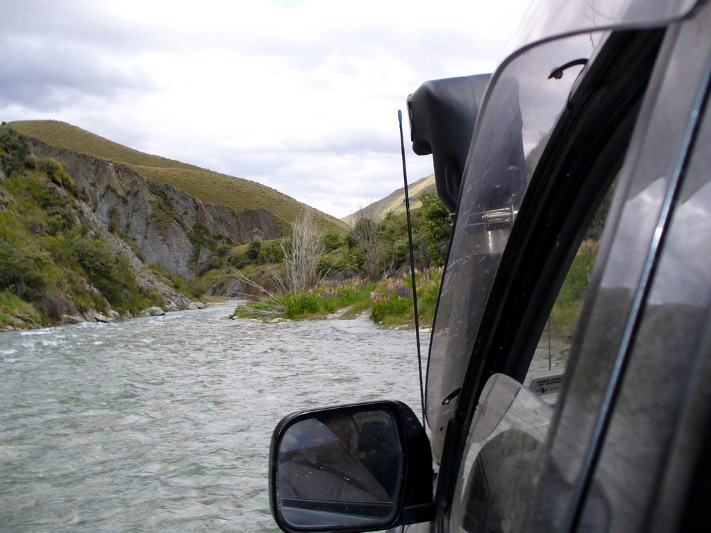

PS: attached photos of its last trip as you can see its nothing major or extreme on this trip but this is the trip that bent it. Just about 50 river crossings over 3 hours. Awesome track but a snorkel is a must as it pops over the bonnet a few times
