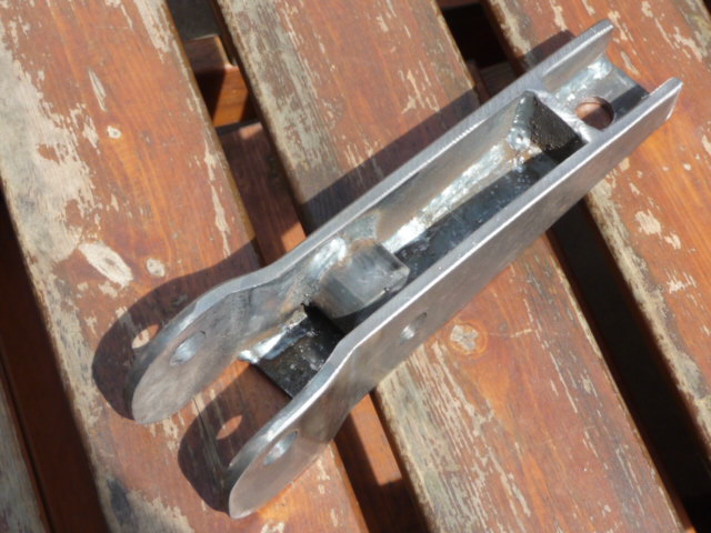

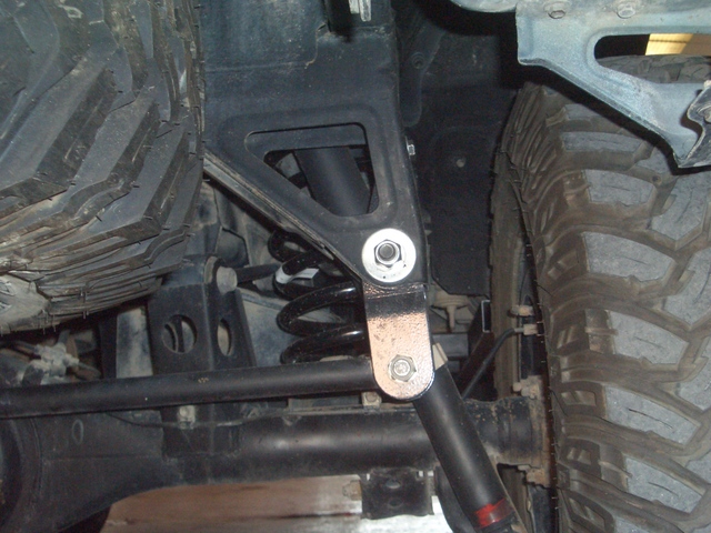

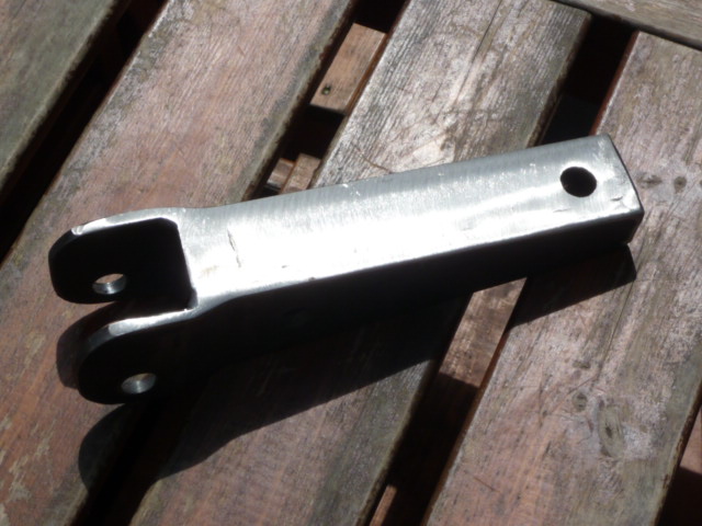

It's nothing to do with the UJ's if the front hasn't been lifted. Best advice is to keep the panhard rod reasonably parallel to the axle. This is best done by using a "Panhard rod drop bracket"....See pics.Originally posted by muddle View PostNo not really, the UJs can handle it no problem, its best to get it centred but aslong as the UJs are greased up, it wont harm.
They move about more when you drive on a road anyway.Attached Files" Time wounds all heels ".
