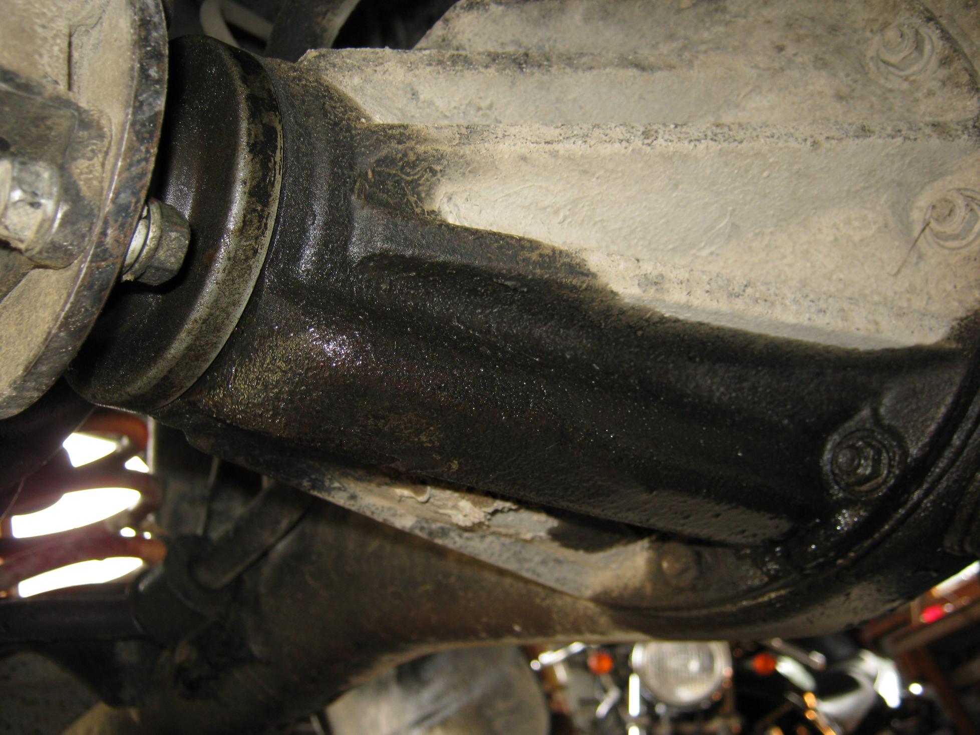

    My rear diff has been whining it arse off for the last few months, and then whining AND leaking, and now no more leaking (no oil left)

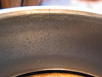

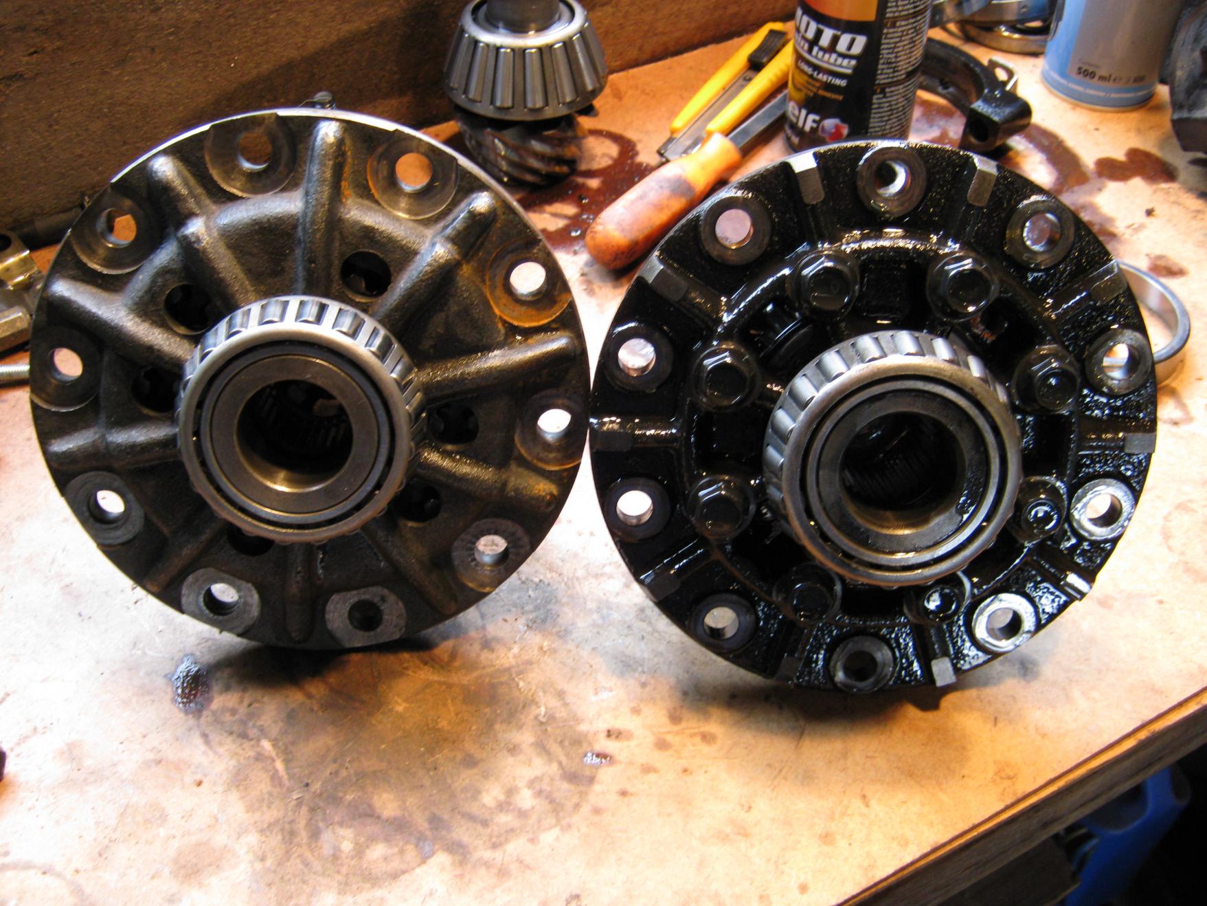

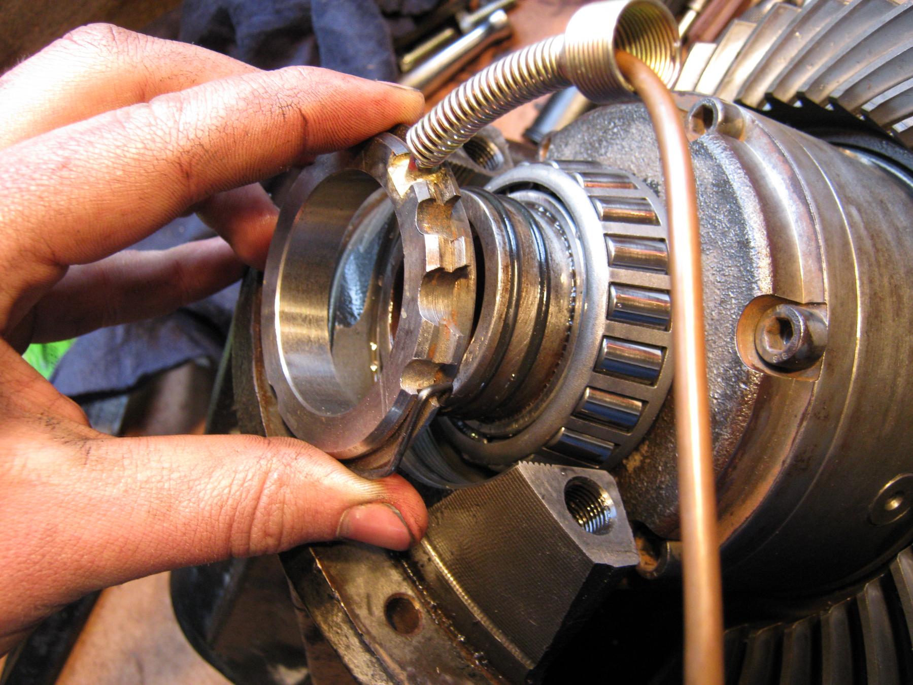

          And if anyone wants my opinion, if you can afford the genuine ARB locker instead of these chinese copys, DO IT!
          The quality of this locker is rubbish and I have no doubt that it will be coming out again very soon for repairs.
          the casting quality is extremely poor, I had to purchase new o-rings for it as the supplied ones didnt seal in air, the crown wheel is "wobbly' due to the casting so I will only know how badly this is going to affect it once its installed and running (tomorrow I hope)
          I took a gamble and bought a cheap chinese locker, and it hasn't paid off.
          But it has been a fun learning experience anyway and the diff bearing were shot so it was already coming out for repairs anyway so no big loss to me.
          Will update you all tomorrow when its installed and tested

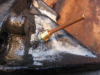

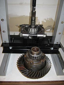

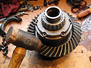

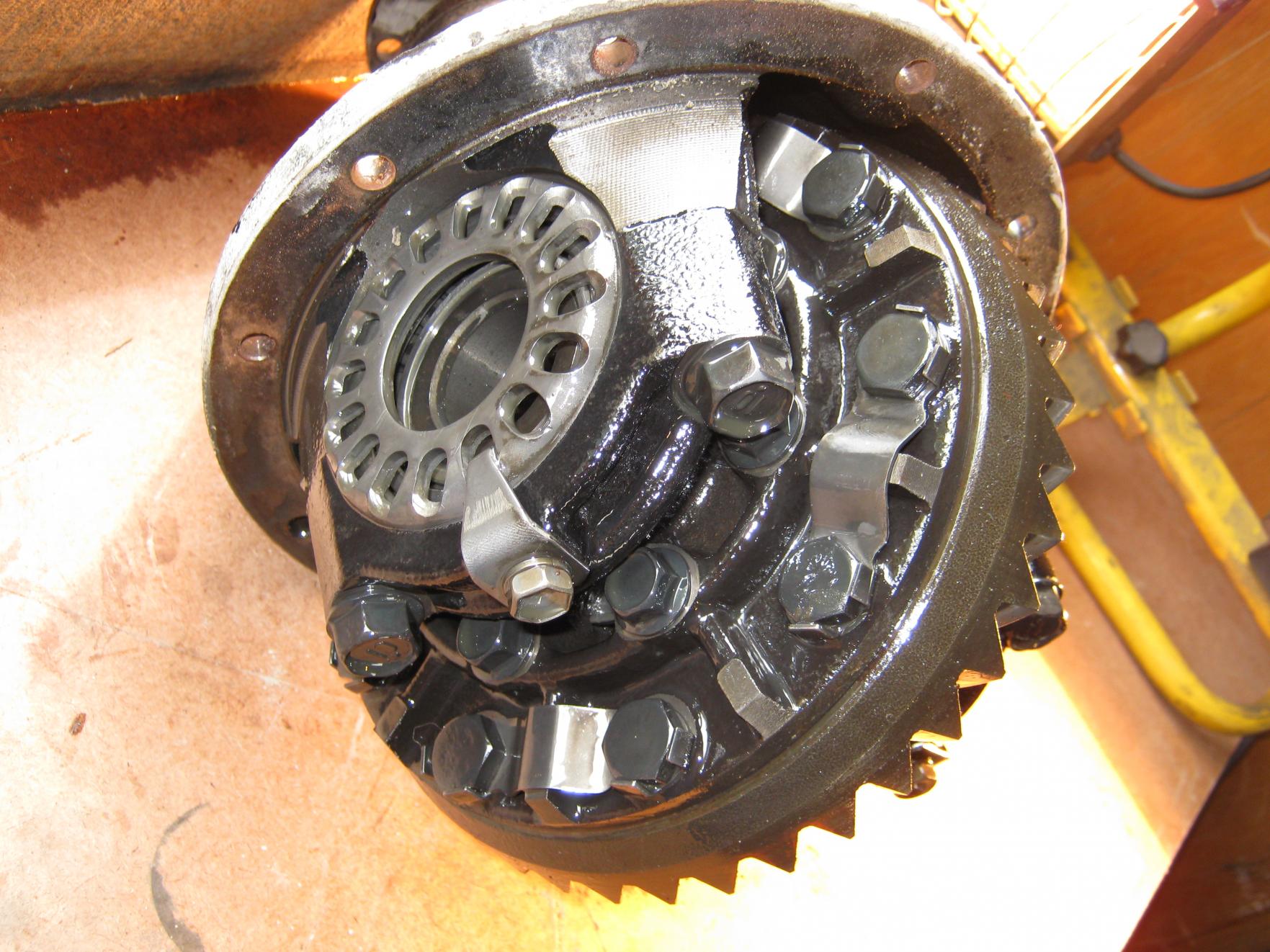

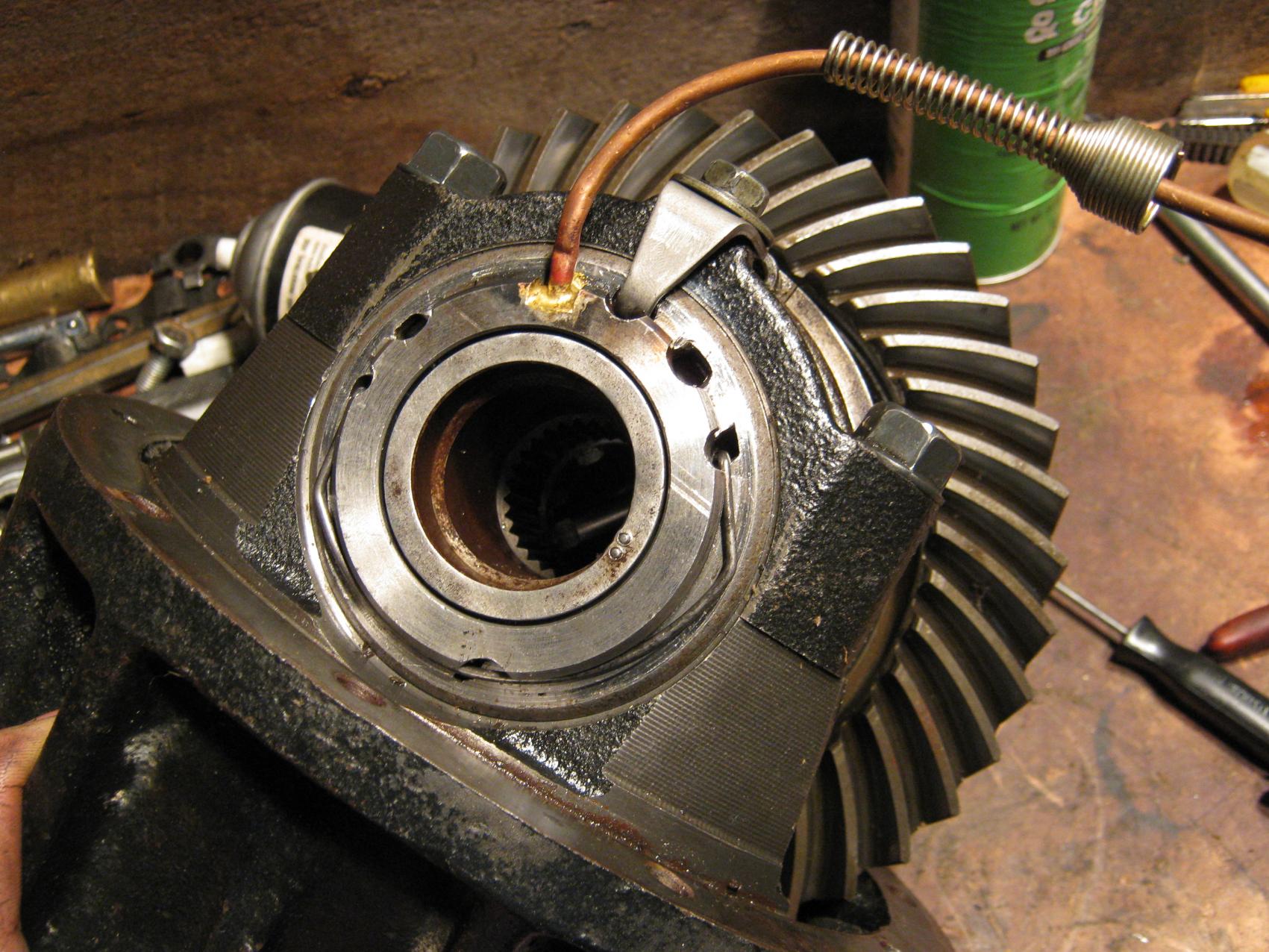

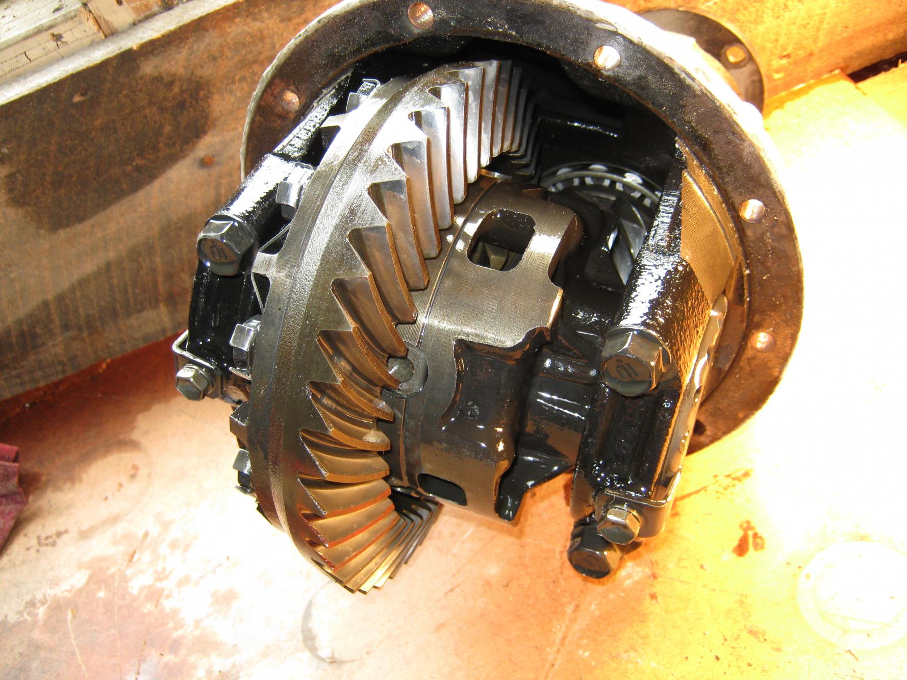

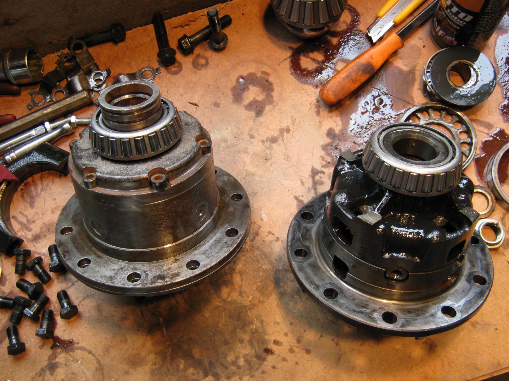

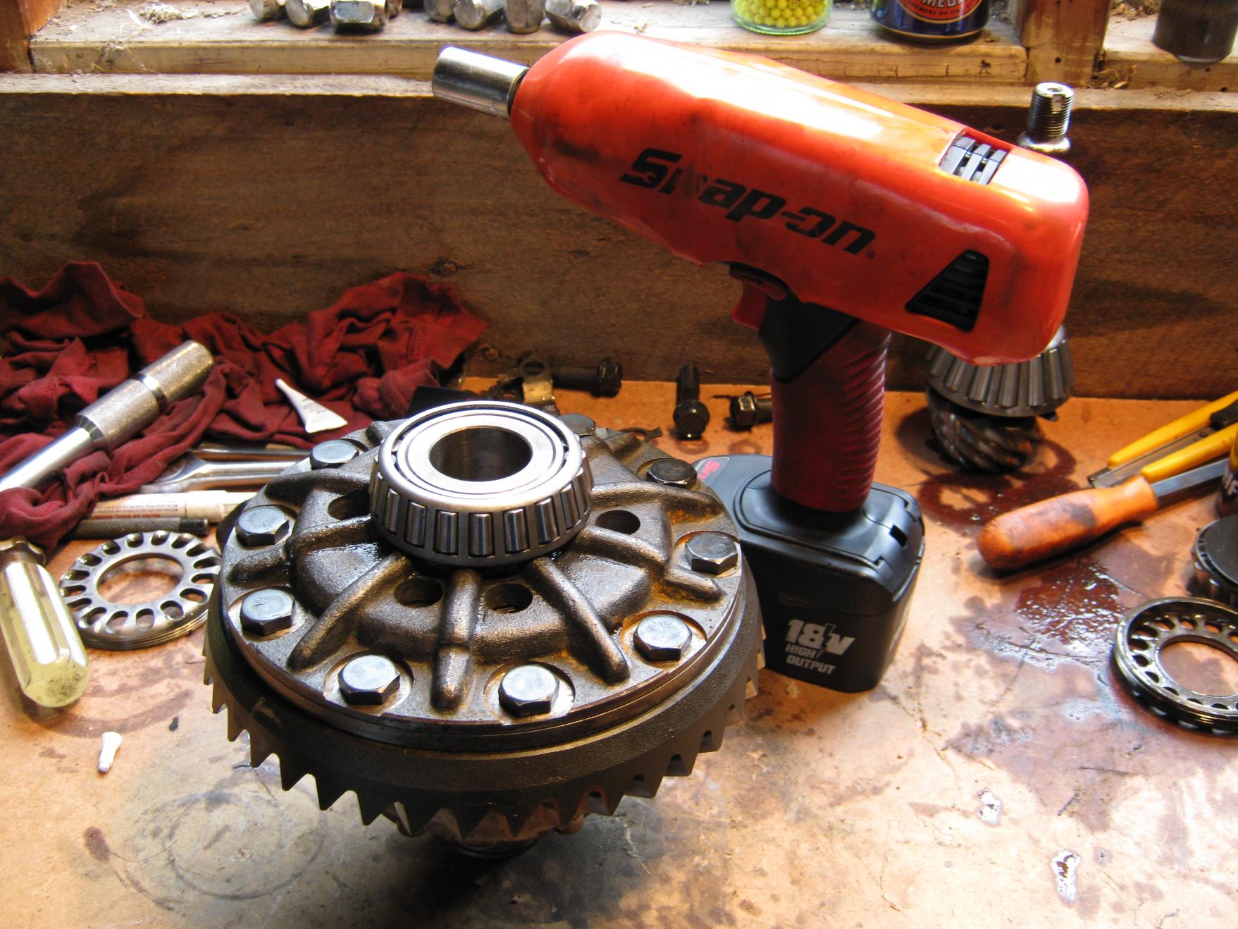

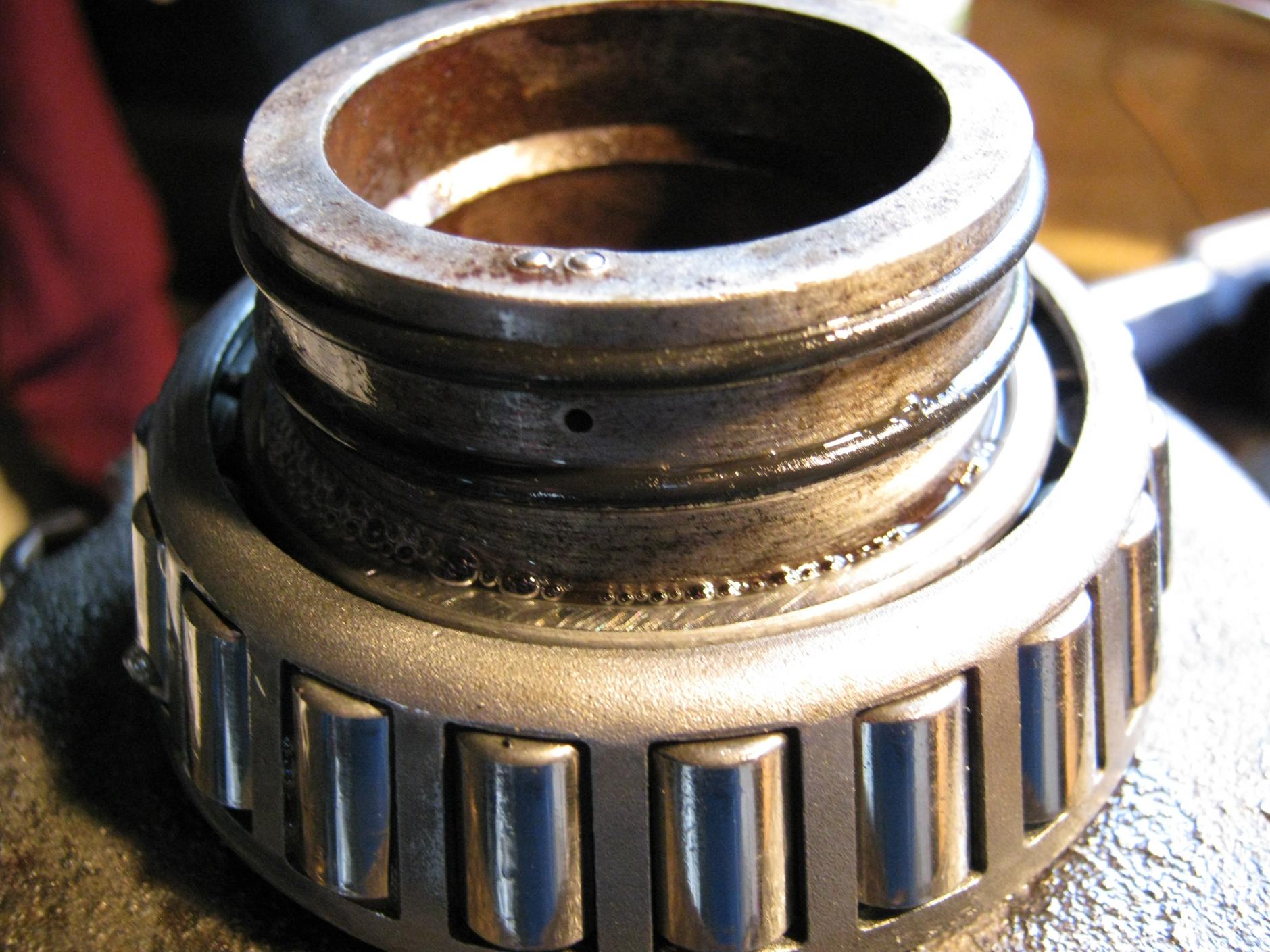

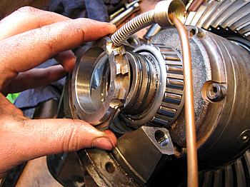

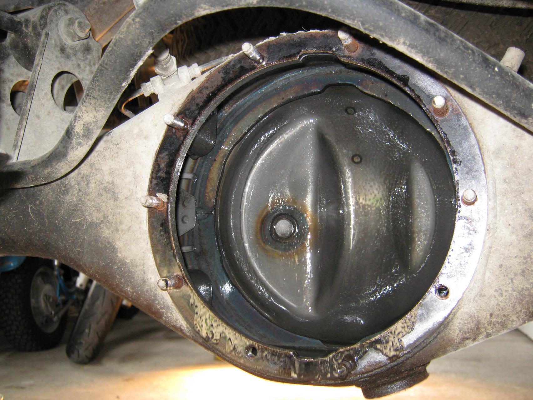

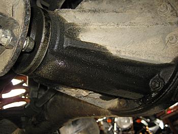

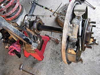

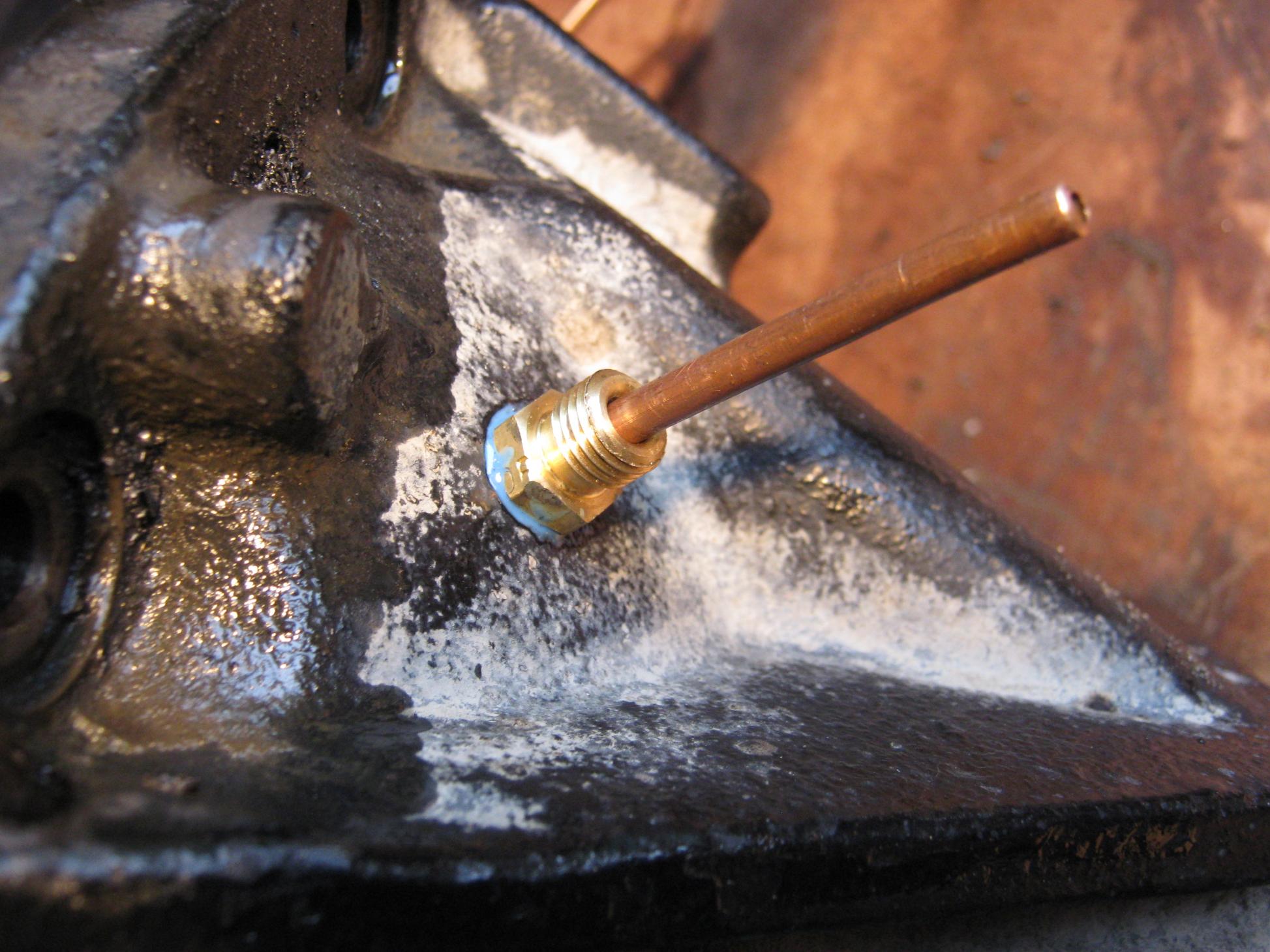

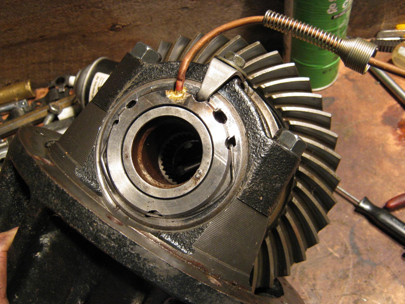

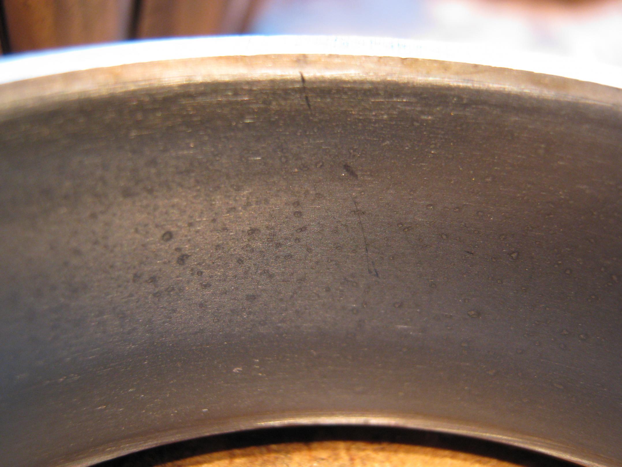

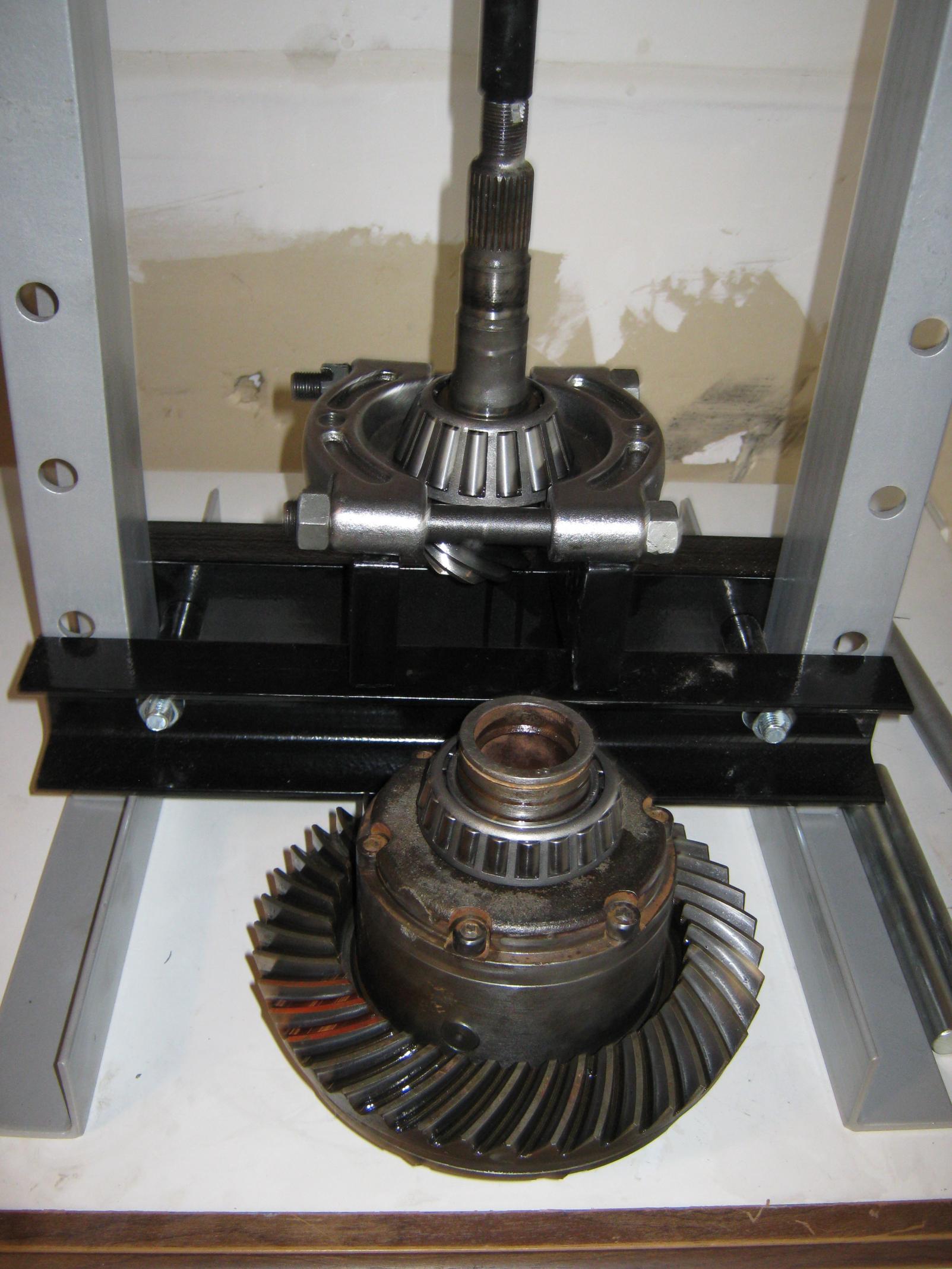

            Well I cant be bothered writing up about it, and that previous comments link is way better than what I could ever write up, so heres some pics, and I can happily say that any future diff work is going to be sent away instead, that was not much fun
            My pinion bearings were that well stuck it took me 2 hours just to get the big one off, involved a gear puller, then a press and then a lot of heating to get the sucker to pop off.
            Anyway done now, just have to test the locker tomorrow with works air supply as my compressors not running yet, (I opted for an engine mount compressor and havent made bracket yet)
            Lets just hope it works as I dont want to have to remove everything again

                well I hooked it up to the workshops air supply today, it actually locked
                Will have to get the compressor rigged up and take it for a spin now and see how much more trouble I can get my self into now, really need to get a winch hooked up now as with a locker I suspect that when im stuck now it will be beyond a tow strap pull kinda stuck

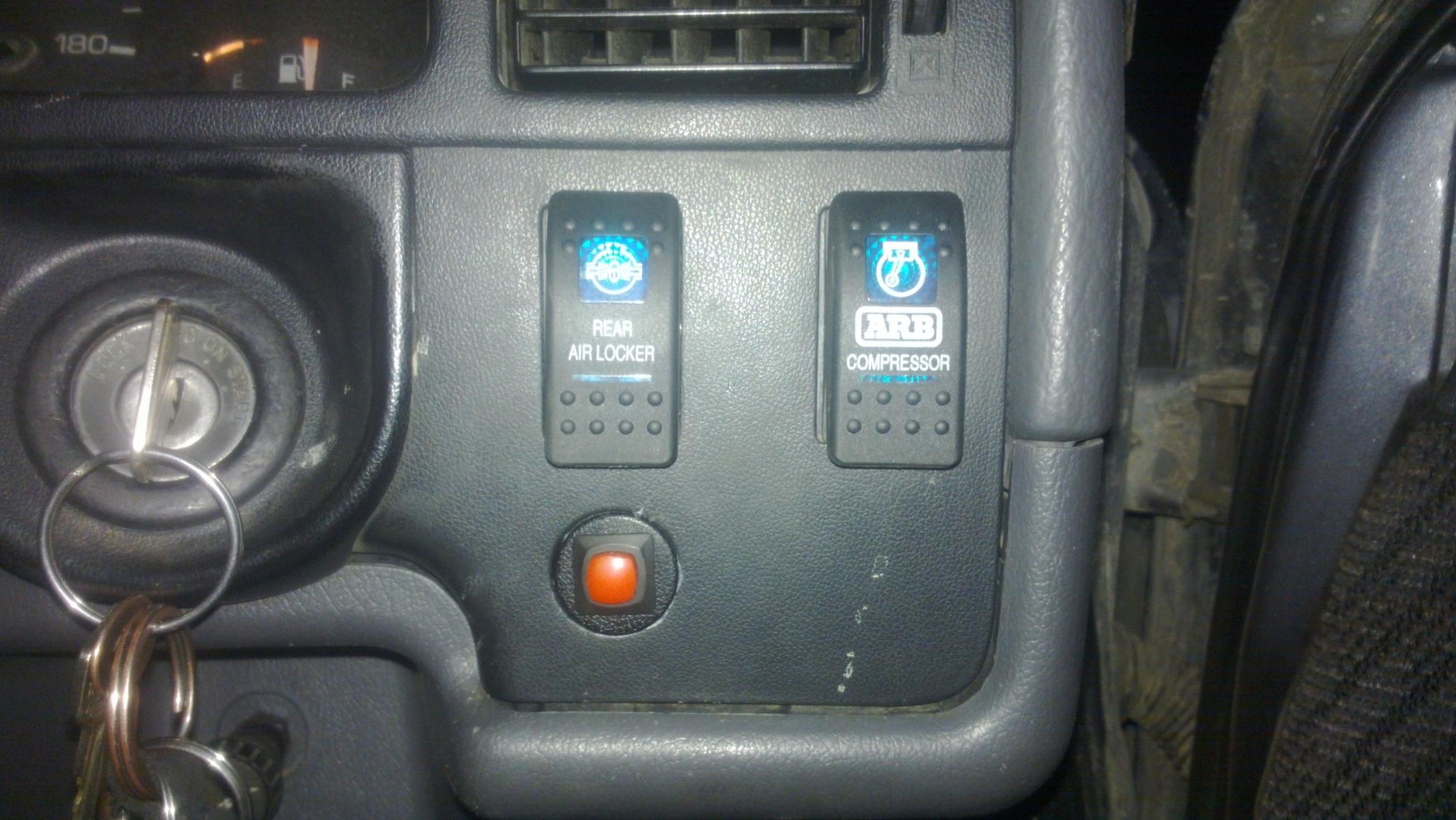

                  Just a small addition to my original thread,
                  Finally got off my lazy behind an installed the air compressor and lines this weekend and took it for a spin.
                  My word its like the difference in being in 2wd then hitting the 4wd button but in addition to already being in 4wd!
                  Its crazy what the old surf can do now, all it needed was a locked up rear end and its darn near unstoppable, mabey a front locker is on my mind now
                  And ill have to say that if you can afford the selectable locker go for it, handy to know that if you get stuck in 4x4 you always have the locker to select to pull you out, if your stuck with the locker on though (or non selectable type) your only hope is probbly a digger as you must be in something stupid and sticky
                  Thats my 2 cents from the other side of the world, ta ta peoples
