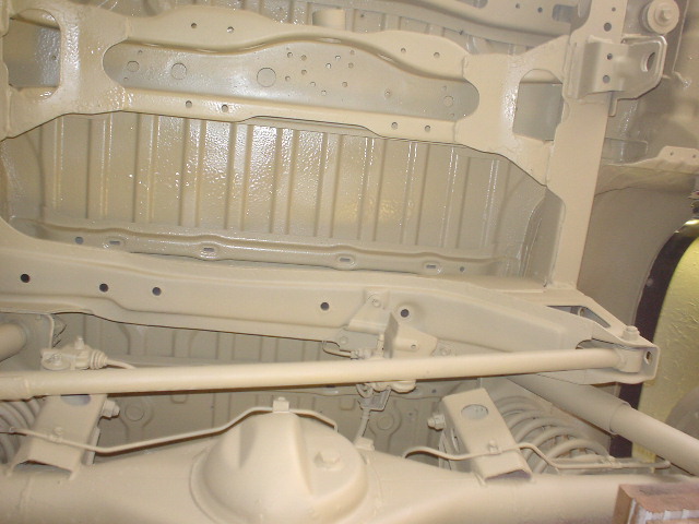

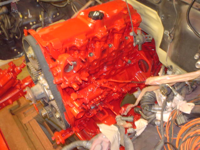

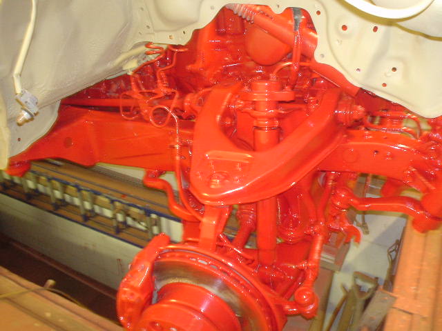

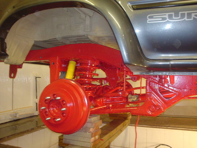

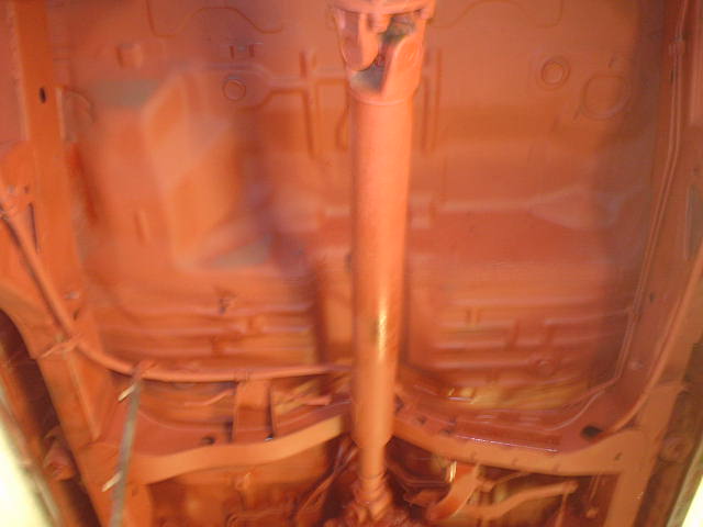

Not sure about 3rd gens, never had one apart but i guess all parts are removeable, it takes a lot of cleaning tho, best bet is steam if you have a co nearby that can do it, i had to use elbow greaseplus a cut up waxol gun piped up to a big tub of hot soapy water, also applyed plenty of degreaser first, i got two 10lt tubs of it, some old stiff paintbrushes, wire brushes etc, its a bugga of a job, after that the painting is fairly easy, i hand brushed all the back end of the chassis after spraying on the red oxide and underseal but got fed up with brushing, on the forward end i masked up all round the engine bay and just sprayed away till it was covered,
hammerite is great, those pics are about four years old and the stuff is still on there, a bit grubby now but still looks ok, stands up the heat as well (on the engine), basicly you can paint all over everything, although i did mask all rubber brake hoses, the paint flaked off cv boots etc as expected, only prob is the price of hammerite and underseal, i had to pay for the red but the underseal i borrowed
