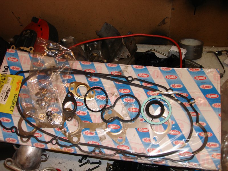

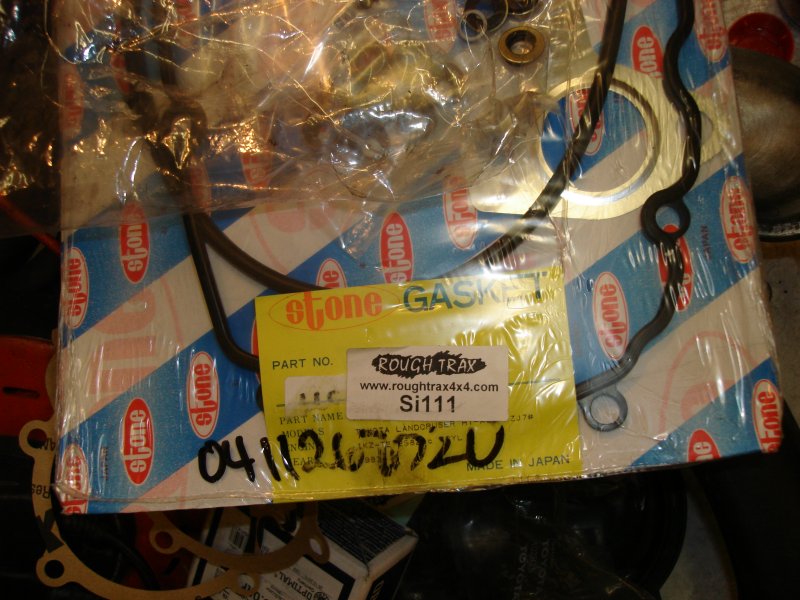

            Here's some of the set I received (a few months back now) I've used the inlet manifold gaskets, water -> rad gasket,and the lower gasket on the throttle body.
            I re-used the Toyota exhaust gasket as it's 4 ply and the replacement is 2 ply. When you put a straight edge along your exhaust manifold you'll see why you want a thick gasket in there
            I've got a set of injector nozzle washers spare you can have if you're desperate, but I guess post will make it pointless ?
            Tbh Most of my old gaskets were in good order and I wouldn't have been too worried re-using them.

              Rob thats really interesting,
              Thats not the kit I got at all. My New Exhaust gasket was a 4 ply one,and yes your correct,most of the old gaskets were in good order ,but no one re-uses injection nozzle seat gaskets,in fact they are marked in the manual as throw away and replace.
