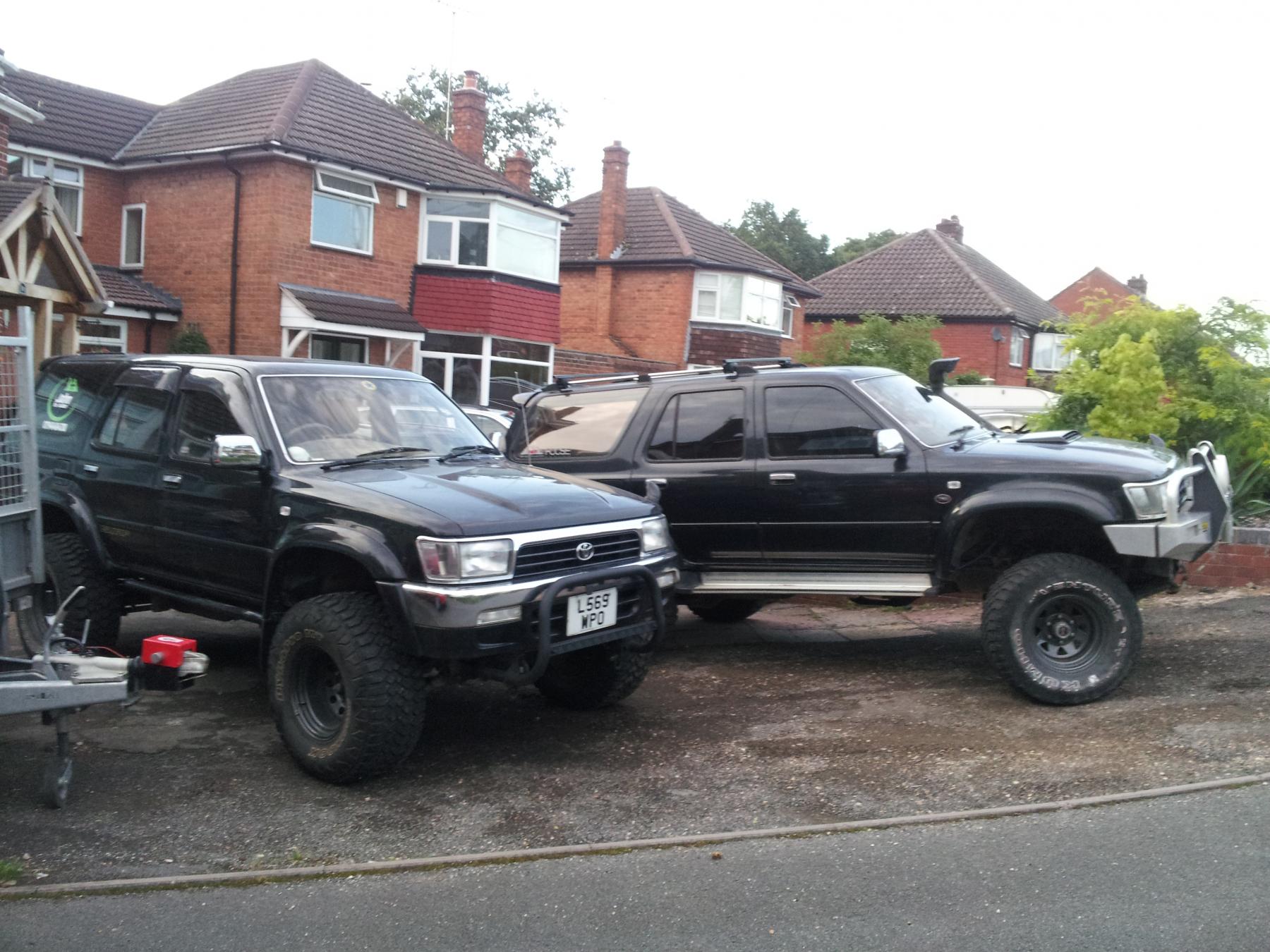

Anytime you want, although number 5 is still feeeling sick and keeps throwing up PS fluid every where
Thought I'd sorted it a week back but went to pull it out today and had another big puddle in the garage.
Going to strip front end out to try and see what is happening in next week or so.

it did that to me when i had it - after working on it there must have been air in the system - try jacking the front wheels up and with the engine on idle move the steering from lock to lock - it takes a fair few turns to get all the air out. it the looped pipe on V that has the sneaky bubbles in it.Originally posted by Growler View PostAnytime you want, although number 5 is still feeeling sick and keeps throwing up PS fluid every where
Does number 2 still have the winch fitted ? if so I could do with looking to see where the oil coolers are mounted on it
best of luck
