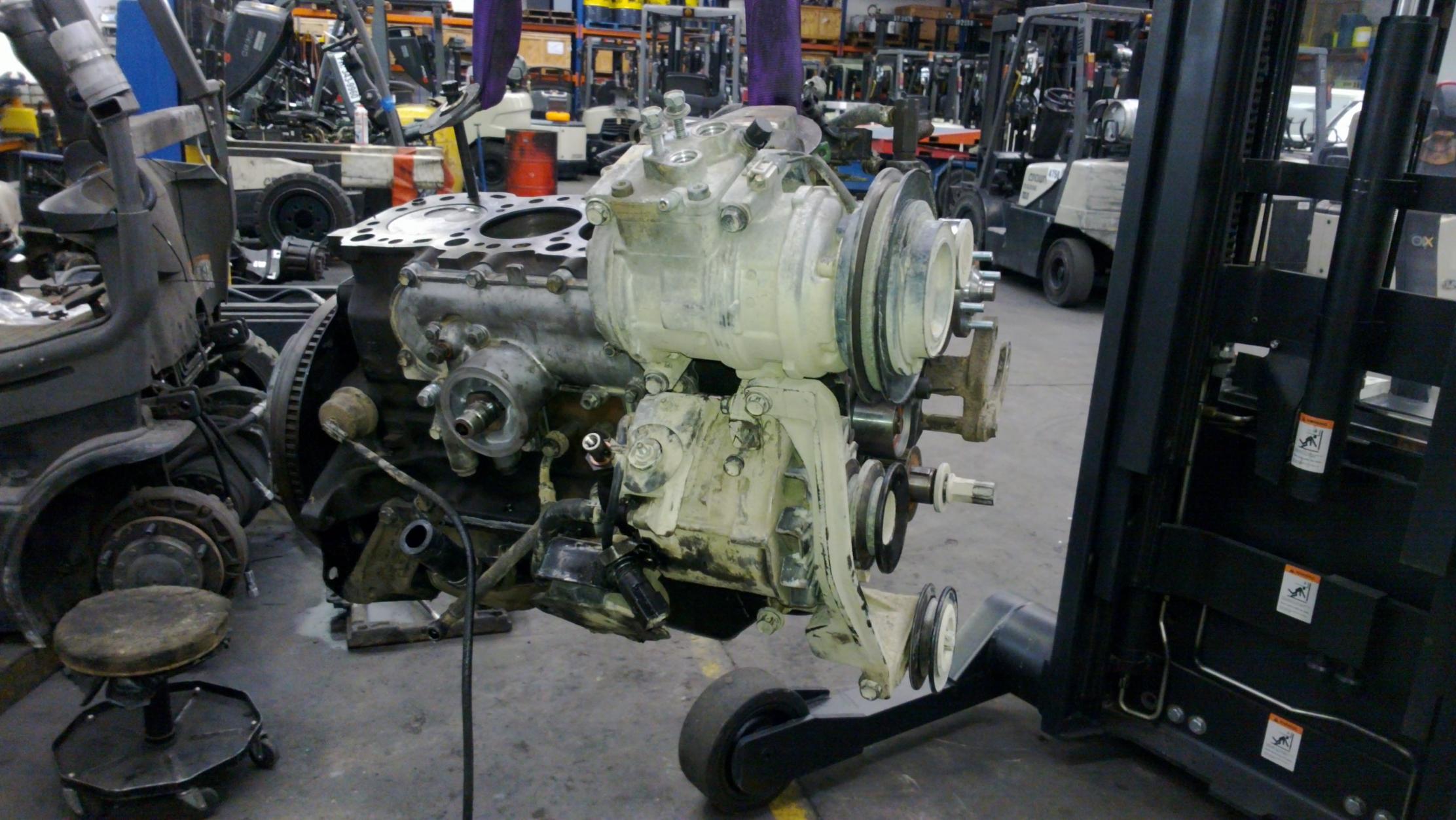

    Good luck with the swap
    My tip would be to take off the bonnet and use one of your fork lifts for the lifting.
      Thats exactly why im doing it at work, to lazy to use an engine hoist after realizing how fast it is using a forklift

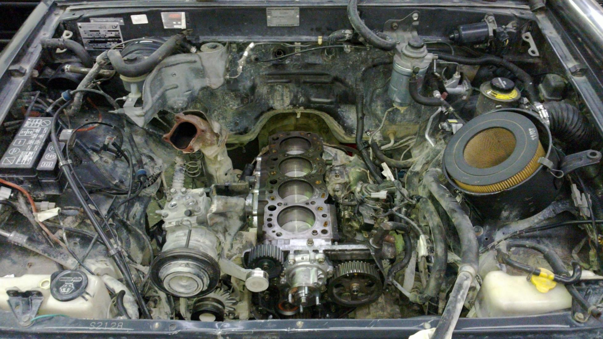

          Im close I can almost smell the diesel, heres a sneak peak anyway.
          You can tell the new block and parts from the old muddy parts pretty easily

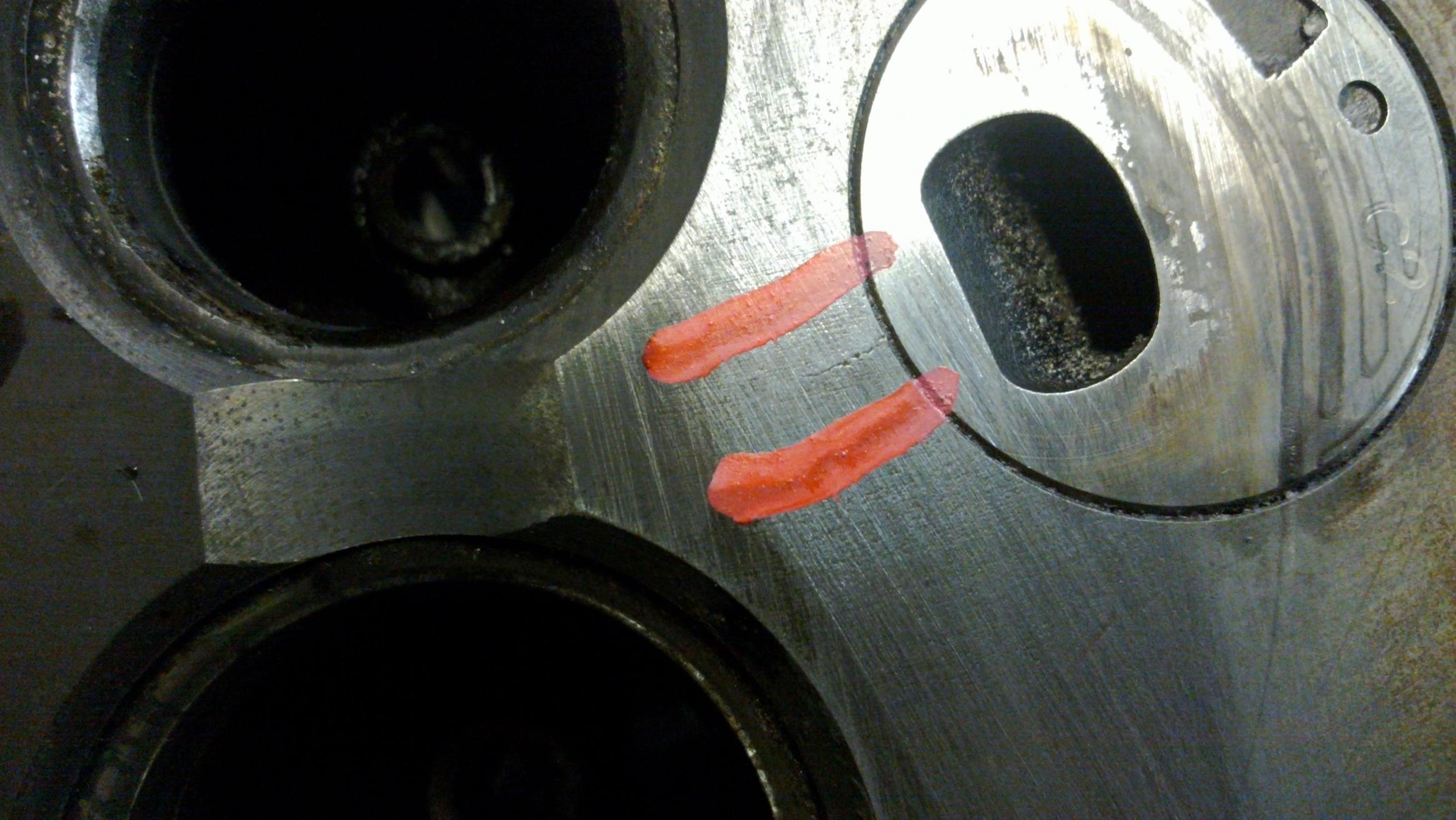

            Well looks like the 2.8 wont be finished for a few more weeks now as I have to wait for a new head to be delivered.
            Kind of glad I had the head pressure tested first before the head was recon as I never would have noticed this we sucker. Only found once we took away a little surface from the head.
            The real bugger is that its not big enough to be leaking yet and theres no contamination in the coolant or signs in the engine, but no point putting it back on and stuffing my new block when it does eventually give enough to leak.
            Oh well add me to the cracked head party
