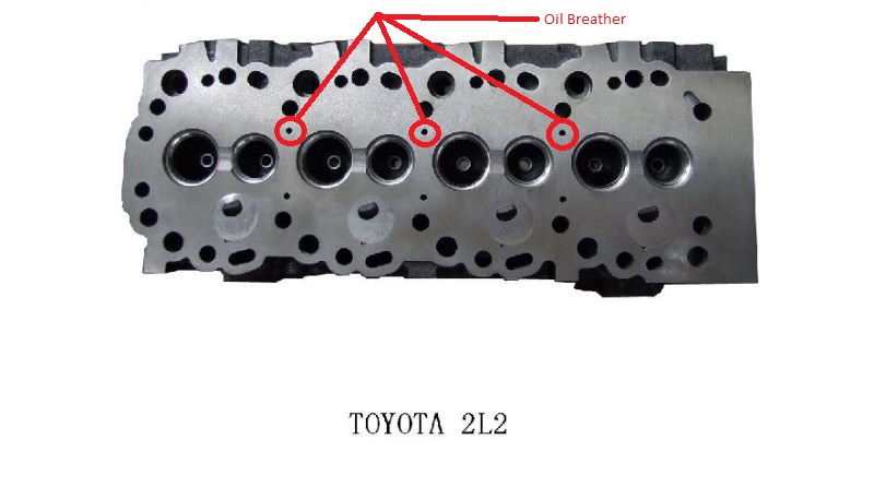

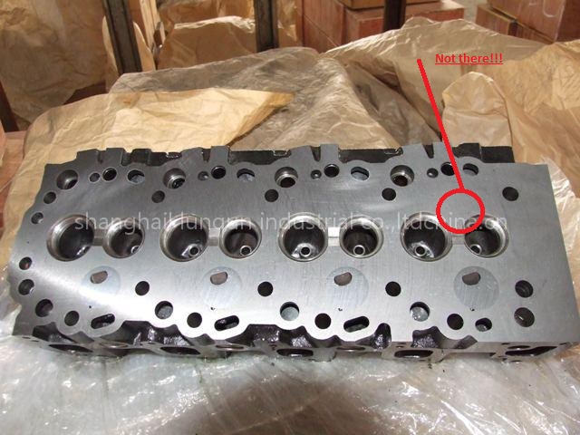

If you are still following my old post I have now got my 2.8 short block and gaskets and seals ready to install in my surf BUT,,,,,
Official word from toyota is the head from my 2.4 will fit the 2.8 shortblock,
same size and same valves but the only possible difference that will
make or break the game is the two small holes in the block that only
some 2.4 heads have or possibly only 2.8's
The holes ("hole" bottom one is a blank) is an oil breather apparently
Long story short is my heads been replaced and I dont know what it has,
holy head or not?
How do I tell without taking the head off or is it only possible with
the head off, I know its a tall ask and probbly know already that its impossible to know without taking the head off, but if I can save me the $150 cost of a gasket in finding out without removing the head im all the happier, and I could order a new head $800!!!!! but saves me having to order one and wait for delivery if I do end up pulling the head off and finding its wrong.
Anyway Ill stop rambling on, heres the pics and yes both are a google image search of 2.4 head, hence my confusion as to if they exist or not!
What do you all think? Im trying to avoid the cost of having to buy a head unless I have to
