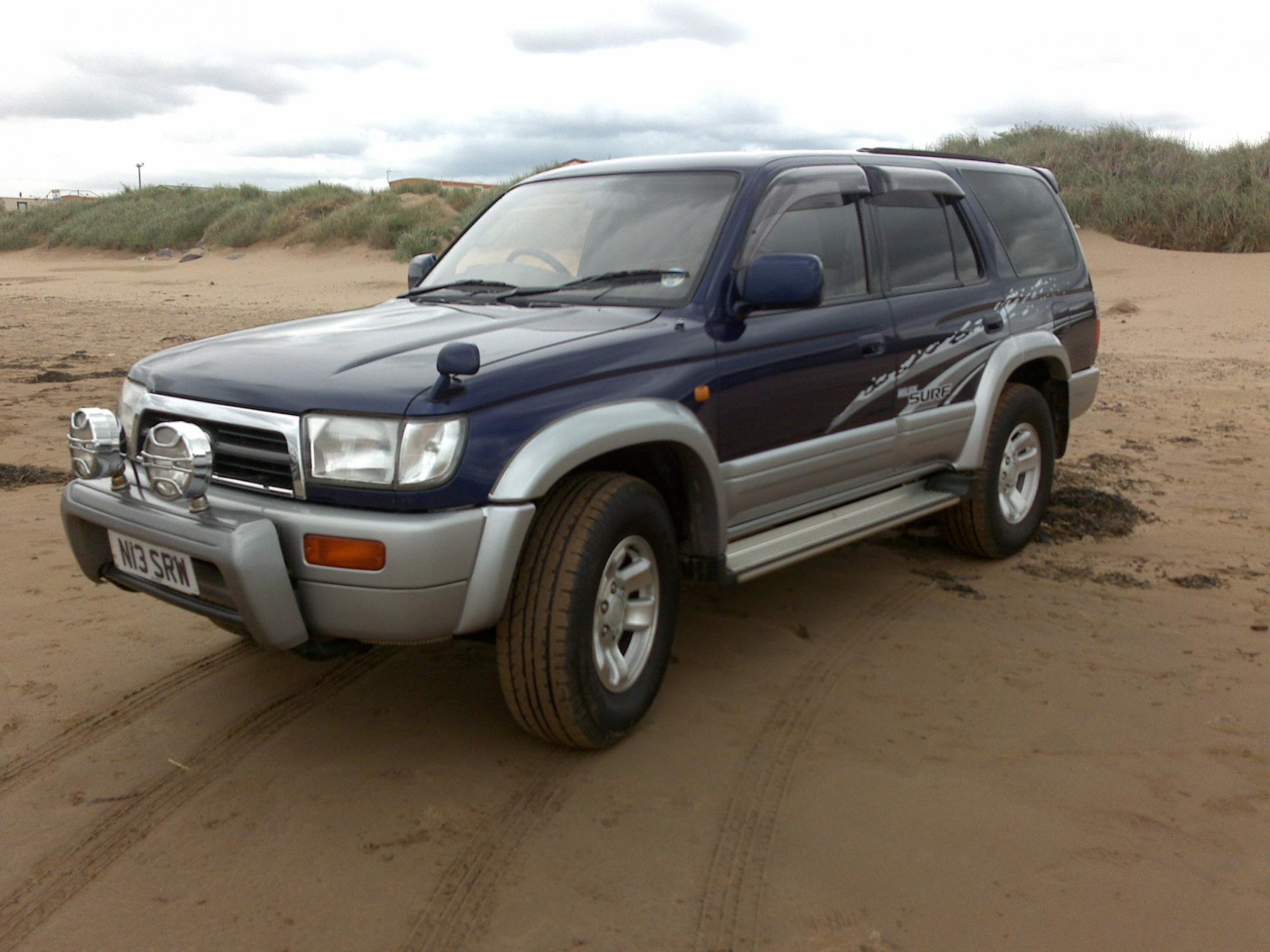

    Does the wiring loom in a 3rd Gen Surf have connections for fog or spotlights? I bought a pair of Baja spotlights from Roughtrax and they need fitting. Thanks.

                      Diagram makes sense although I will only require one relay for two spotlights. My problem is the physical side and locating the current relay and wiring. Also I need a big socket wrench with a long extension to get to nuts on the current spotlights as they sit on top of the bullbar as per the picture.
                      Maybe better to spend £65 getting the spots fitted by an auto electrician instead of buying a sockets et and then battling to do everything myself.
