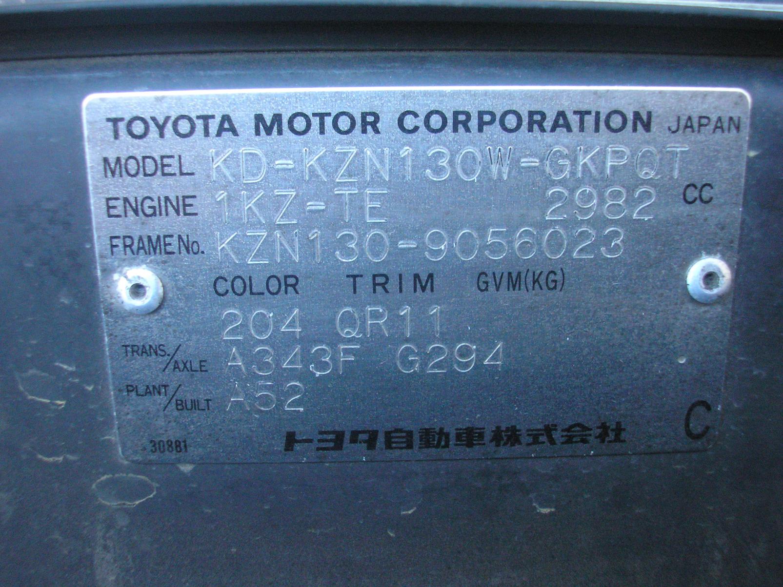

                  Heres a picture of my old VIN tag.
                  Most of it is self exalpanatory
                  Trans=transsmission in my case auto with overdrive
                  Axle=G294 open diff G295 Ltd slip diff
                  Can't help with the colour,and trim codes other than tell you mine is black with black/dark blue interior.

                      thanks for your answer, but this is a 2.4, so i will be different code, or...! , im wrong,...
                        Yes it will!
                        Model No=KD-LN130W (N if you have'nt got the wide body version,unlikely)
                        The rest of the letters after the model no are B/S
                        Engine No 2L-TII
