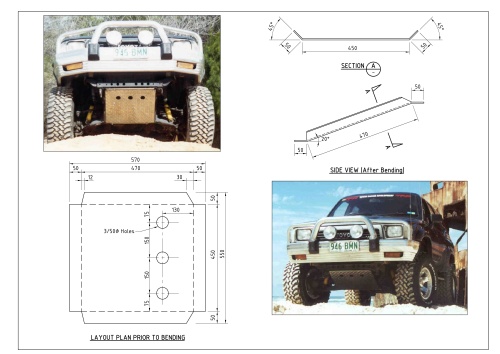

    Hey, Luke. this one comes courtesy of the Aussie Surf site. It fits a 2.4, but not 3.0 auto. You may find someone local to fab one for you. Hope it helps.

      something like that yea, i need it for fitment to a 2.4.
      plus i dont want it as low as the one that is on there, the standard one is way too low without the condensor behind it and gets in the way.
                    Yer mixed up mate, that is for the 3.0, I know, I made one from 6mm ally plate.

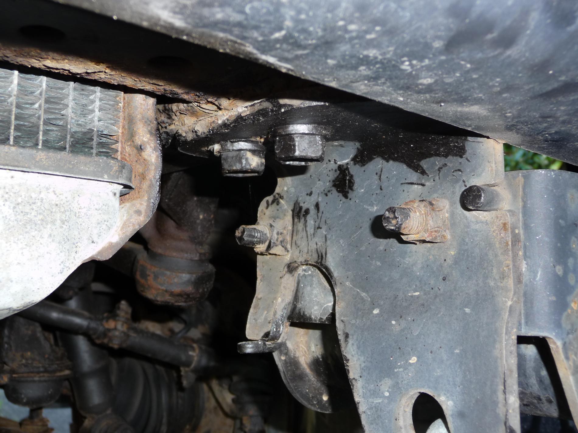

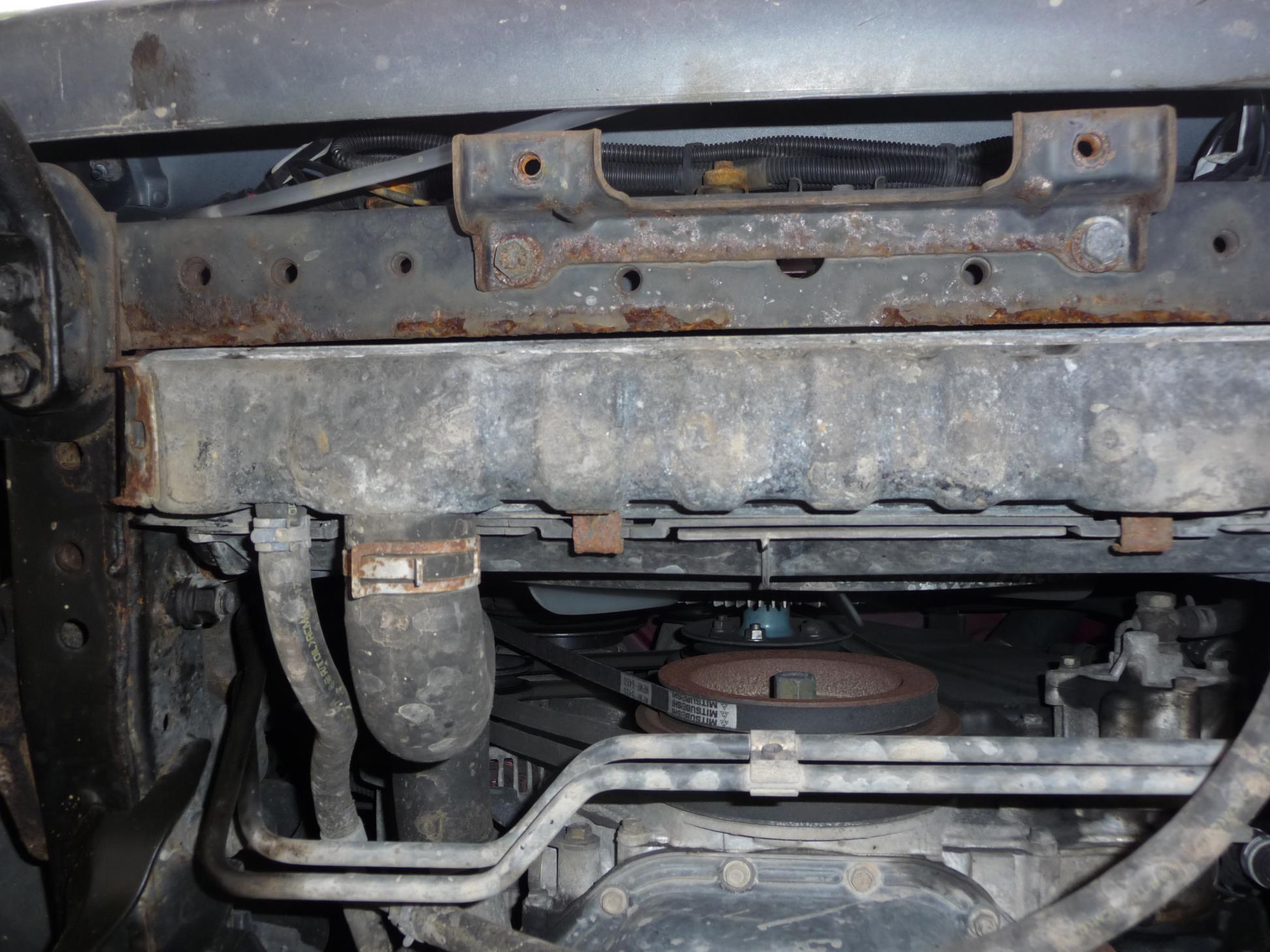

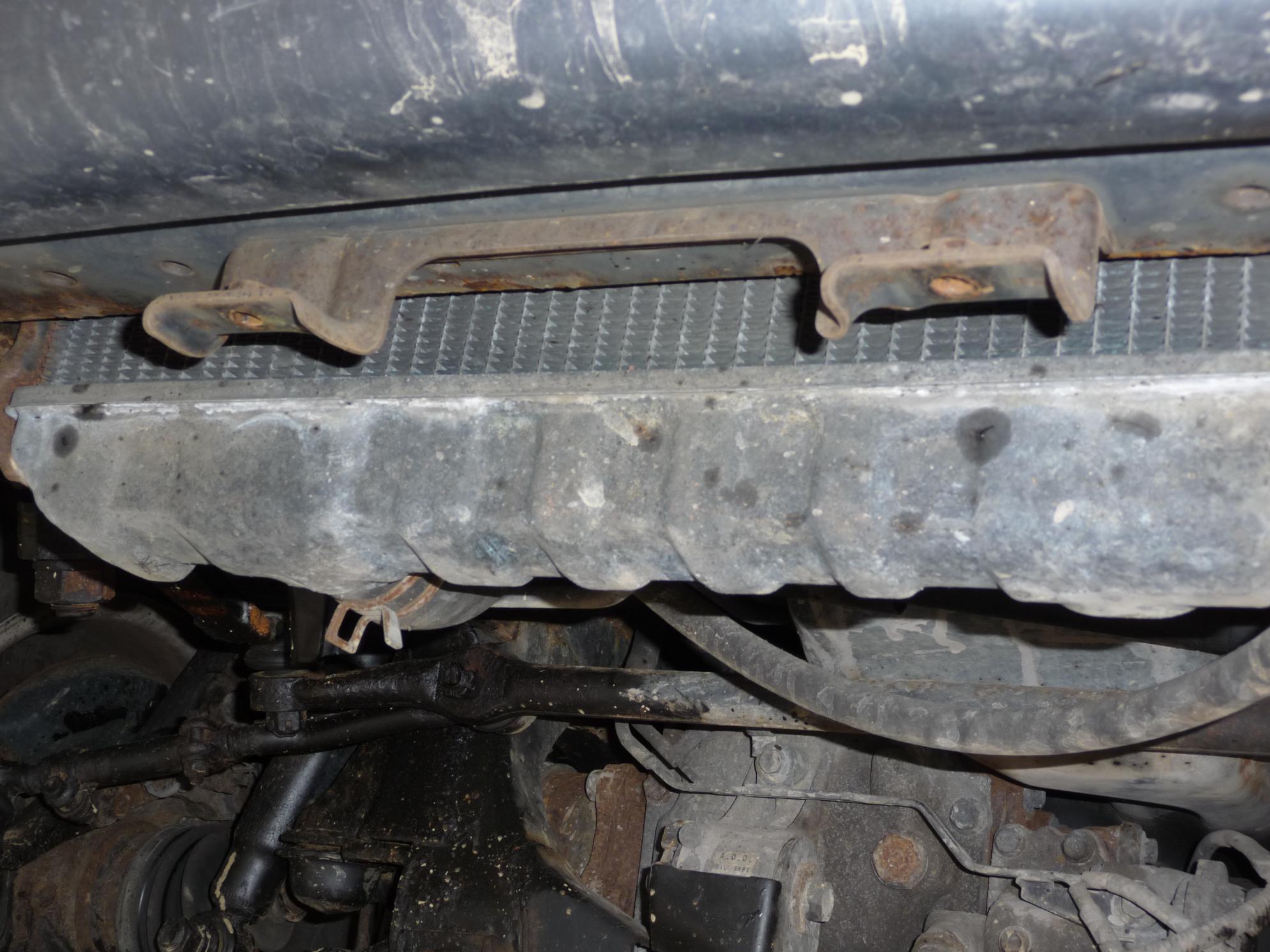

                      Alan, I had one made and it won't fit the 3.0 auto, because the radiator sits too low on a standard Surf that hasn't had a body lift. Maybe yours was body lifted before you did your bash plate? See pics.

                            im sure your mounting points are different to mine, is that a 3.0? the 2 rear blots go vertical into the cross member and the front ones are horizontal just below the front bumper.
                            plus my rad isnt that low...
