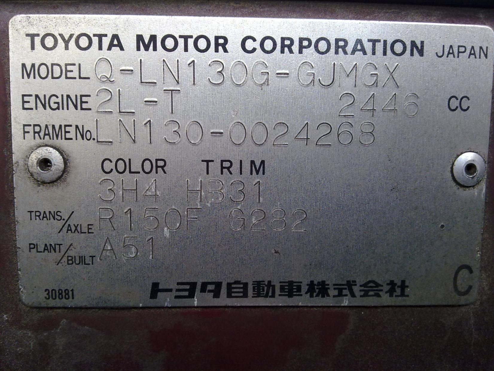

I have found a local cheap rebuilt 2.8 (3L) short block and am hoping to be able to fit it to my surf to give her a new lease on life (2.4's blowby and oil consumption is getting really high)
I know someone in the past here has said that a 2.8 head will fit on a 2.4 to replace a cracked head, but can we go the other way around?
Whats the clearance volume like on the 2.4 vs 2.8 heads, will it completely throw out the compression ratio?
Cheers for any help guys, just thinking if it works it means its going to be a 2.8 with a turbo (and an excuse to finally get around to fitting the intercooler sitting in my garage waiting to be put on)
