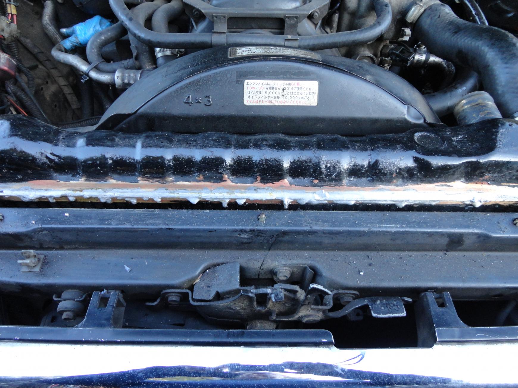

As post suggest another radiator is leaking. Small weep from top tank on soldered joint. I rang Roughtrax where I purchased it from mid 2009 and only one years warranty ! Not trying to rubbish RT but I have purchased a new head in the past and buy all my service items from them. They NOW offer an upgraded radiator stating better quality not like inferior items that leak from top tank etc!!! So were they selling inferior in the past ? I have covered leak in hot melt glue to hopefully give me a few days as Wifeys car stuck in snow at Mother in Laws, and will probably attempt a Solder repair when next days off.

Hey, David. I had a similar problem, last September. It was the original Toyota rad. I was lucky, because the local radiator specialist brazed the small crack up for me in situ......If yours is on the soldered joint, a butane torch on it and a little more solder should cure it............Originally posted by Webbo View PostAs post suggest another radiator is leaking. Small weep from top tank on soldered joint. I rang Roughtrax where I purchased it from mid 2009 and only one years warranty ! Not trying to rubbish RT but I have purchased a new head in the past and buy all my service items from them. They NOW offer an upgraded radiator stating better quality not like inferior items that leak from top tank etc!!! So were they selling inferior in the past ? I have covered leak in hot melt glue to hopefully give me a few days as Wifeys car stuck in snow at Mother in Laws, and will probably attempt a Solder repair when next days off." Time wounds all heels ".
I did think of that but it survived the trip to work OK I dont think it gets quite hot enough to remelt. Just ordered small propane torch and will have a go at resoldering on my days off I think the main problem will be getting it clean enough.....Originally posted by davec170 View PostHot melt glue probably isn't the best temporary repair method. I think it'll melt when it gets hot

Well got home from work, Just ! And on closer inspection the top tank had came away almost totally from the rad. After loads of brass wire brushing and sand papering spraying with brake cleaner blown out with the airline, I smeared the cleaned surface with flux and soldered the parts together. I know maybe not the best looking job, but done in situ, at least the stalagtights will hold the parts together this time, I hope. System all refilled and no leaks visable, I will take out for a drive in the morning and check. All in all not at all impressed with the quality of build of this one and a half year replacement part. Hope this helps others in the future.Last edited by Webbo; 2 August 2012, 22:15.

Thanks for the link, if I have to buy again thats where I will go. Yes Ian I dont care what it looks like as long as it holds. I was quite shocked when I cleaned it all back how very little solder was actually holding the top onto the rad around the middle area, suprised it lasted this long ! Just been out and tried it, all looks OK so fingers crossed.
