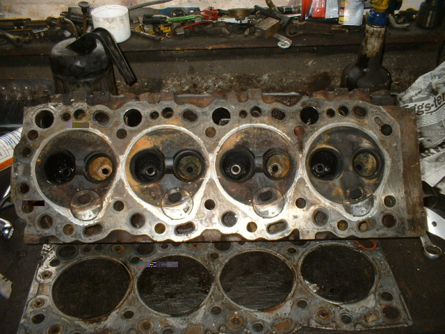

    Well guys, after 11 months and 24 days, it has happened! The dreaded head crack! If I can get my head (sic!) round the technicalities, I'll try to attach a pic of the head, showing the underside and the dreadful pitting around the valves and seatings. My mechanic reckons this has been going on for some time, probably caused by the head cracking between the cylinders some time ago and water infiltrating and reacting with the metal.
    Anyway, since it has been done, new head, gaskets, thermostat, rad cap etc etc, I now have abslolutely NO BLACK SMOKE. I don't want to worry anyone, but if you still have black smoke, get your head checked before it lets you down miles from home!
      Laurie.
      Did your mechanic by any chance replace the injectors at the same time. My Surf still smokes on startup and a light haze on acceleration (nothing drastic) since I did the head. I haven't changed the injectors on mine but I will be doing at some point.
      Sorry to hear that the head went, around about the same length of time to when mine and Koi's went (mine about 12 1/2 months). Hope it is all OK now and at least hopefully it will be alright for good now.

        If i's OK when warm, the water temp is OK, you aren't losing water, then you are unlikely to have lost the head. Some of the cars won't smoke white even when the head is gone (Mine and Koi's for instance), first sign was overheating caused by water being pumped out of the cooling system into the overflow tank and then out of the cap therfore lowereing the water level and causing it to overheat.
        It's very easy to become paranoid with the stories about these cars. You'll know if your head is gone and short of doing the flush, good coolant, new rad cap and thermostat there is little you can do to stop it happening if it's gonna. The best way to set your mind at rest is to have a pressure or gas test on the coolant. If it's OK after that then the head is OK and you can get on with life. Regular maintenance is the key then to make sure that it's life is as long as possible.
