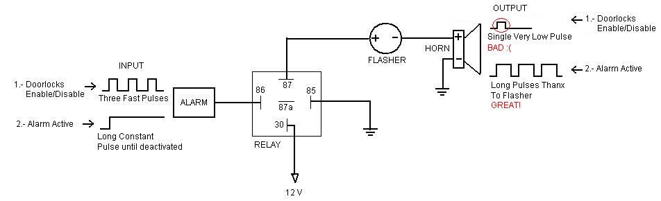

                    just saw this pic. He tried it and worked fine except for the sound that comes when u lock/unlock the door. My q here, can i remove the relay and install only the flasher? Does this have an effect on my horn, like damage it cuz there is no relay?.
                    '94 Surf SSR-X --3.0l Turbo-KZN130W -- 400,000KMs
