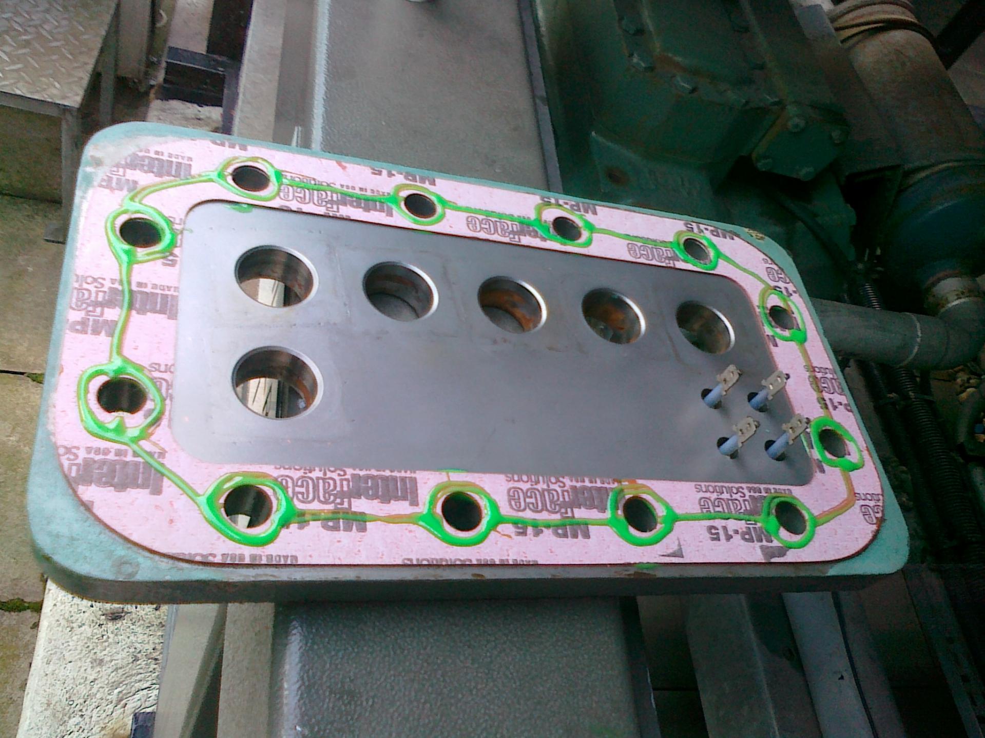

and we should be learning from the above example about the use of pastes and compounds on gaskets, and the effect of gasket creep and extrusion then

I will let you know how it fairs ,the plate has fitted, been torqued up and is now being subjected to a 33 Bar drop test ( at 6 hours into the test the pressure stood at 33.5 Bar) it is going to be on test until Friday.BTW the original gasket failed and that was assembled (dry) go figure.
Hey B.G.B. Shot in the dark, but from the remnants of green paint around the edge and your brief tease, I'm guessing ( and the faint square marks around each hole on the cleaned up face plate really intrigue me) that its something to do with the valve block on a huge industrial heavy duty stamping/press type thingy......?????.............
the addition of any "lubricant" on a gasket increases the chance of creep and extrusion, when combined with incorect bolt torque, ultimately failure of the joint.
The old school is at odds i say no additional sealants are required,and in fact reduce the joints integrity, how ever the use of specialist adhesives to hold a gasket in place for purposes of assembly only are acceptable depending on application.
Which will now be poo pooed by all and sundry no doubt.
Paste off in progress:-d
The plate is the electrical terminal plate from a 500KW compressor .
The gasket is used as the suction gases are used to cool the electric motor.

The pressure test passed over twelve hours at 33bar.it is now under a vacuum and when the vacuum reaches 1torr the rise test will start.of course rest assured that i will keep you up to date on the proceedings.
For your information i will repeat one of my earlier postings, the gasket was being replaced as the original had failed the original was assembled dry.
As this system uses about 80 kgs of gas at about £120 a kg it will be gas tight.
I do not understand why you have such a hatred of "these crappy sealants".and why you seem to try to baffle brains with bullsh1t in fact the last "guide" you posted did not even mention refrigerants hfc hcfc cfc et al.
In a previous post you stated that 99% of all gasket failures that you had witnessed were due to some fitter smearing crap over the joints ,a point that you have yet to prove.
I can not repeat what was said yesterday when mentioning the use of "crappy sealants" as "some fitter" reassembled the failed gasket,(apart from something about seeing you next tuesday?)yes the failed gasket which was fitted in the workshop dry no sealants and to the correct torque.i fail to see wtf gasket creep has to do when it is held in place by 12mm bolts?
