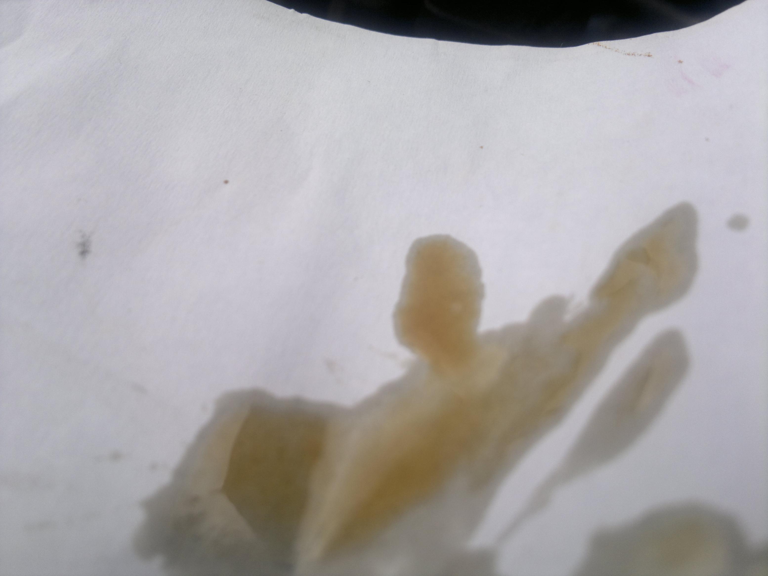

            this is how it look like

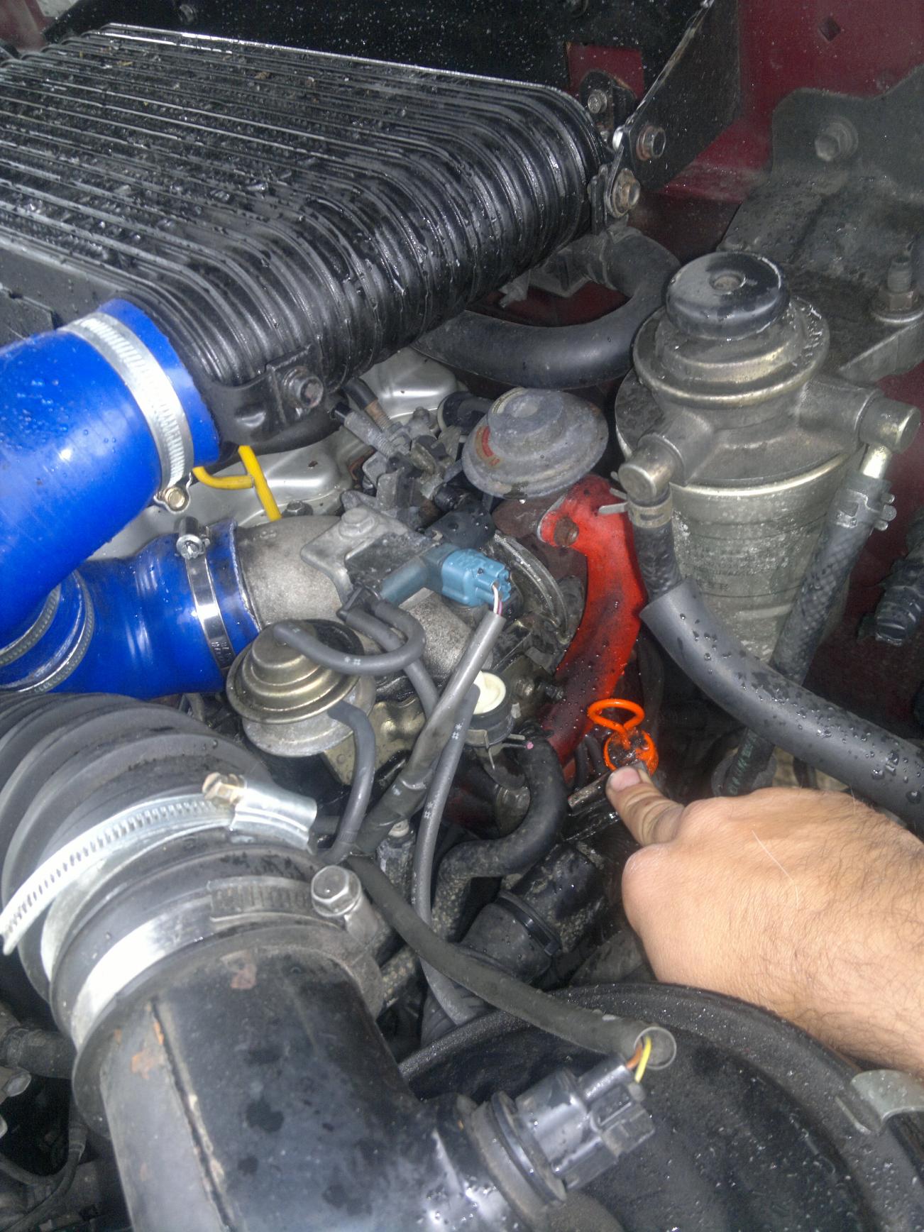

              Can you show a photo of where you got that from?

                Looks more like engine oil than ATF

                    with the pic i just sent it will show up my lack of knowledge.

                      somethings not right there, that looks more like gearbox oil from transmission box
                      was gonna say engine oil, but 9 times out of ten on diesels engine oil tends to be black
                      atf when new should be cheery red, then as it gets older looks more like ribena, then goes black and should be replaced.

                        That's not your pointing finger aswell I used that pointing finger and it cost me £80 quid
