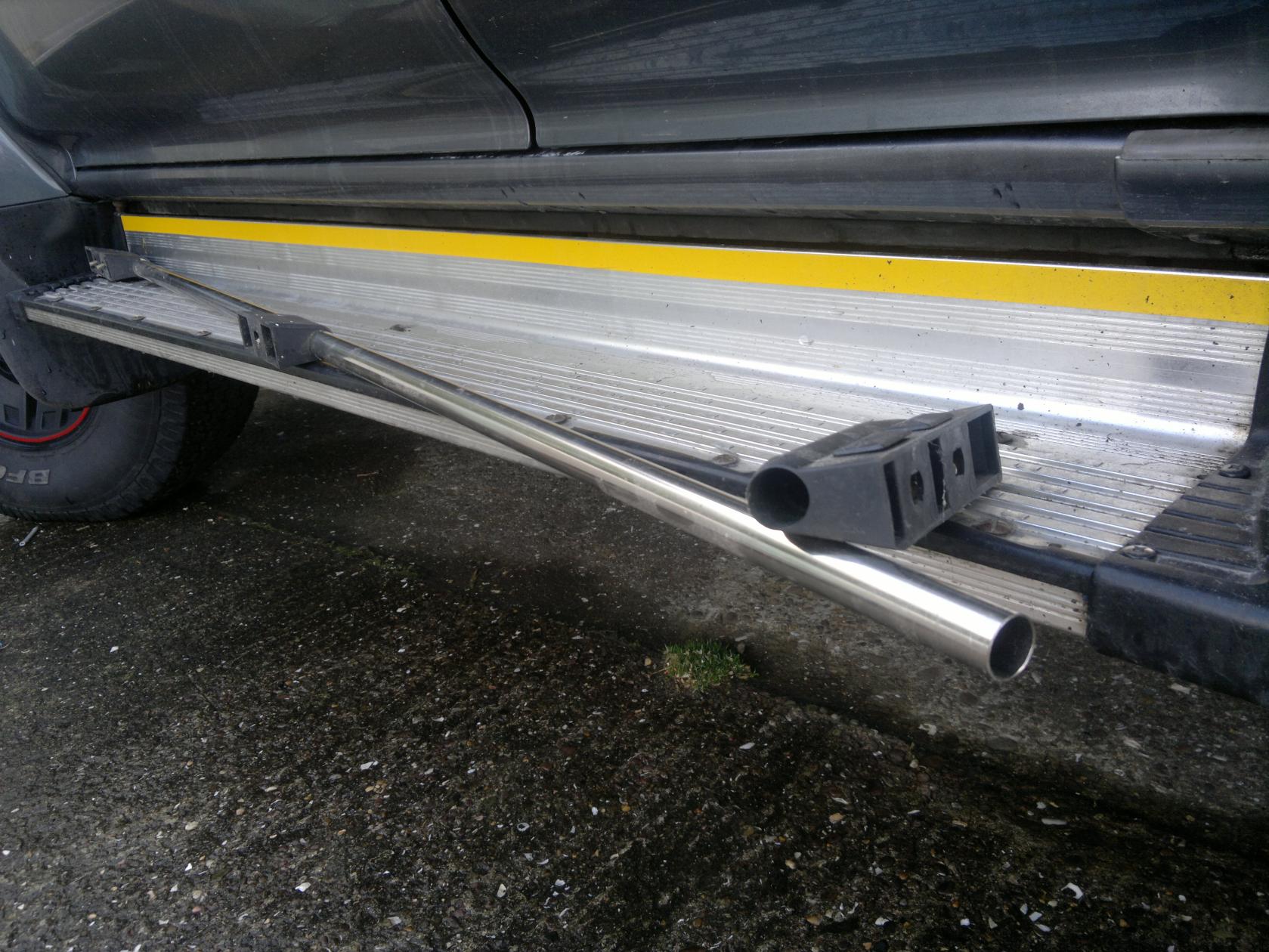

    i got carried away and i bought this roof rails from a scrap man, he assured they came from a surf, but now i am having second thoughts.
    is it strong enough for support same 8x4 plasterboards, or me and hopefully roof tent?
    soud i look for something stronger? and sell this, this is plastic mountings with a hollow pipe.
    or longer, this is 65 inch.

    Hey JC. Those do, indeed look like IRON FLY roof rails. Formula 4x4 sell them as aftermarket accessories, so your scrapman may have taken them off a Surf. They're reasonably sturdy, but anything bolted directly to the roof panel will only be as strong as that panel. If they are Iron Fly, they should bolt from the top, downwards into the roof using "Rivnuts". Let me know how you get on with them and if you decide not to use them, please give me first refusal on them (Subject to price and carriage costs, of course.).....Cheers....Mick.

      if i decided to use them i need to find those "Rivnuts"
      and same rubber to be between the metal and the plastic legs.

      do you know how much Kgs can hold on??

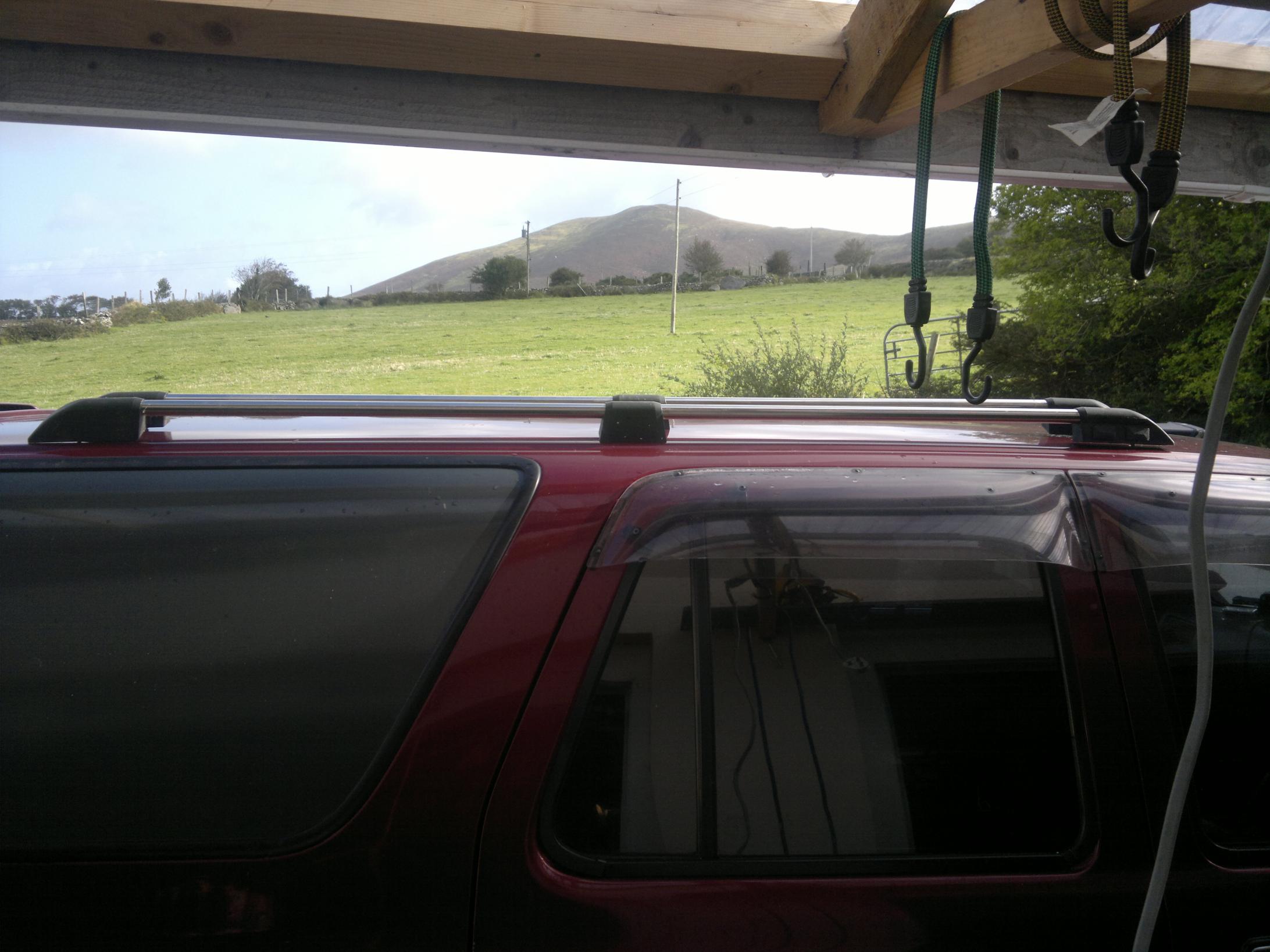

        I fitted some to my truck off a Peugeot 406(dont quote me) but the Surf is only a flimsy roof panel so personally,no,I wouldnt put anything too heavy on mine.You may get away with a roof bar for some lights,or if you strengthened the roof you could maybe fit a Thule type box,but again be wary of too much weight.The Peugeot had some brackets fitted between the side rails and the feet of the bars,but it seemed too much work to make them fit.

                Most roof racks are omly rated for 75 - 100kg max. Doubt very much the Surf is rated any higher for roof loading. Don't think I'd feel too comfortable with a quarter of a tonne over my head!
