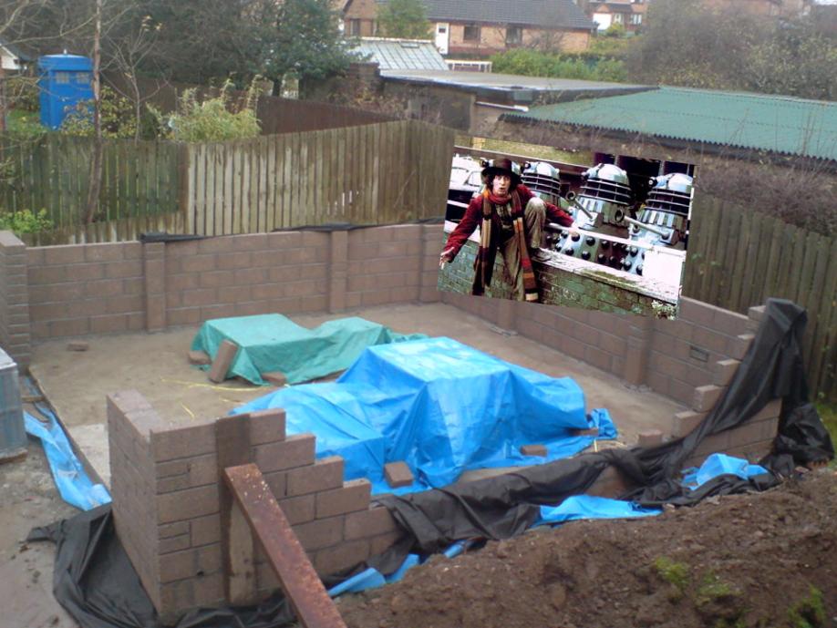

Two days of drizzle has held us up a little.
Still hopeful of walls by the middle of next week.
Yep that is a Tardis/Police Box in my neighbors garden, complete with light.
He is a nice fella and also addicted to his VW Camper and everyone needs hobbies, so all in we can excuse him.

did they put any insulation under the concrete floor 100mm wouldbe good make it warmer when your under the truckOriginally posted by yoshie View PostTwo days of drizzle has held us up a little.
I put 8 ton of hard core 2 ton of sand a 1200 gauge DPM then 9 ton cement.Originally posted by ziggy View Postdid they put any insulation under the concrete floor 100mm wouldbe good make it warmer when your under the truck
Look at my location some fluff under there aint going to help much.
im a builder and trust me polystyrene insulation under concrete makes a masive diference its used in all new buids extensions ect. you only have 4 inch walls too,no cavity it will be as cold as outside, you could however use insulated plasterboard on internal walls in the future. as for the floor, too late anyway..buy a big gas air blower.Originally posted by yoshie View PostI put 8 ton of hard core 2 ton of sand a 1200 gauge DPM then 9 ton cement.
