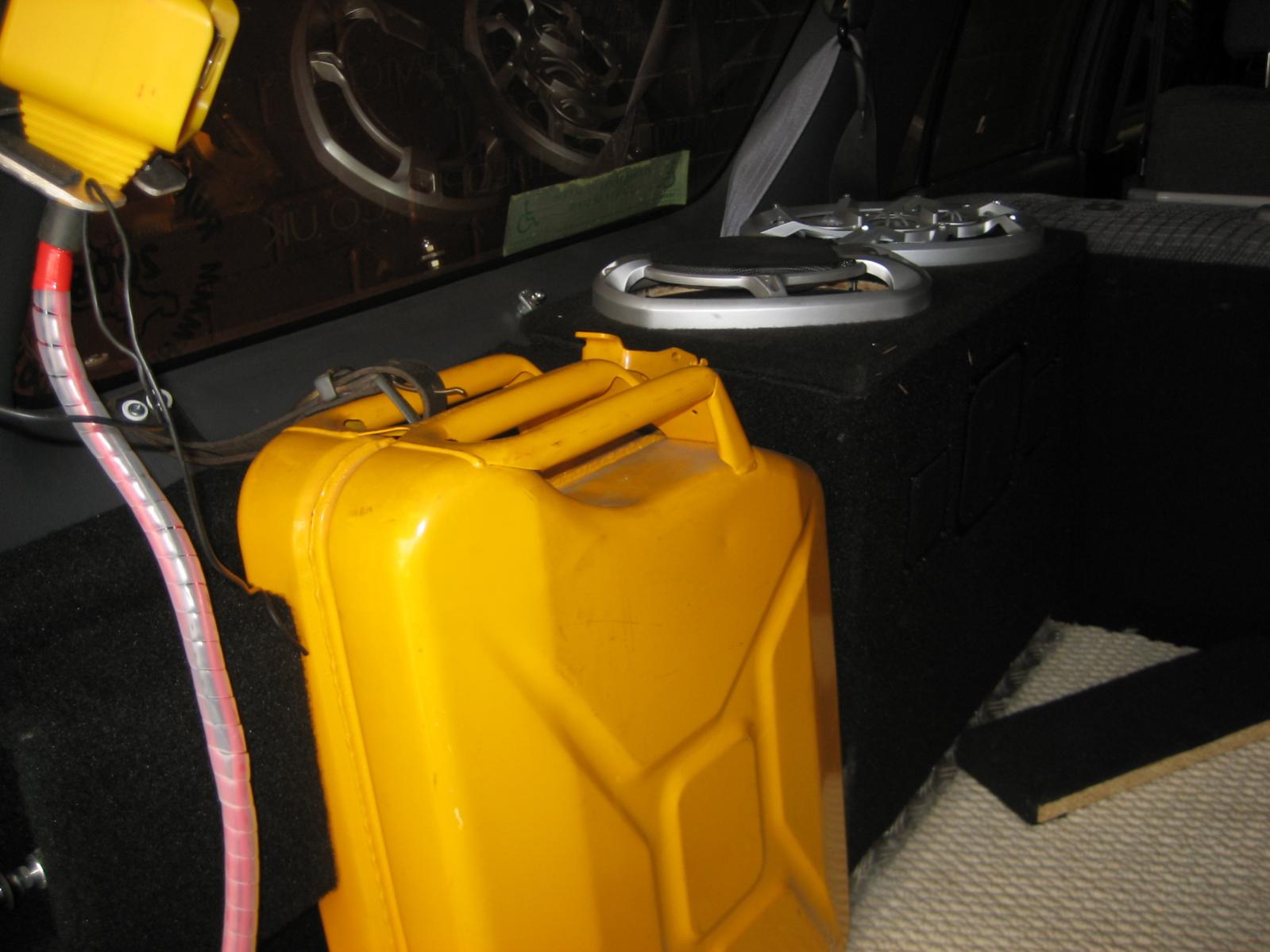

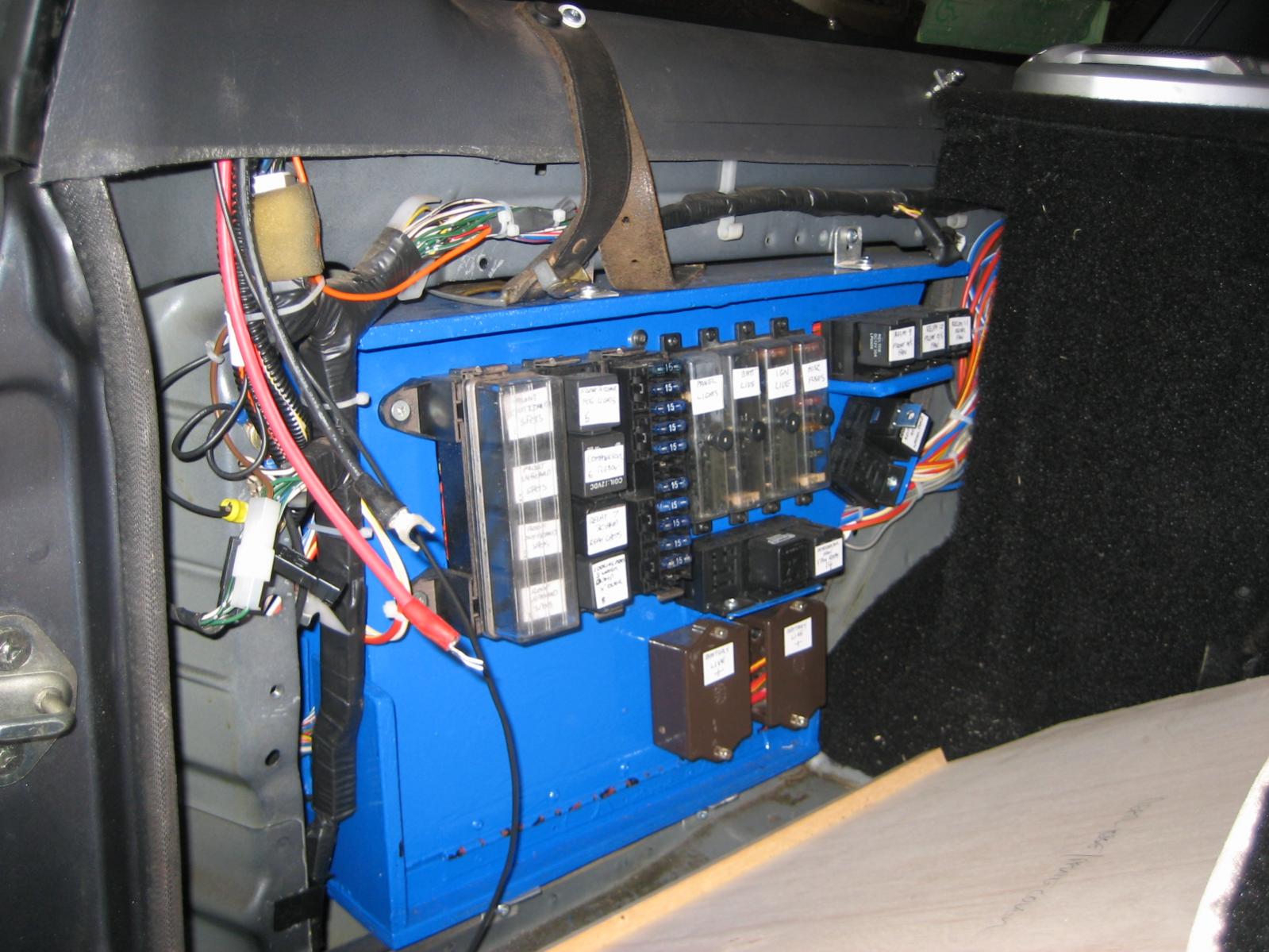

1, fuse and relay panel, all the added stuff works from there, i've cut those great big rear panels at the waist and made carpet covered boxwork to cover and house the speakers, amp etc the old rear gate relay stuff is also in there, much easier to get at than haveing to remove the entire side panel

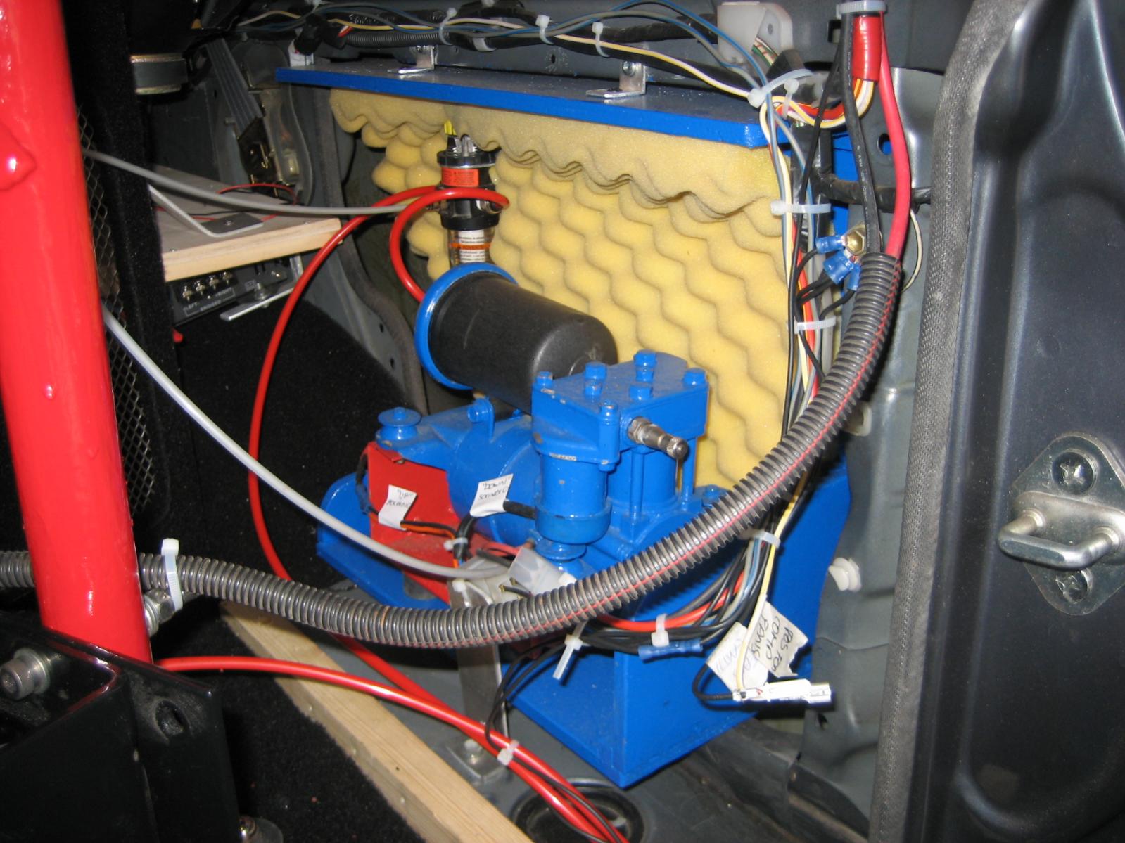

2, compressor, again boxed in with two cooling fans to help it along,

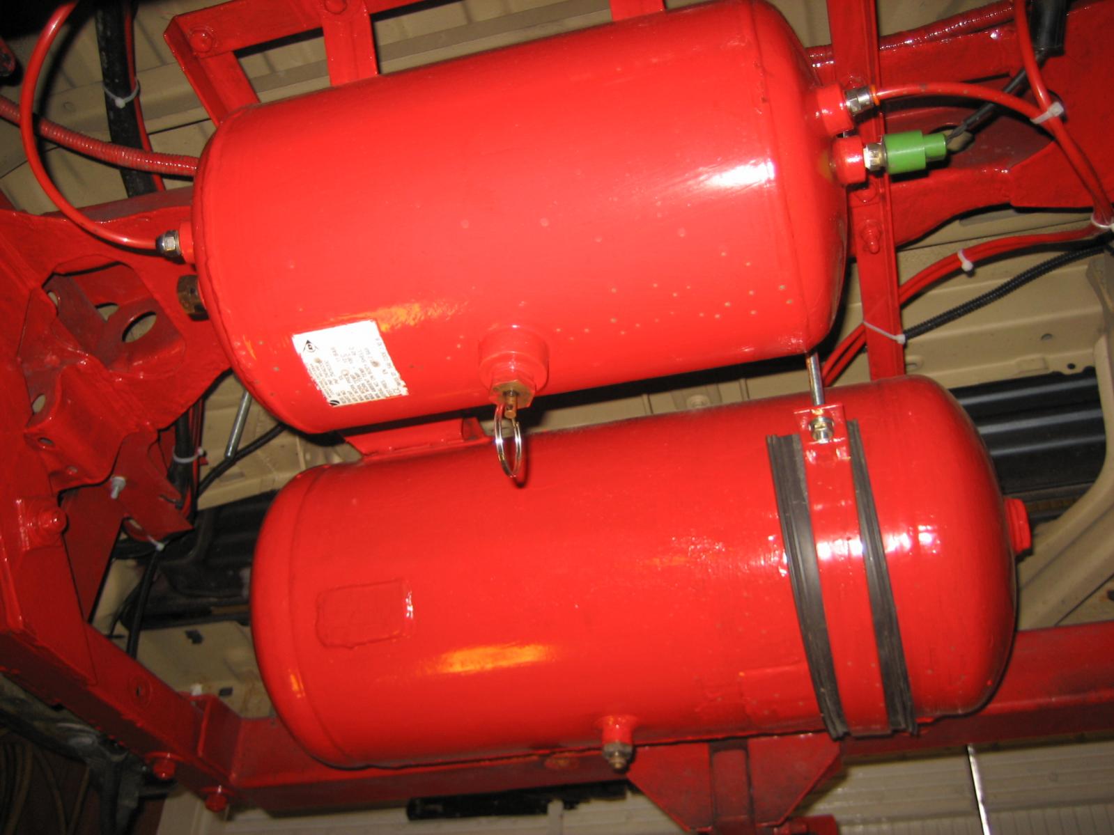

3, twin air tanks under the back piped together,

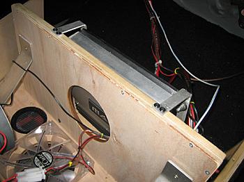

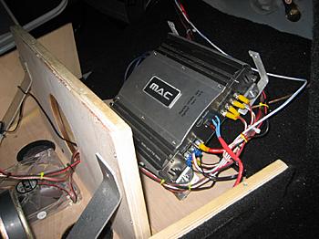

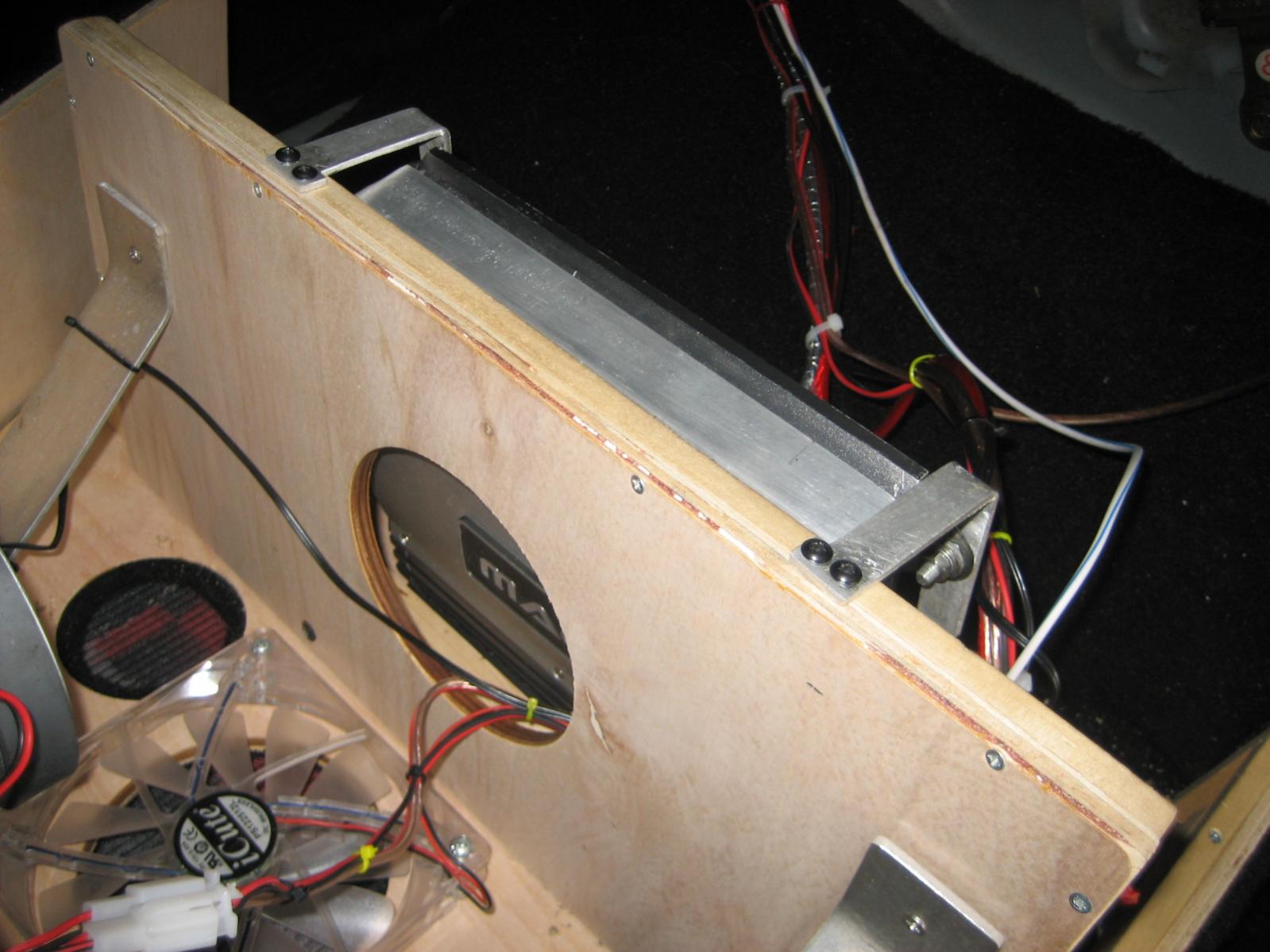

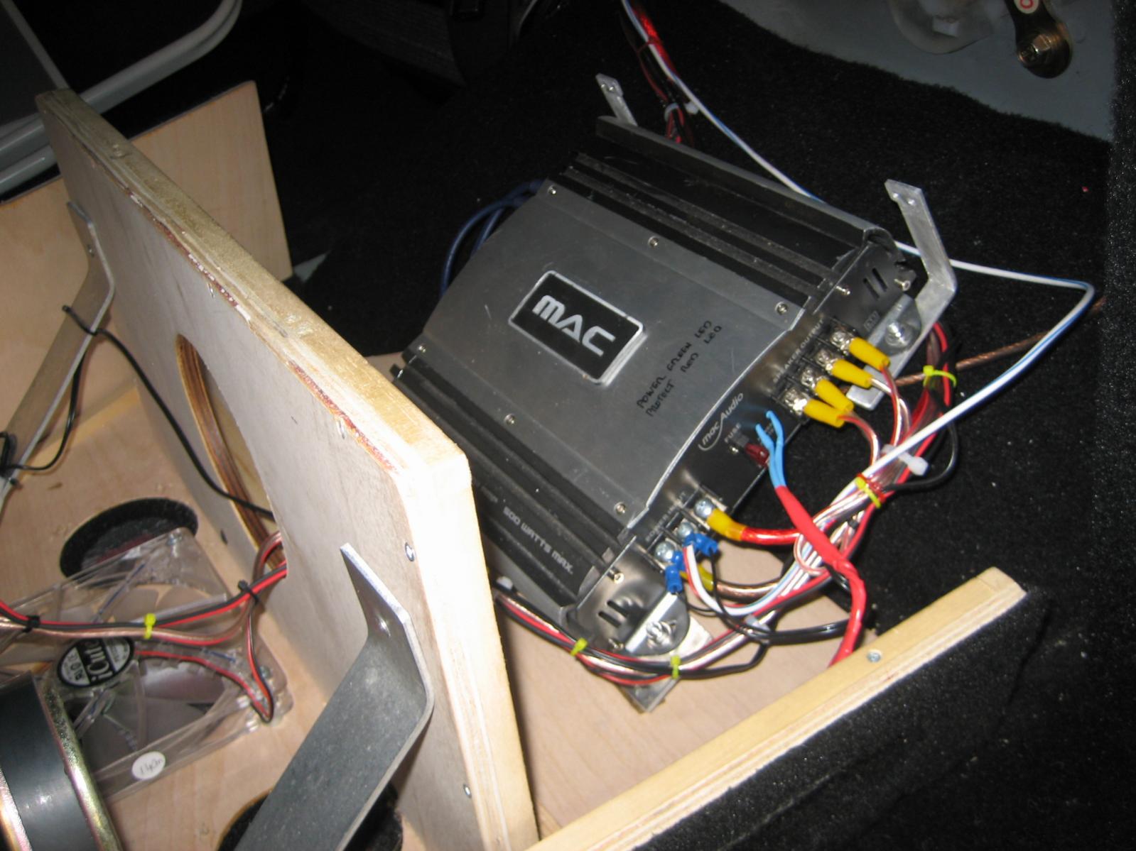

4, the AMP, it's fitted on hinges so ya can get at it,

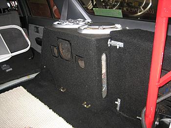

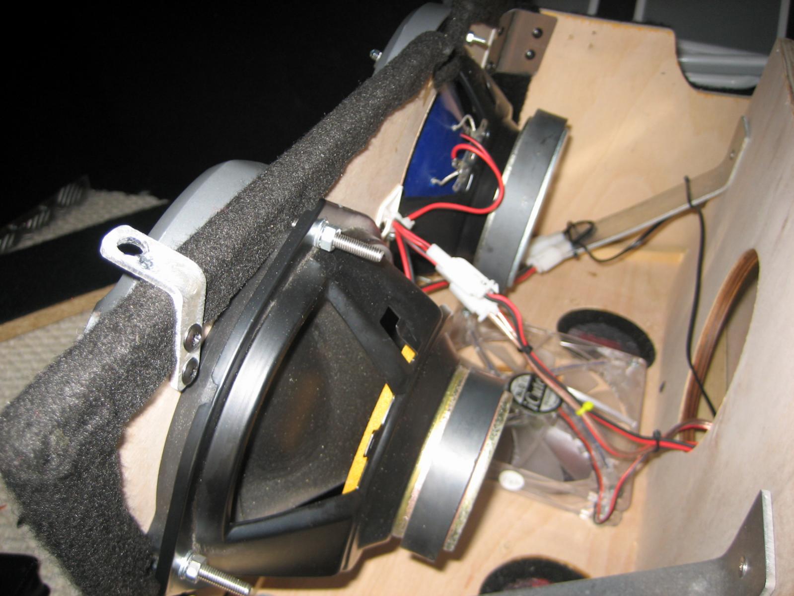

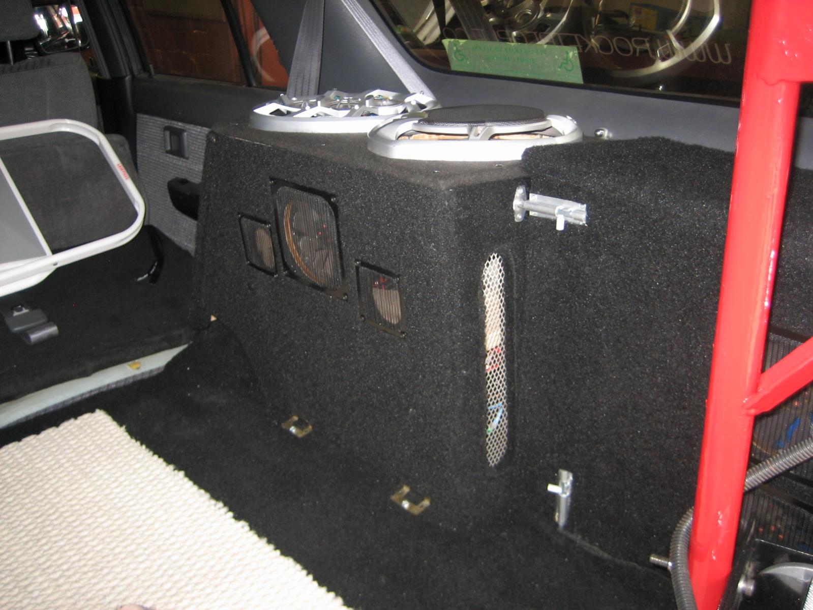

5, the o/s rear speakers and fan in place,
6, the amp in place (4 x small screws)
7, o/s boxwork
8, n/s boxwork

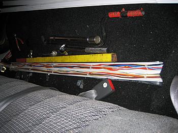

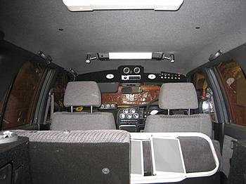

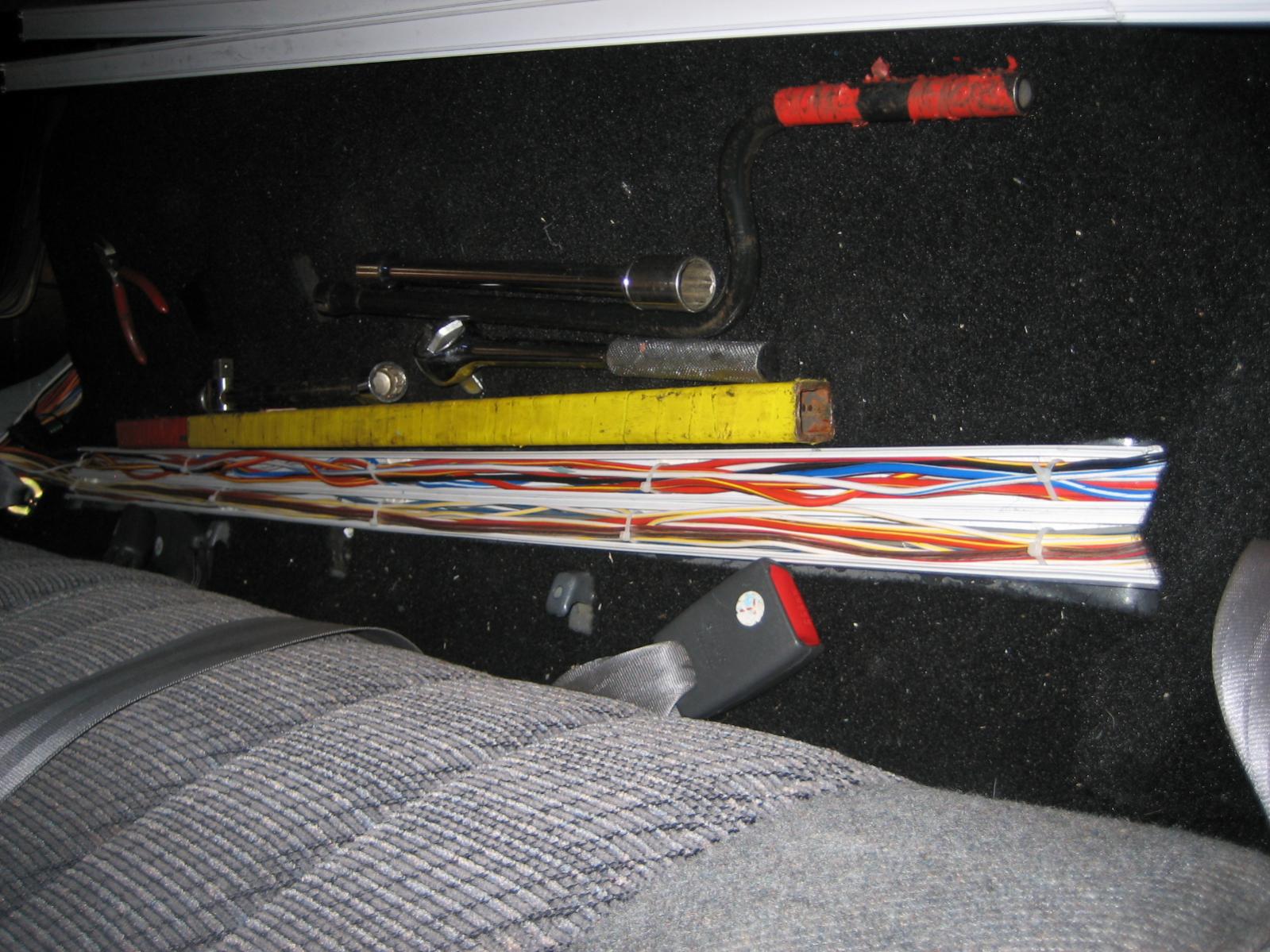

9, some of the transverse wiring run in cable conduit under the back seats, lids go on with some cable ties to keep em in place,

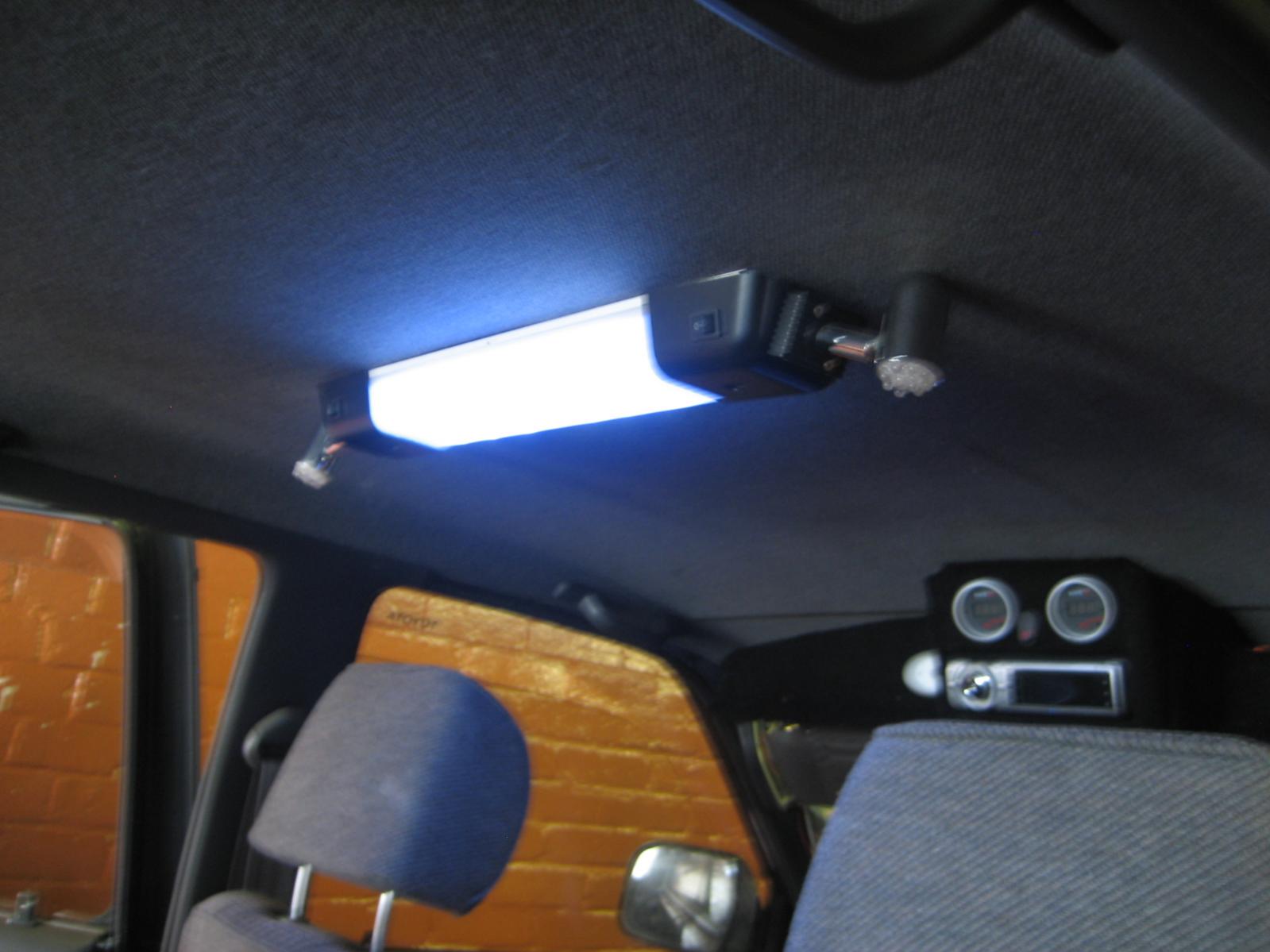

10, remade interior light plus 2 x map lights either end, these and all the footwell/rocker panel or sill lights are run from a DP/DT toggle switch up in the roof console, 3 positions, on (with the door switch grounds/ off/ on anytime,

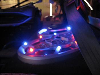

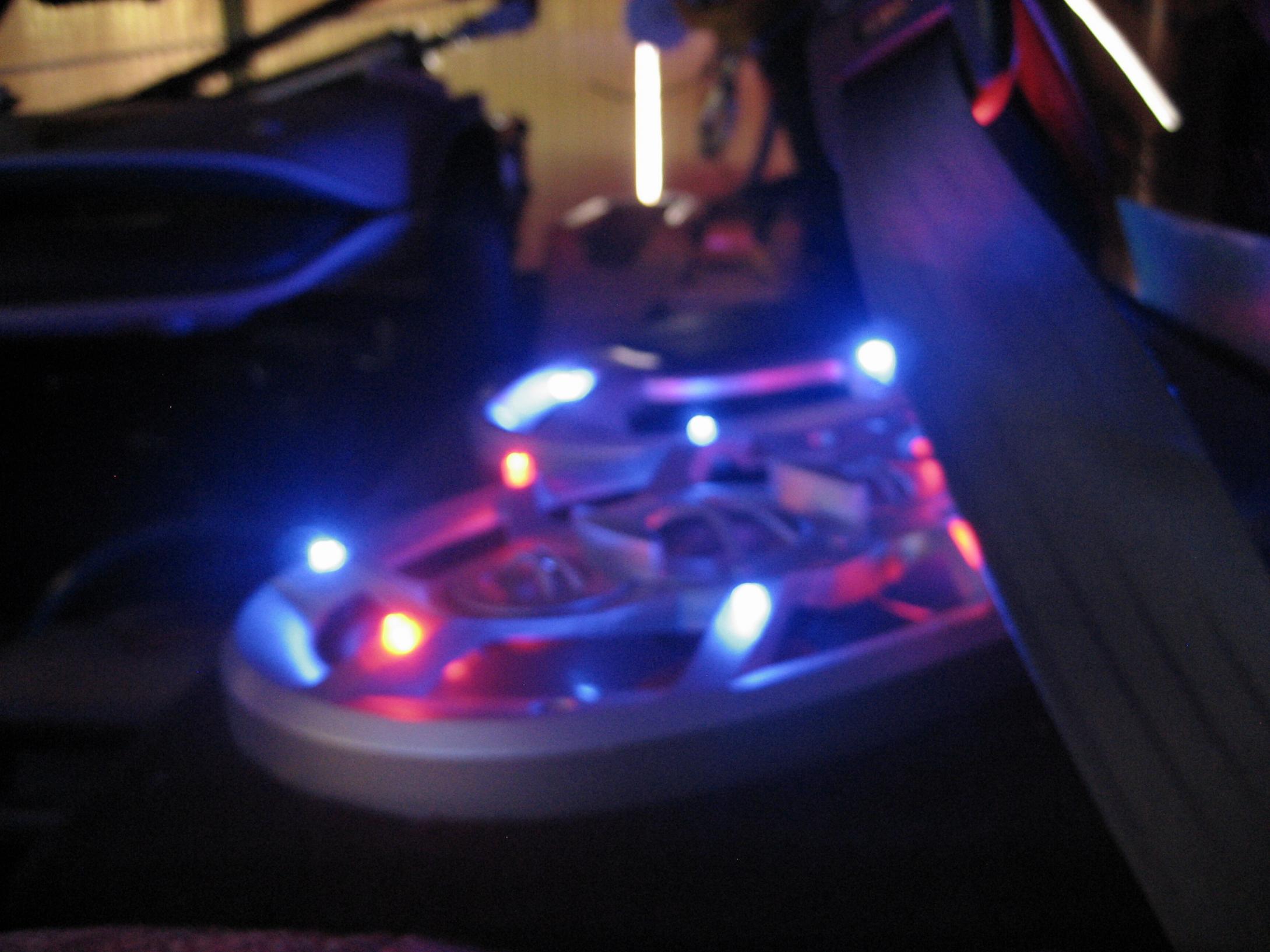

11, speakers sound to light l.e.d.'s (bit blury)
12, dash (the long view)

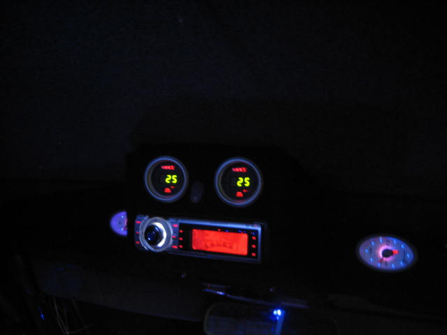

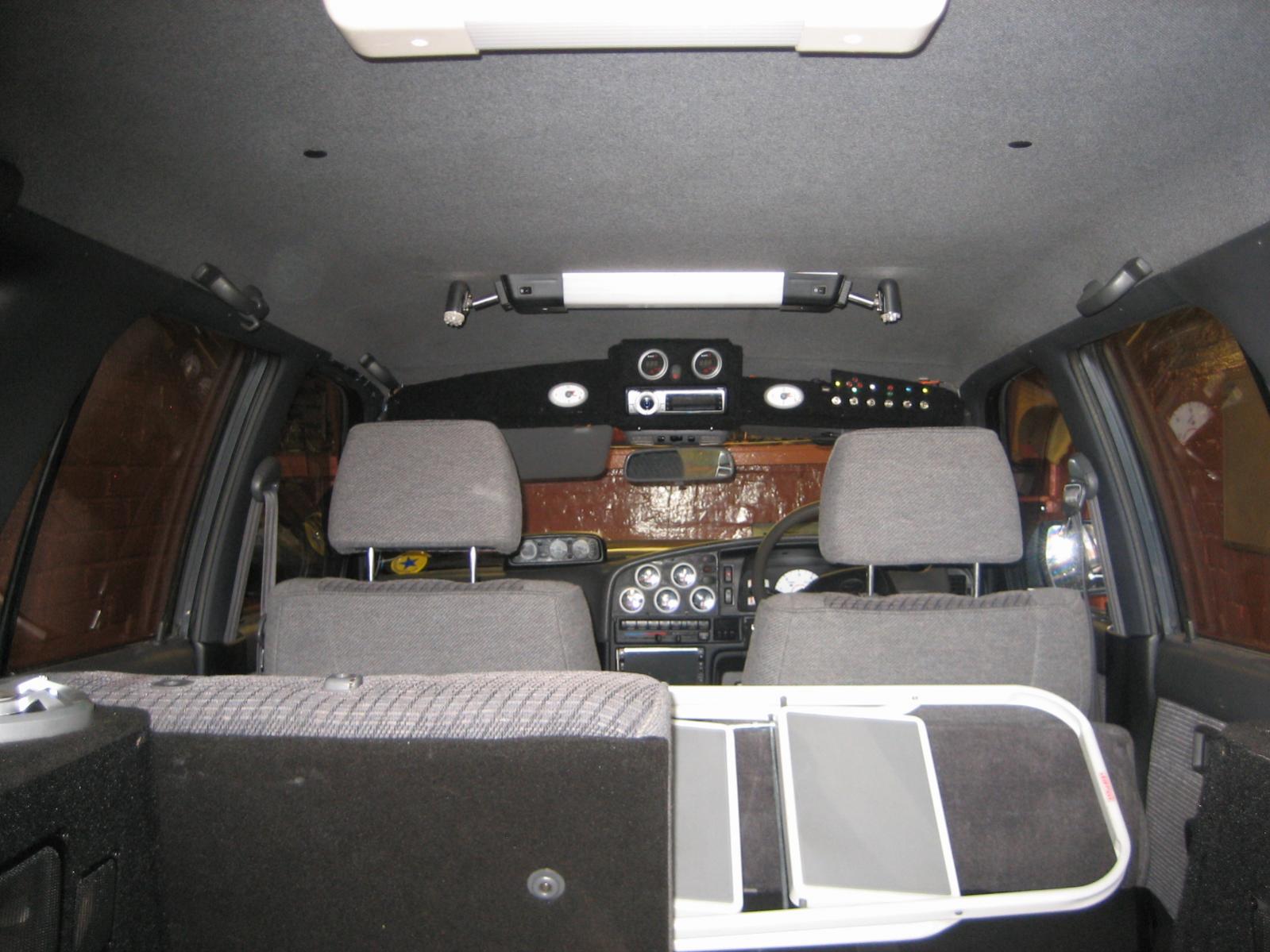

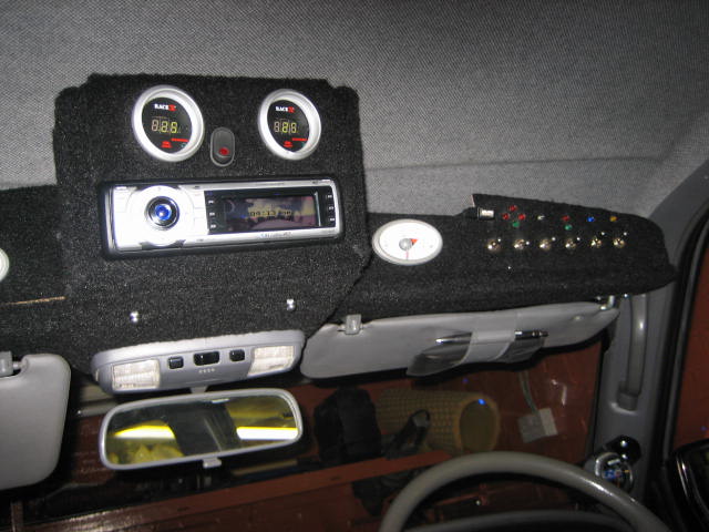

13, remade (new) roof console
14, " " " lights on

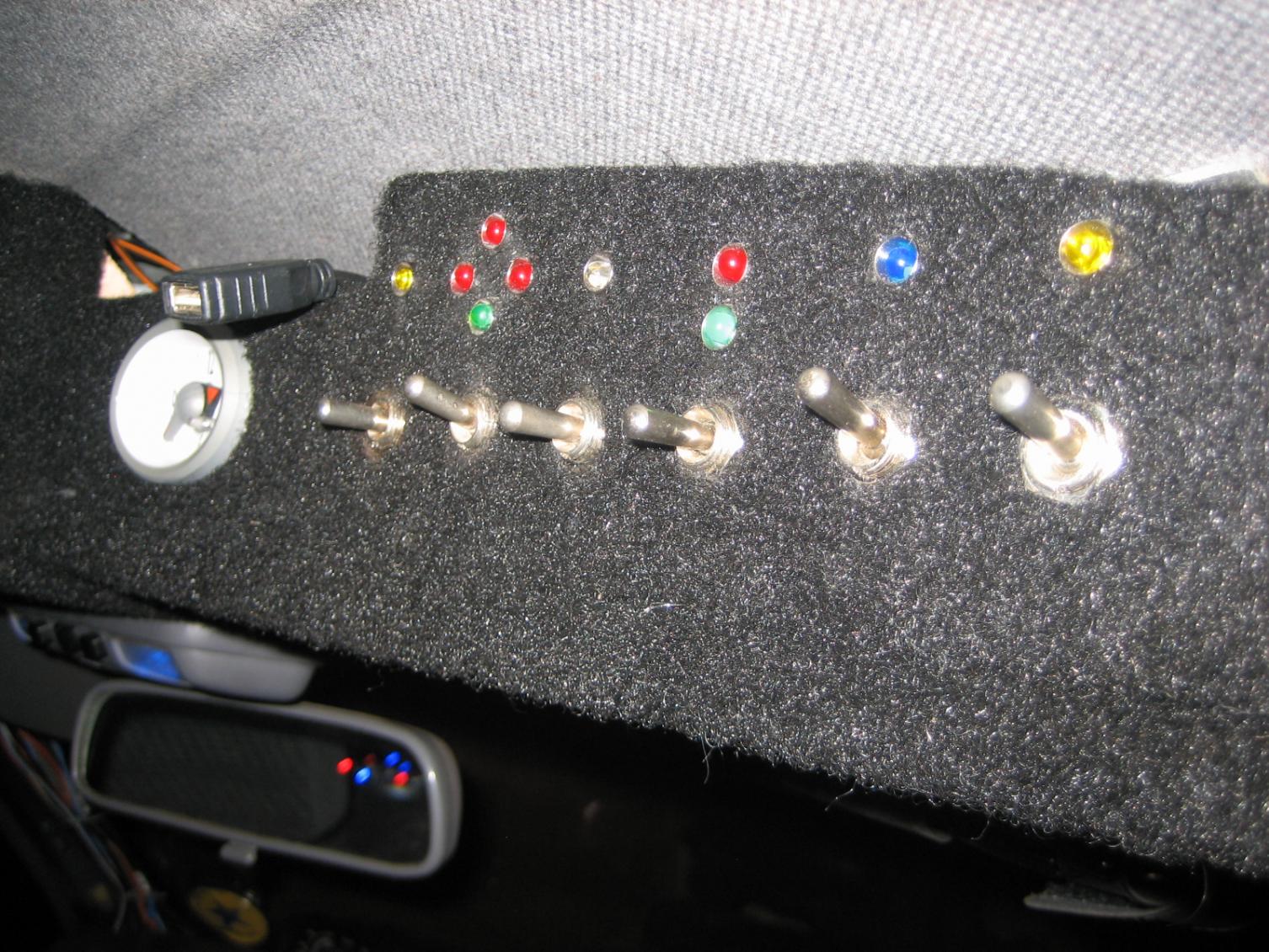

, this has the switches that control
the intercooler fan, cooling fans and pump, compressor, int lights, comp solidoids, gauges are ATF fluid to and from temp gauges and the head unit (plus a pair of ford KA "altered" clocks,

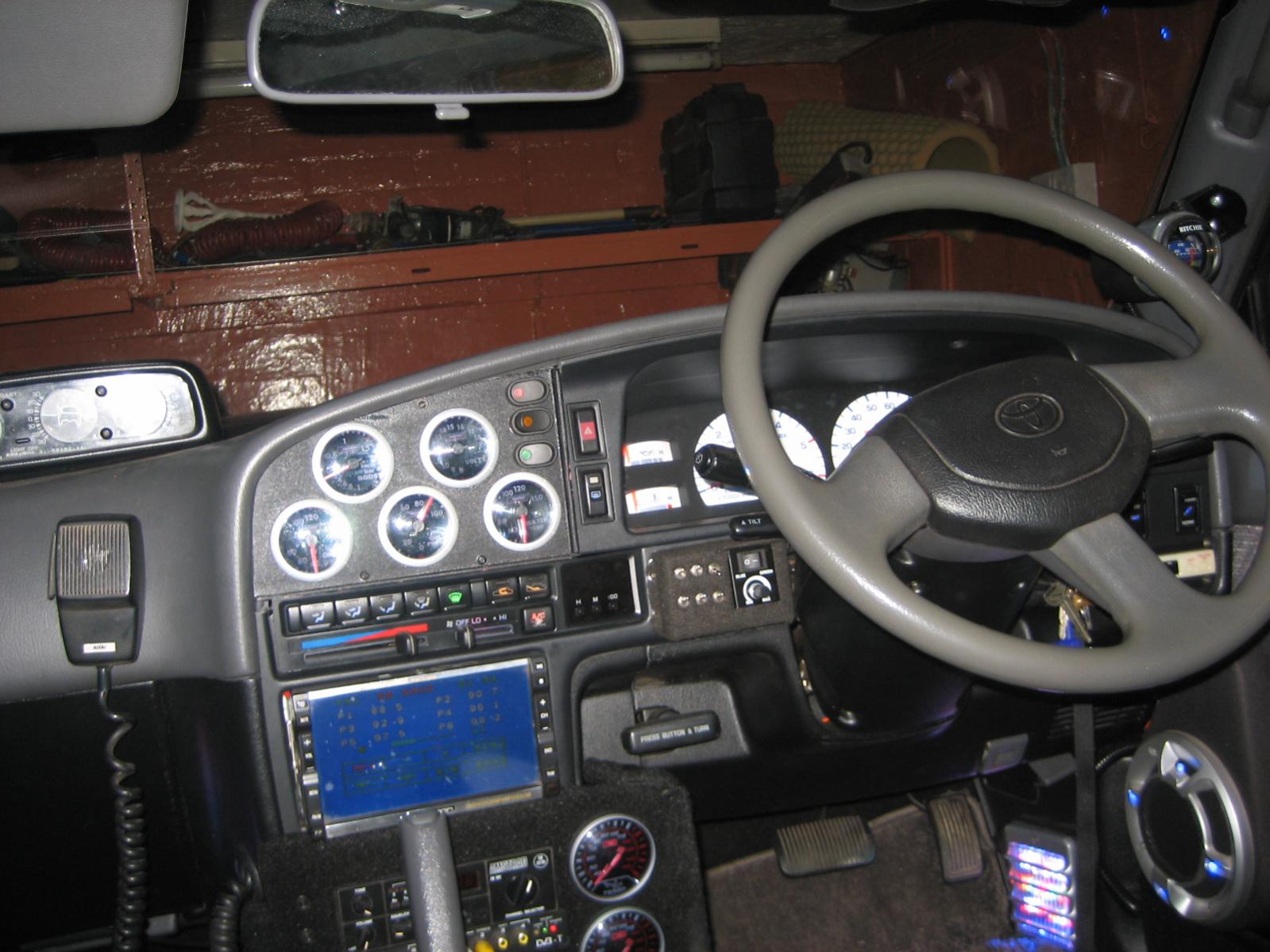

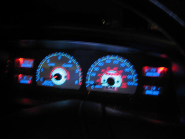

15, dash,
16, dash on,

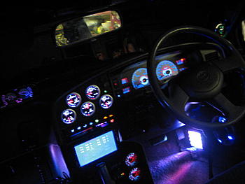

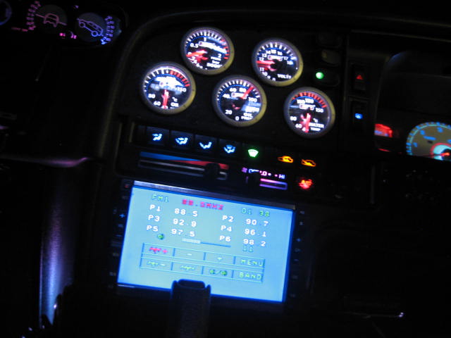

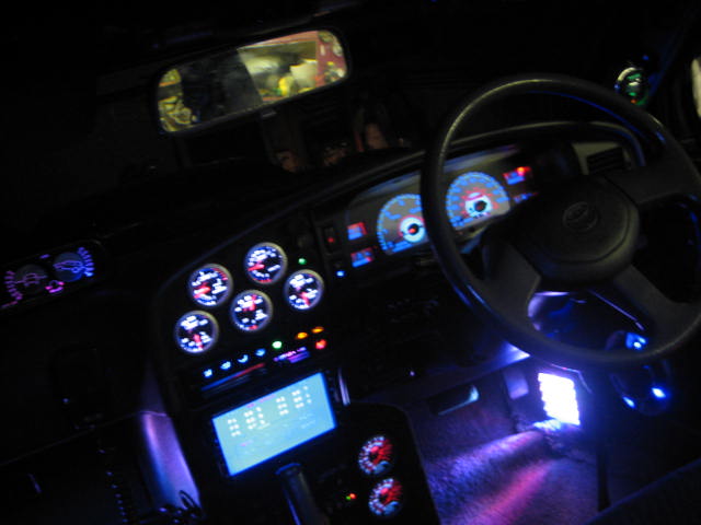

17, " " , although it dosen't look a whole lot different than before i have had a good fiddle with much of it, i've bunched up the five gauges into one place which ment some cutting of the dash on the curv so the plate would fit in nicely, three switches (down from seven) controll the angel eyes/roof bar lights, the fog lights, and the roof & front spotlights, got the plasma dials in and added some red l.e.d.s around the casing for a bit of extra "bling" (also fitted red and blue l.e.d's around the outer (clear) case but i aint took a pic of them as it might cause TonyN to grab his chest, an l.e.d toooooo far for the serious mudder i reccon)
i also hacked the dash about where the heater controlls fit so they " stick out forward a bit and are more in line with everything else, old clocks still there but it seems to have packed up,
18, going down a bit, the telly fits in the old original brackets and thats where the original dash ends, under the tv is the cb radio and the free-view box, some gauges (temps but just space fillers at the mo) the fag lighter and 3 spare switches plus the over-ride switch, (also what will be the step up and in warning light and step down and out warning light

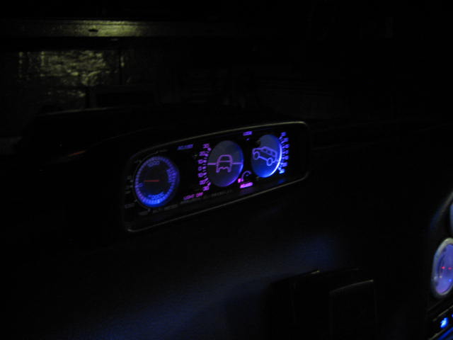

19, the tippy over gauge
20, the "ritchie" compass

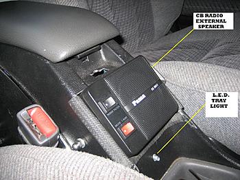

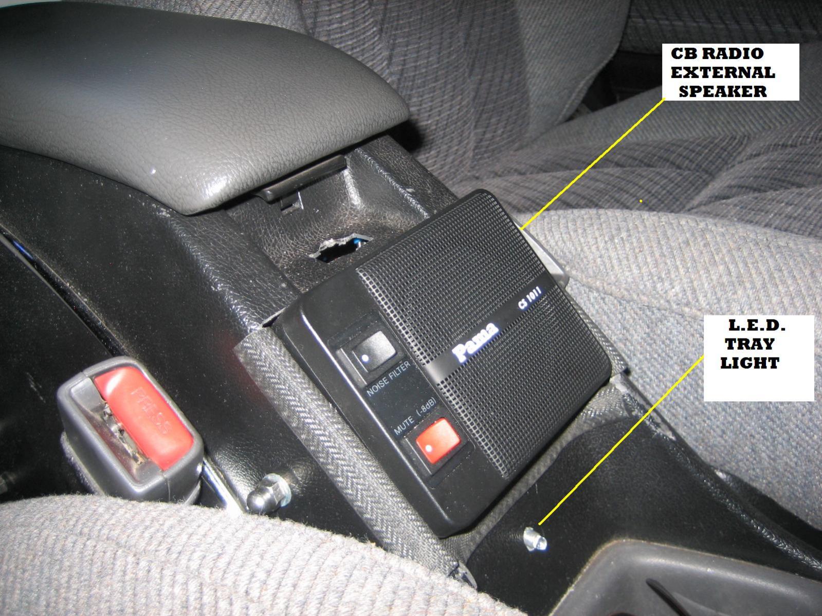

22, cb radio ext speaker fitted in the center console (mic is now on the dash)
23, the switches in the roof console,

)of the inside after a few months of re-wiring and re-fitting stuff,1, fuse and relay panel, all the added stuff works from there, i've cut those great big rear panels at the waist and made carpet covered boxwork to cover and house the speakers, amp etc the old rear gate relay stuff is also in there, much easier to get at than haveing to remove the entire side panel
7, o/s boxwork
8, n/s boxwork
14, " " " lights on
, this has the switches that controlthe intercooler fan, cooling fans and pump, compressor, int lights, comp solidoids, gauges are ATF fluid to and from temp gauges and the head unit (plus a pair of ford KA "altered" clocks,
15, dash,
16, dash on,
