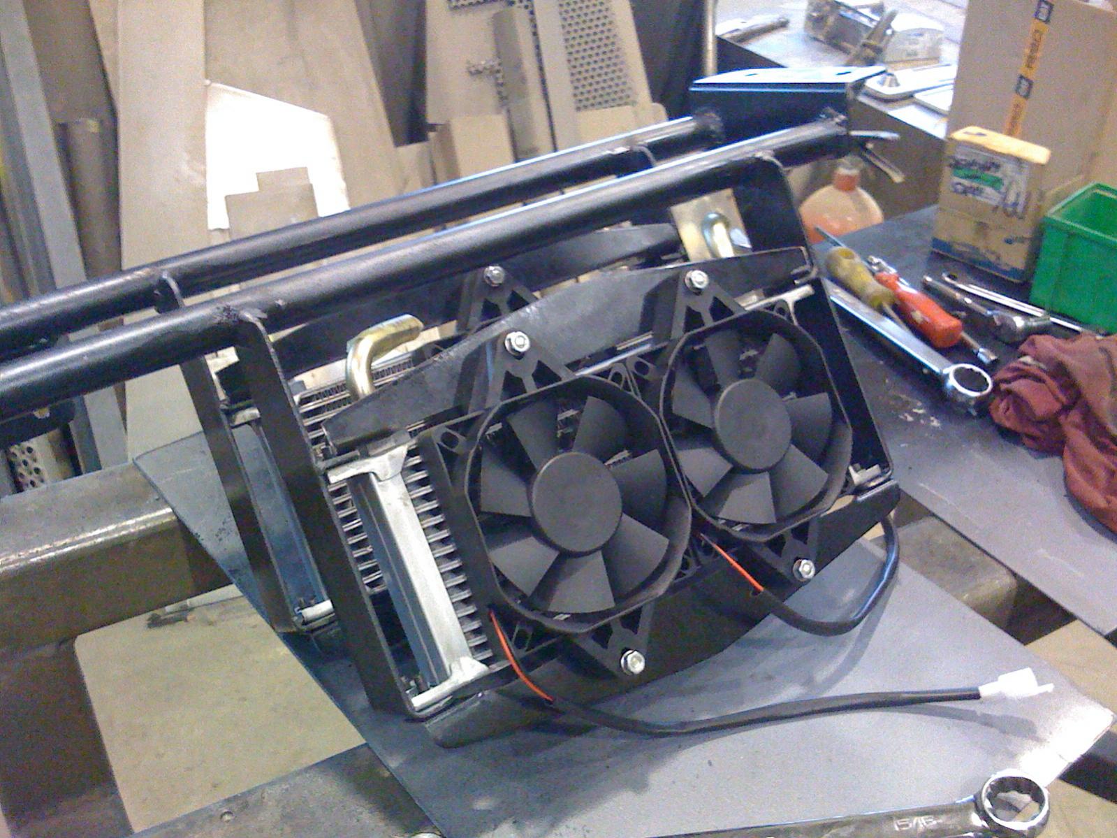

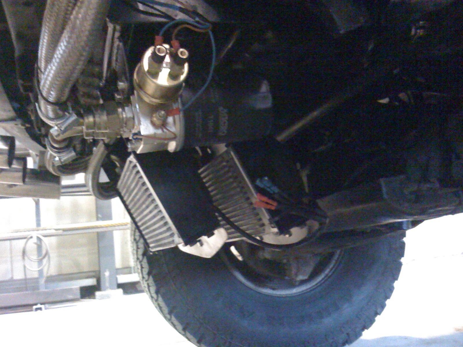

          • #20

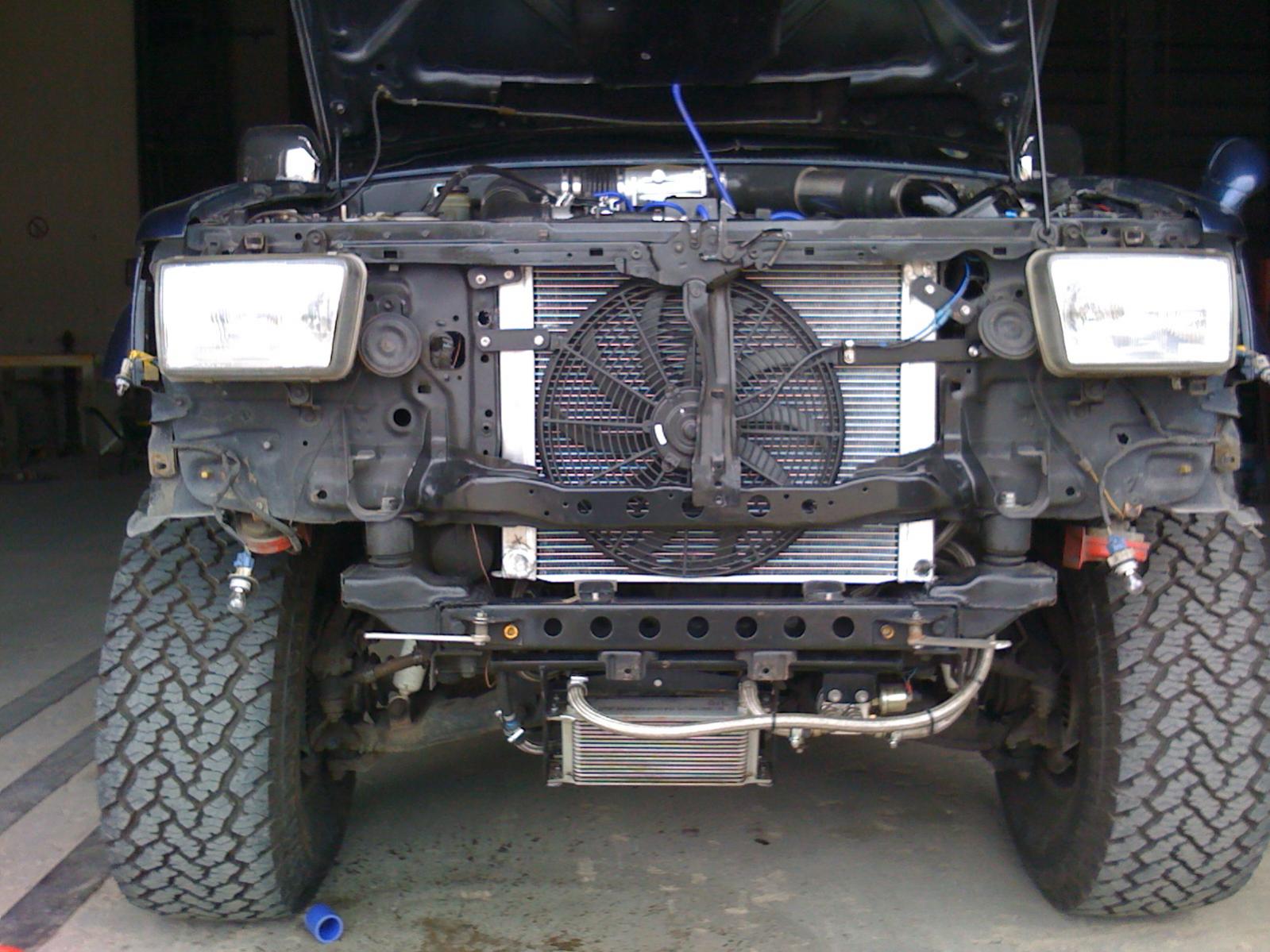

            something like this will cure your problem and you can fit an inline stat for the winter. 16 row coolers with atv fans.
            the radiator only cools the water system and the 2 coolers do atf and engine oil.
            its a 1uzfe and never gets hot even in over 30degree heat.

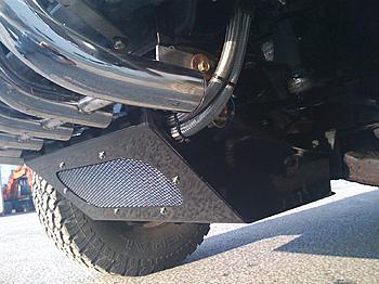

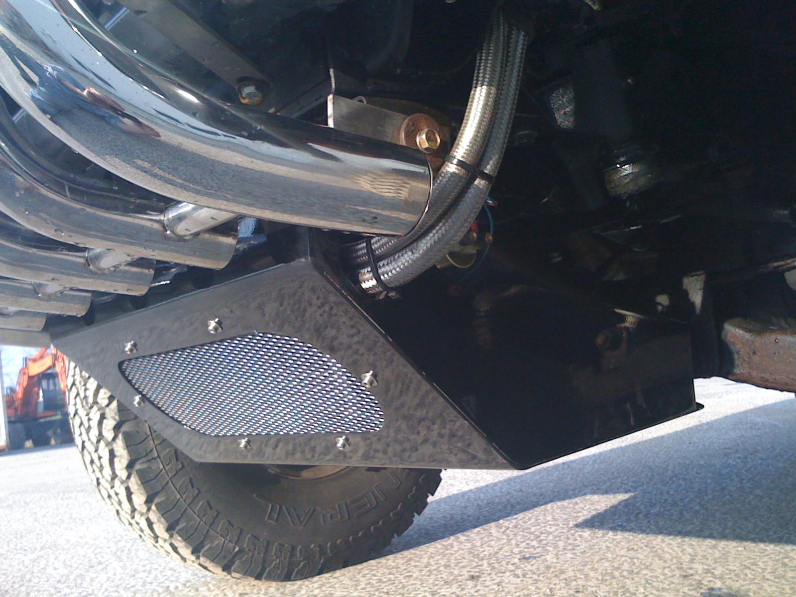

              • #22
                my bash plate is 4mm thick steel plate with reinforcing ribs internally. i can jack the truck on it. its level with the front crossmember but you could gain extra height by sitting the coolers at a steeper angle.
                with the coolers being fan cooled you can mount them anywhere - the fans are mainly used when going slow with no air-flow anyway. anywhere under the body will work with a simple air duct to direct air flow in normal driving.
