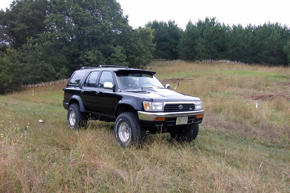

                    Also, it saves cutting any bonnet scoops too, but may be it would be worth cutting one anyway to help with air flow? This leads me onto another idea of what some people do with their bonnets, lift them up at the back or even like this bloke did with his Surf / 4Runner but I've no idea how:
