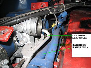

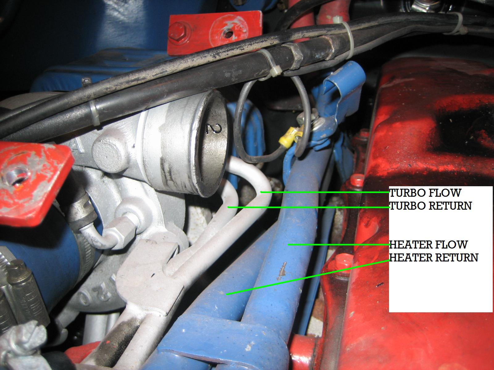

Started removeing stuff this afternoon and it looks like the turbo pipes take one from the flow and one to the return so guessing that with the heater matrix turned off the turbo will still get a flow, so with that in mind i'm thinking all i'll be doing is (hopefully) incraseing the flow rate
(the turbo take-off's are on the heater metal tubes near the front of the engine)Too young to die and too old to give a toss

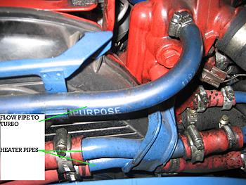

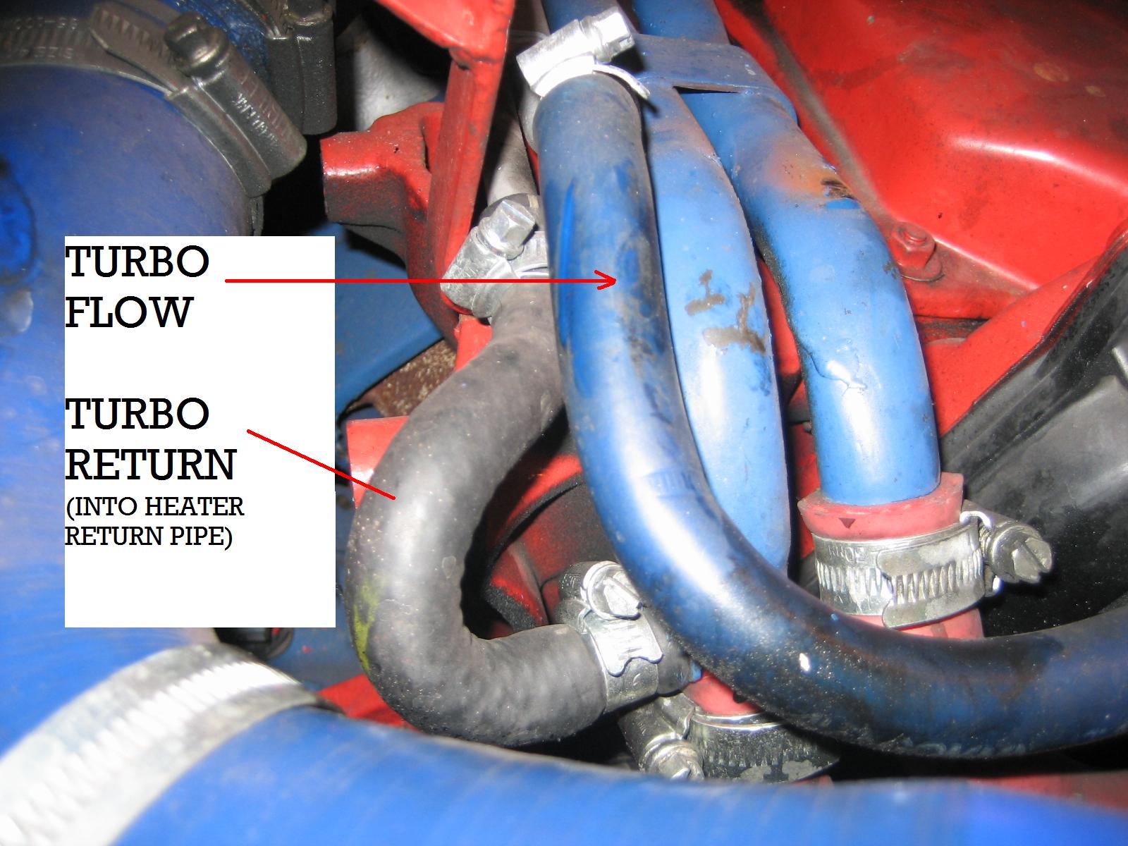

Turbo is fed directly from engine, at the thermostat housing, before the thermostat. The hose goes across front of engine attached to timing cover with a bracket. Return is back to engine via the heater return hose via a little T section in the metal pipe between air con and engine.
The thing to look at, is to make sure a pump, setup inline from the heater hoses, will not create any back pressure to the turbo return line and restrict the flow. Have to study the setup suggested, as I am not sure if this can happen.
Installing a pump inline on the heater hoses may (i do say may because I am not sure) increase pressure in the heater hose line which could possibly create back pressure to the much smaller turbo return hose.

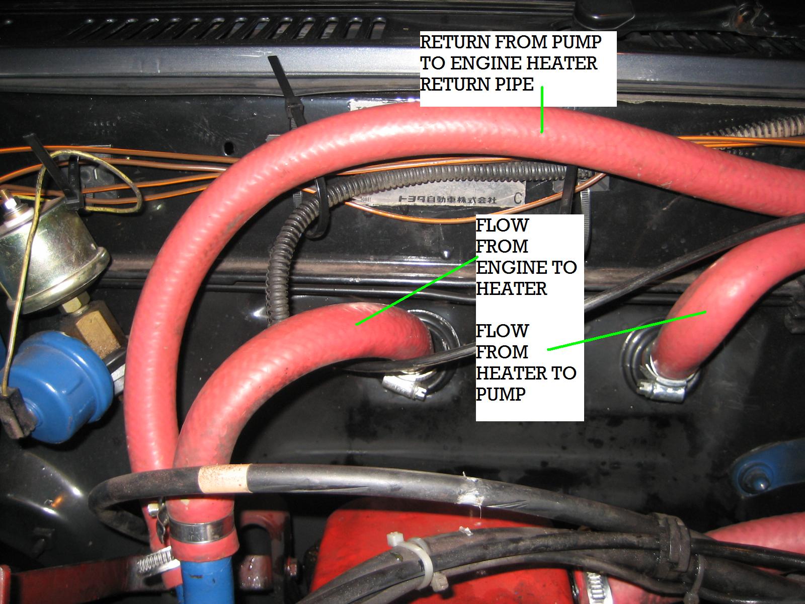

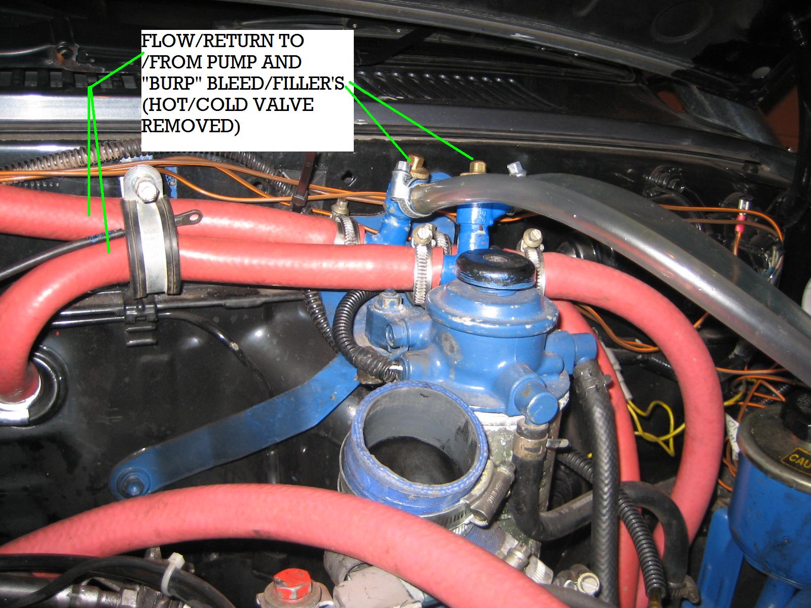

Cheer's Nev, i'm gonna get a good day on it today so will see, like i said the pump was fitted for 2-3 years and running all the time the engine was running, and no probs, but it was just teed into the flow hose, i'll get some pic'sToo young to die and too old to give a toss
some pics of the flows and what i did, ended up removeing the hot/cold valve, just need to refil tomorrow, intercooler removed and two brackets found broken, made up some new ones and all refitted, there dosen't appear to be owt obstructing the throttle, cable looks good and the intake flap returns fine, plenty of "spring" going to check the cab end of it,Too young to die and too old to give a toss
