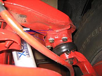

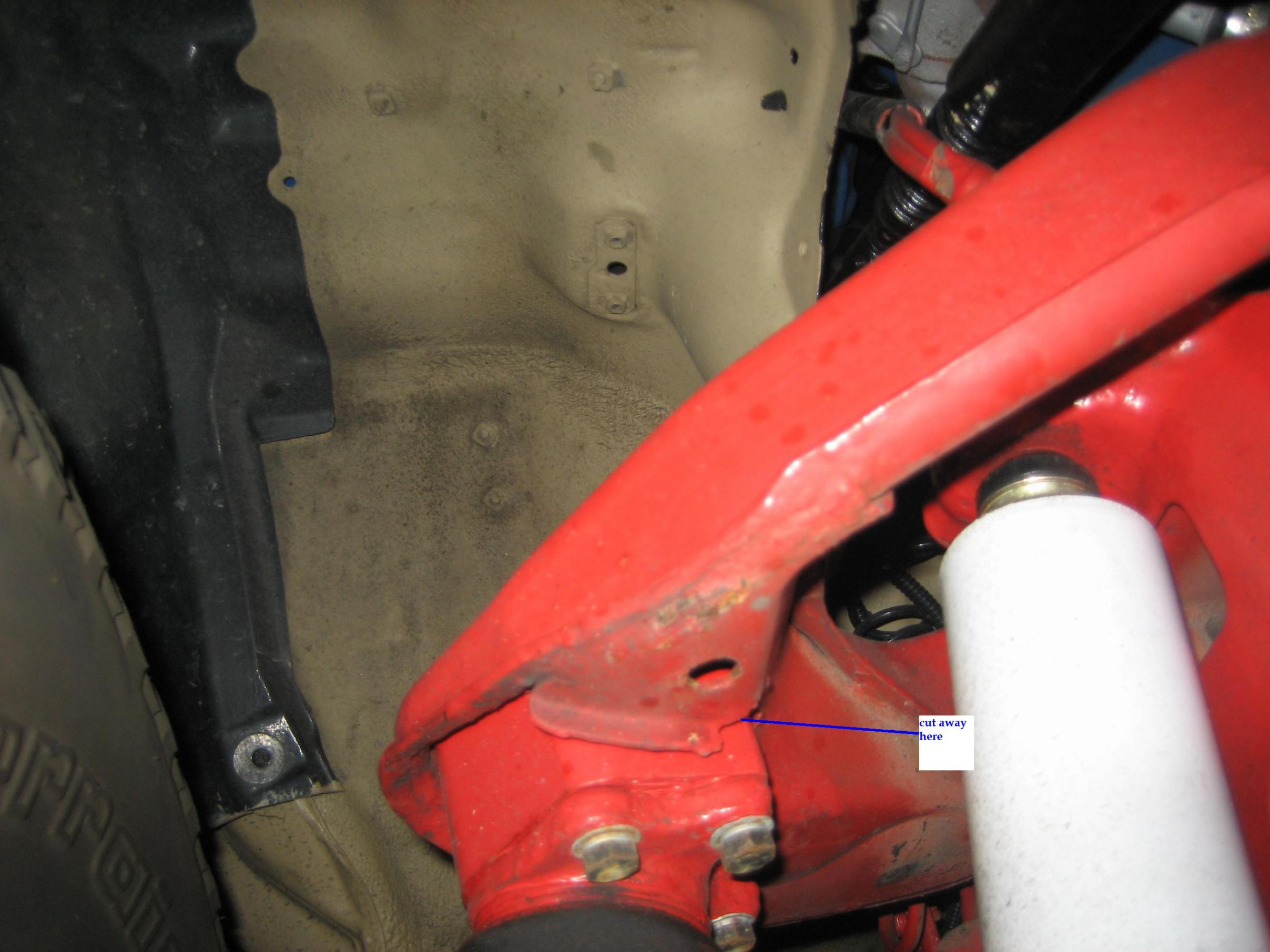

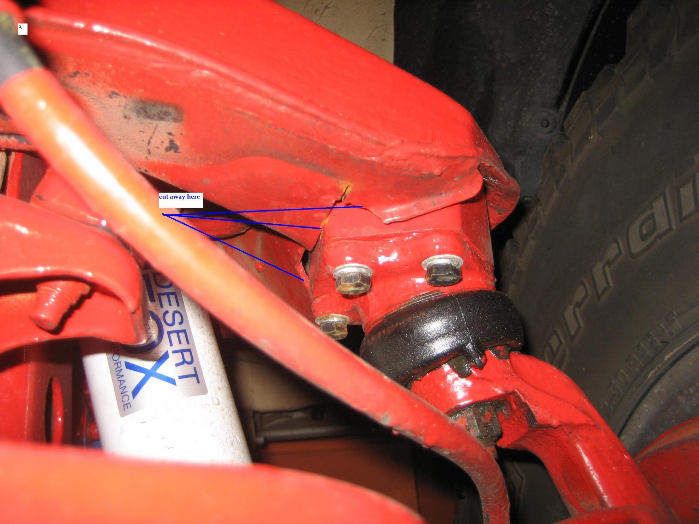

    Got out grinder to cut grind/cut of the bit of the wishbone that interferes with the spacers, and panicked (spelling) a bit and decided not to grind anything
    I have to grind off some of the rolled lip on the underside of the upper wishbone - correct?
    Looking at the lip in relation to the BJ bolt hole - I'm thinking I will have to grind off somewhere between 5-10mm - Is that right?
    Yes you do need to grind off about 10mm, (maybe a bit more) just enough for the spacers to sit correctly (flush with the upper part of the wishbone) it is a bit arse clenching but it's ok,

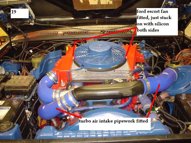

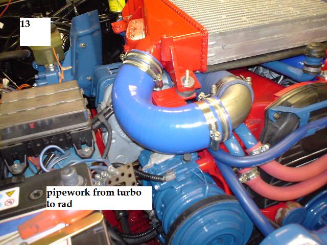

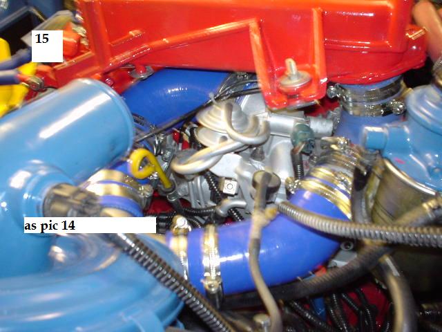

      Thanks Popeye that's exactly what I wanted to hear - by the way what Intercooler did you use in your 2.4? any chance of some pictures of it fitted so I can see how you've done your pipework?

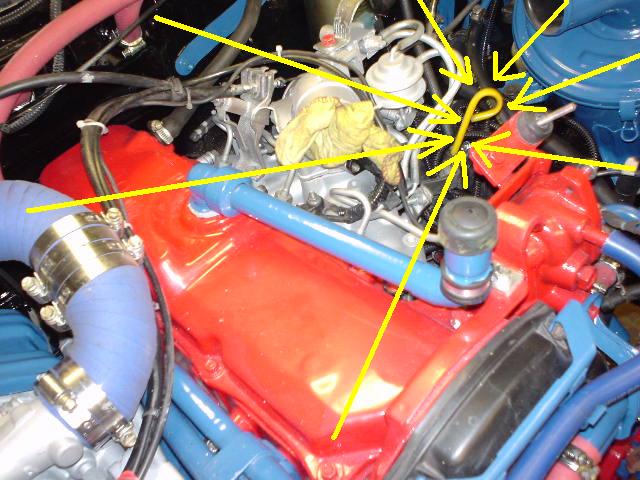

        I was told it's from a mitzi L200, bl00dy big thing tho, pipework was a pain and expensive, dont know if these pic's help, i had to use loads of bends and reducers etc to get the connections, impossible without the 2" body lift, the fan's from an escort rs2000 or whatever they are called,
        Ment to add- the second pic i still have the air-con pump on there, i needed to remove it to connect up the air pipe from the filter to the turbo, no big deal as i'd already removed the fans etc, i was gonna use the pump as a compressor (air) but ended up with the comp from mark (stien)

            Popeye, do you have to remove your Intercooler to topup your engine oil?
              No, i did have to make up a sort of tube and cap fitted in the filler cap hole tho, it make filling slower but easier than removeing the cooler,
              and the dip stick a bit of a bugger to, had to alter the angle

                  I clenched my buttocks and went for it with the grinder!
                  I now have BJ spacers on the front - I also fitted freewheeling hubs
                  I still need to refit my front ARB but I need to fabricate some 1" ARB spacers first - and I still need to drop the diff 'cos the CV angles are a bit extreme!
