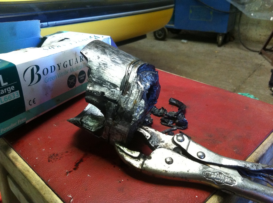

eek.... (55reg Land Cruiser Colorado D4D 3.0)
Thats fawked then!!
Wouldn't be SO bad, but engine was rebuilt just before xmas, after running out of oil, spinning a bearing and ruining the crank. Cost owner about £4k!
Someone is going to be out of pocket!!
(not me I might add )

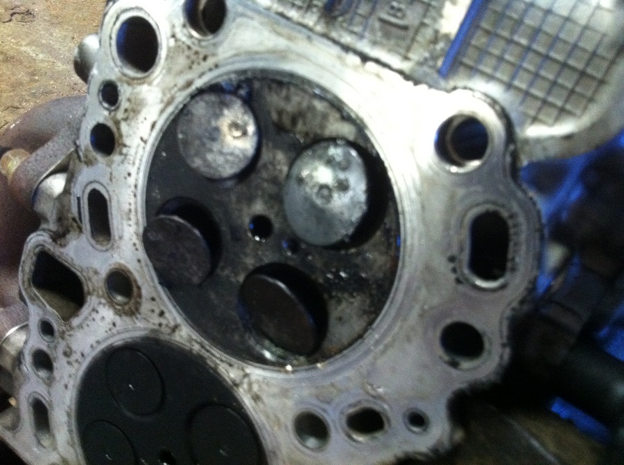

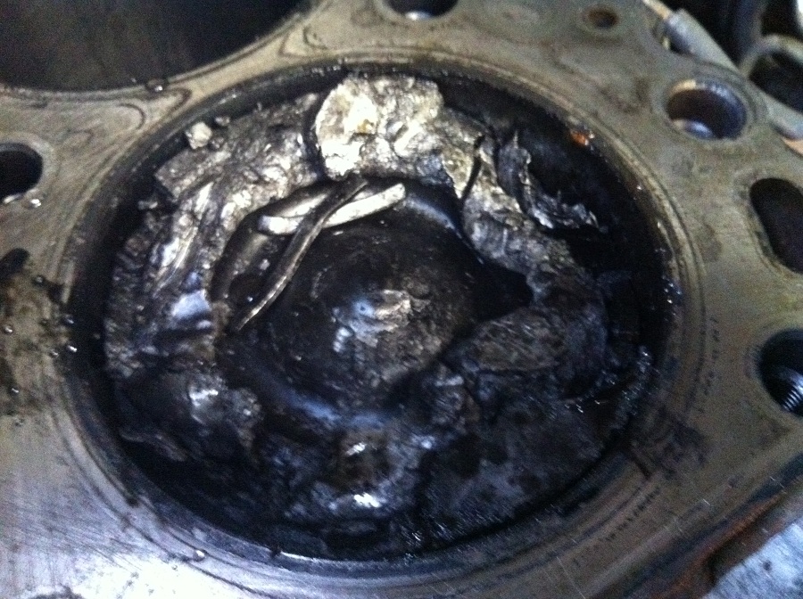

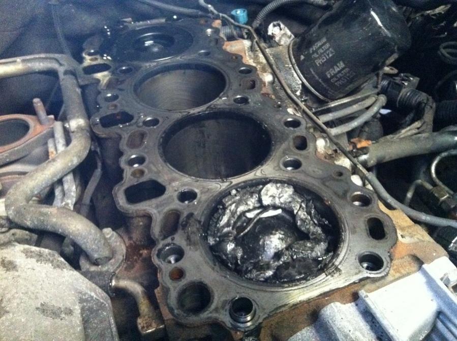

The piston looks like it jammed in bore, whether due to the top melting or being too tight, but the scoring on the bore and piston is horrible, then the wrist pin broke out the bottom of the piston, then on the next rev punched the piston up into the valves where it got stuck
It also had a sump full of coolant.
Not really sure what happened, but they arn't getting it fixed by easter as requested!4x4toys.co.uk - Keeping you on and off the road...
Originally posted by gwh200 View PostOoh...that's a bit broked. I can't see to clearly Tony, is the block recoverable ?
Its hard to not think someone fawked up, as it was stripped and rebuilt just before xmas.
Can't say to much, the garage that fixed it are my workshop 'landlords', I rent one end of their premises, and looking at this truck as a favour as they where to busy to look at it straight away.
I'm a little worried where all the coolant in the sump came from, I don't know much about the D4D motors yet, there is what looks like an emissions air pump above the A/C pump, that is full of coolant, I hope someone didn't connect it up the cooling system and fill the bores with water! But then again it may be an extra coolant pump for some reason. But all the hoses and lots of stuff was stripped off it when I started work on it.4x4toys.co.uk - Keeping you on and off the road...
