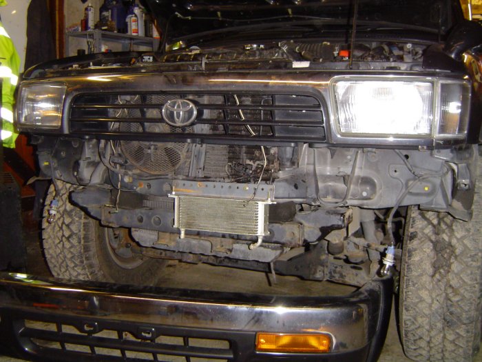

Posted this picture last night...
Alamo asked
(1) Aren't these coolers designed to be fed from the top?
(2) A bit hard to tell from the pic, but the cooler looks to be slightly higher than the transmission. If so, wouldn't that cause the ATF to pewk out of the dipstick tube before you've got enough in there to reach the cooler?
Now i am questioning my positioning..... anyone know if he might be right and i am going to end up having to rethink my installation ????
