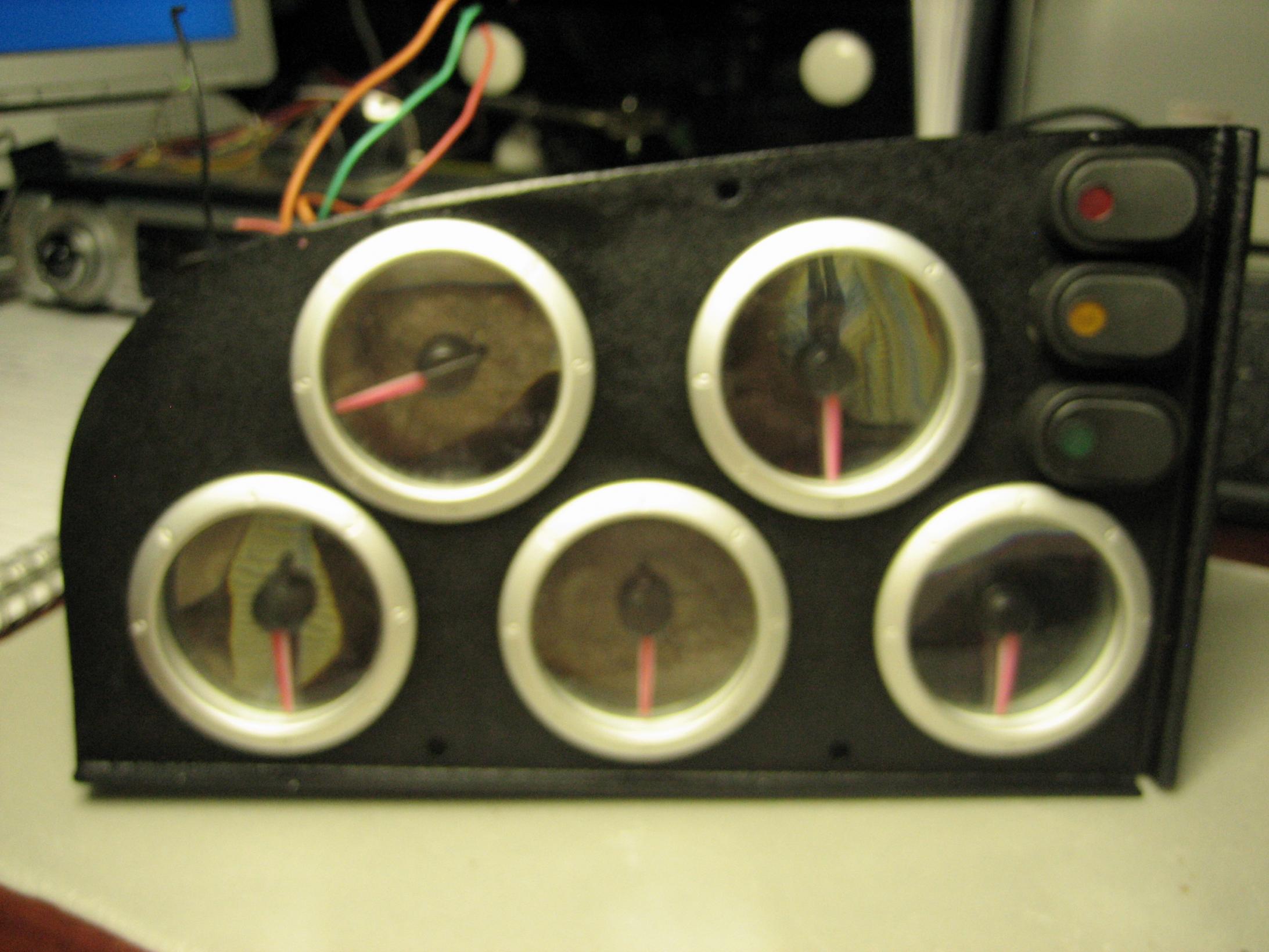

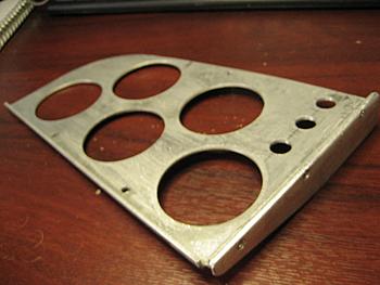

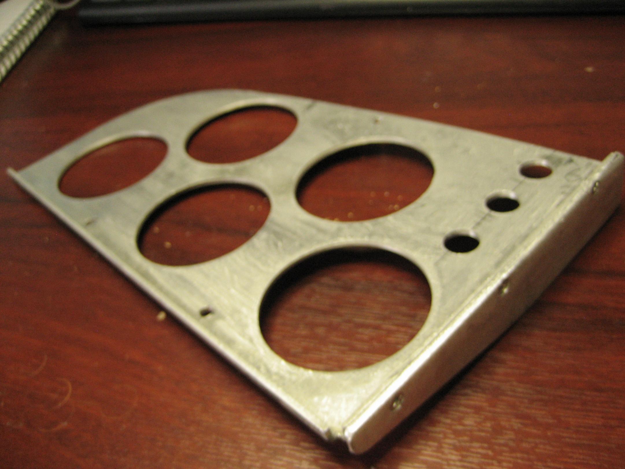

Made this thickish alloy plate up to take the five gauges i removed, just thought it'd look better with em all in one place, also cut the number of switches down from seven to three, one controlls all spotlights, one for the fogs and one for the spot angel eyes and roof bar markers,
i was gonna cover it in leather cloth but as it a tight fit and i've had to hack the dash about a bit to get it in i sprayed it with "suade" finish plastikote and then with satin black, also done some hacking in order to bring the heater controlls forward a bit, as it used to be i couldn't see the button in use light, got me some wiring to do now

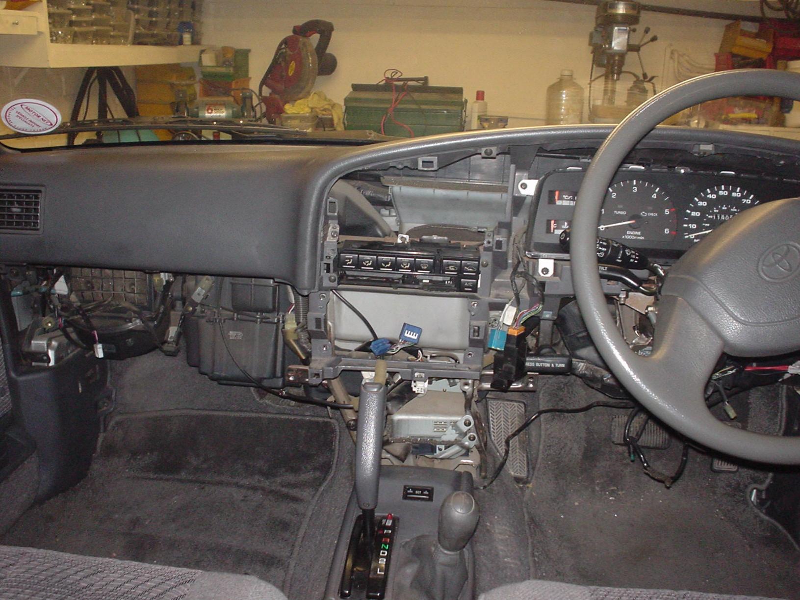

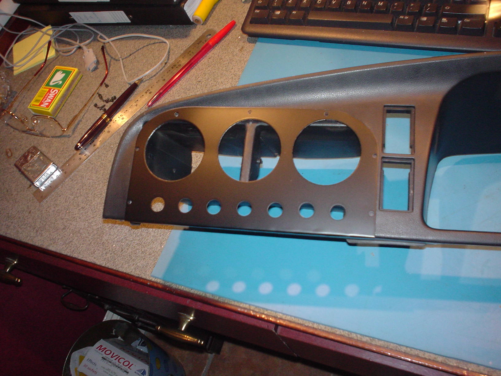

yes it going where the center vent and cup holder went, years ago i did away with em and fitted 3 gauges and a row of switches there, as i'm sort of re-modeling i decieded to fit em all together, i'll add a pic when their all up and running,
