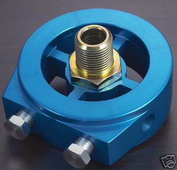

    Where does one usually fit an oil pressure sender unit.
    Not on a Smurf particularly, just in general
    私のホバークラフト は鰻が一杯です。
    On the filter housing or fit a sandwich plate.
      Is there an existing threaded hole on the housing usually ?

        Depends on the vehicle, but you could remove the oil light sender and fit a pressure sender in it's place.( with it's own wire to the gauge obviously.)
          Yea, that's a good idea.
          Thanks for the info.
                    If you use a t piece you could have both sender and light
                    bare in mind though they are usually tapered threads
                      Yep, 1/8 NPT. Toyota use 10mm most of the time though.
                        I should imagine Suzuki do too, ????
