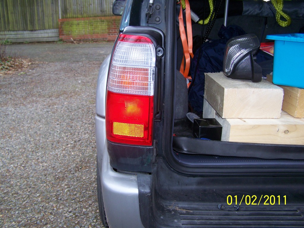

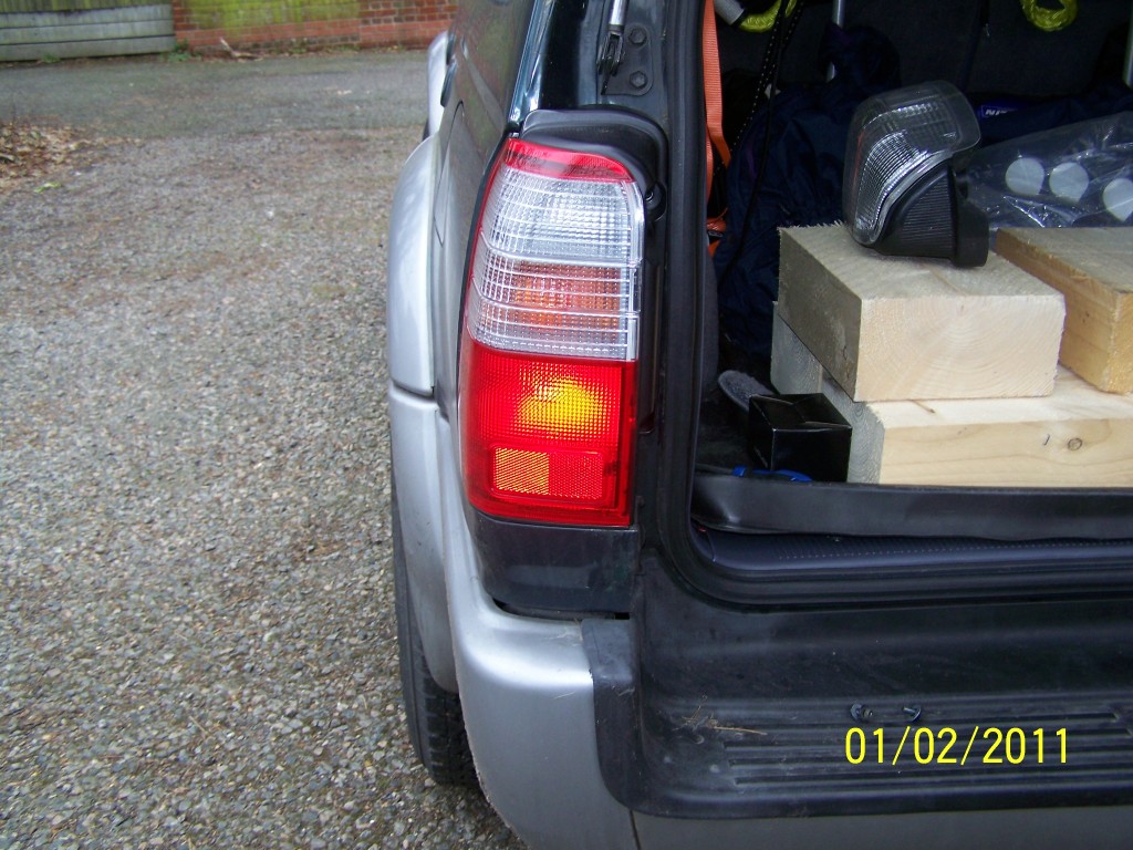

                        Thanks for the link. The white LED lamp / bulb you have in one of the photos is this the reversing light or is that the brake light? The ones I bought are red LED and is going behind the red cluster lens for the brake light. I think this should be okay though.
                        Oh Nana, what's my name?
                          The first pic is with red leds in and the second is with a conventional bulb, the camera pics up a slight improvment with the leds but in all honesty it's not a huge difference to look at, at night however this may be a whole different kettle of fish and I suspect it will be quite a difference.
                          Might even leave these clusters in for a while as I like to change them over once in a while, keeps the nosy neighbours on their toes.
                          Neal
