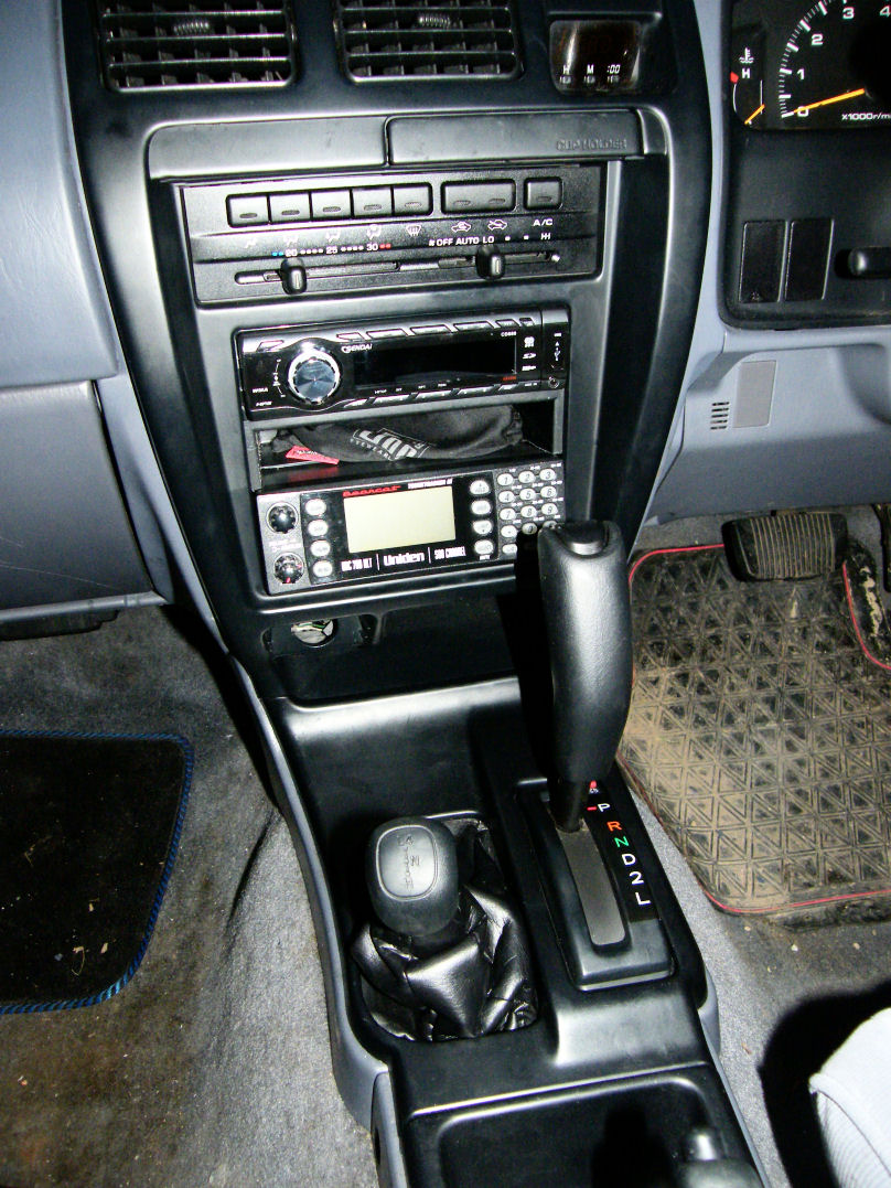

Bit of a job, as the scanner is taller and deeper than ISO. I had to relocate the airbag ECU and remove a plastic brace behind the console, but now all done. Had to cut down the wee plastic pocket a bit too, but my shades still fit in there. While I had all the mouldings out, I did a 'shiney' and polished everything up with black polish, including the gaiter with shoe polish
Also repaired the rear tailgate. Bit of a swine to get into! Ended up fishing down past the glass to open the lock, which had jammed when the barrel fell inside. Had to take off the number plate surround to reattach the lock barrel. Its only attached via two self-tappers into plastic! Crap design that, Mr Toyota. So I screwed it back on then reinforced it with hot melt glue. All working again!
Just need to source and fit a decent antenna for the scanner, and fit the 12V socket where the manky fag lighter was.
