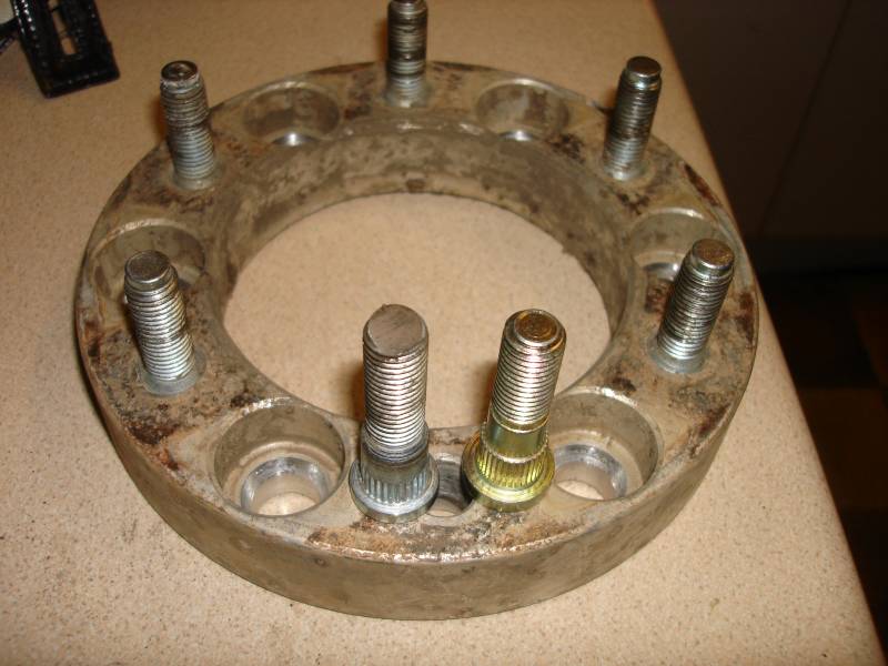

        I have just received a Mitsi L200 rear stud to replace the one in my 30mm spacers. Only needs a tiny bit of work to make fit. (one stud stripped the hole it was pressed into)
