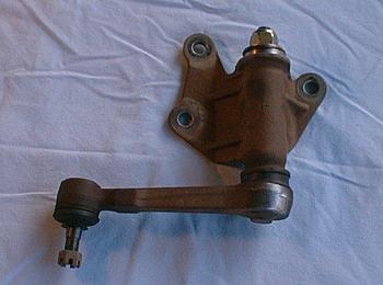

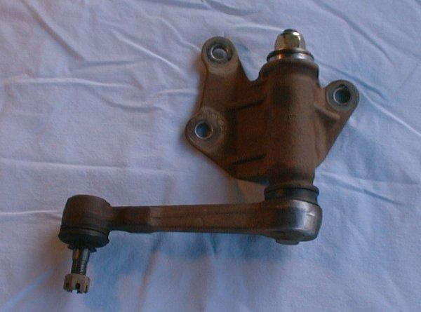

            some pics to give you an idea what to look for steering idler arm bushes are a favourite to check first also the ball joint on the arm
              One side has been replaced with new ,will check the other
